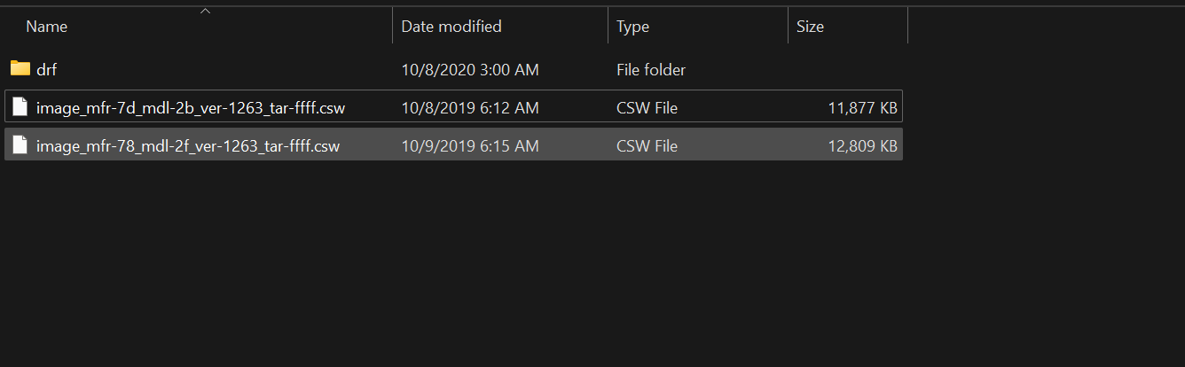

Original FW File pulled from a Samsung HR54-200
csw - 14.50 MB - 10/04/2024 at 02:57

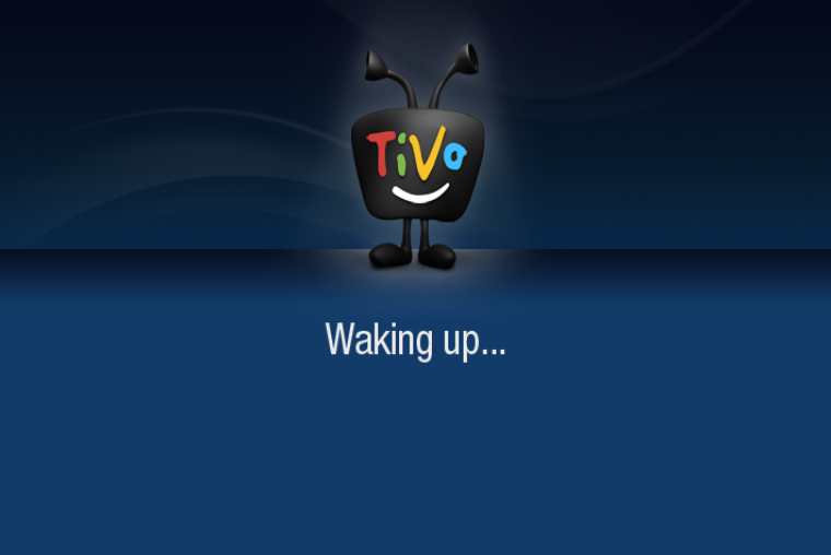

    Hi all, exciting news! After more research, digging, and tinkering, it’s become clear to me that these DVRs and receivers can run just about any OS you throw at them—well, sort of.
    For example, We recently got our hands on a Scientific Atlanta box running a TiVo‑skinned OS. I hooked it up to a Suddenlink cable CMTS and managed to get it running in Cisco’s SARAH environment. Before that, of course, we scanned the drive to see what we could uncover. Unfortunately, our host machines didn’t play nicely with the drive and kept crashing whenever the TiVo data from that Scientific Atlanta box was accessed.
    This was all done in coordination with my good friend Mixer, whom I’ve known for a couple of years. Together we’ve tackled many interesting projects—switching between our emulation project (currently shelved due to technical constraints that require further research to make it work as a JIT compiler) and reverse‑engineering ISP cable systems on the firmware side, using publicly available resources.
    Along the way, we’ve come across boxes running Flash Player, Opera browser, and other unexpected software. All very fascinating details! I can’t share too much just yet—I have to keep you on your toes—but I promise there’s more to come.
    As a teaser… here’s an image.

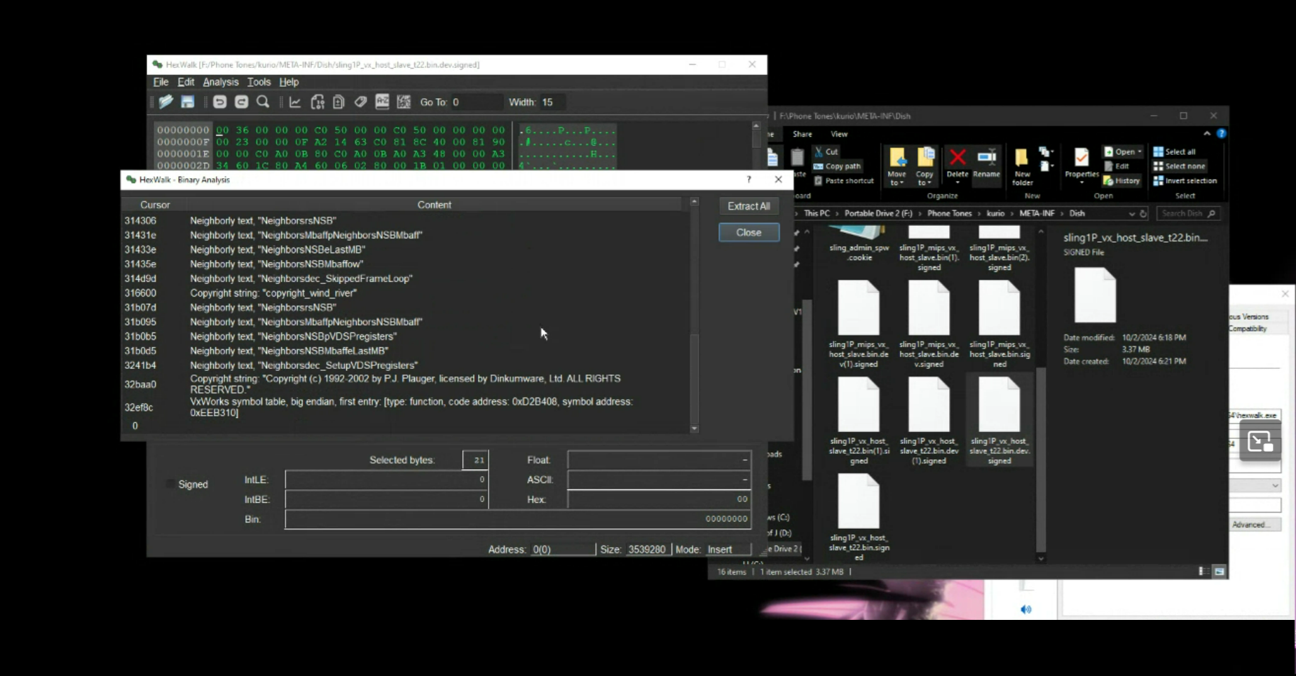

    1. We got the Menus from the firmware and the whole implementation is quite weird. They use .mpg for the menu and guide, and panel components.
    2. We have the firmware images
    3. The Viewer folder is a very Large folder as it houses the segments folder. The segments folder houses what i believe to be all the recordings for the DVR.
    now, all this is hosted on a single 15GB partition on the drive. But yet that segments folder amounts to 695 GB,
    4. We have the bong sound , yes. The directv "no" bong sound.

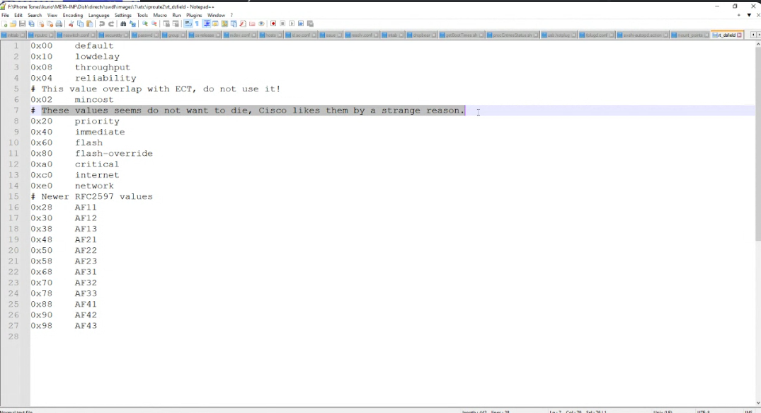

    5. the swdl folder contains our firmware, in a .CSW file format. You can view the contents by utilizing winrar or 7 zip and using the Open Archive > "# "  flag in the context menu,
    6. In that .csw file the opt and etc folders are full of fun and fascinating goodies, between weird file names, .sh files, .pcm files, and so much more. I wont spoil the fun for you, after all you chose to take the time to join me in this adventure.

    So I have an update.. a rarther interesting one. These boxes are running on Vxworks 5.52 Kernel version 2.11. Vx works is a OS made by wind River systems, and iirc, this was one of a handful of multiple versions that had some major vulns.
    They use PFFS Filesystem on the drives, PFFS is peer fusion file system.

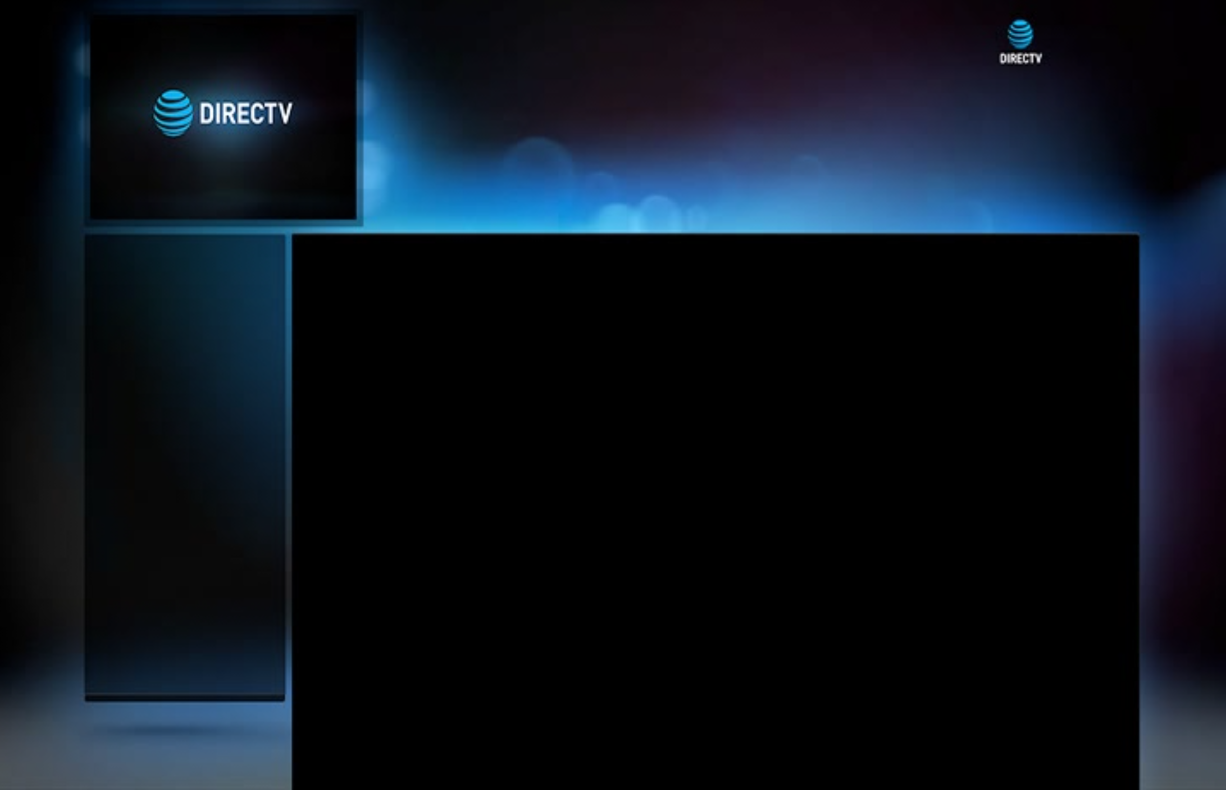

    But digging through both of the DirecTV hard drives i have mounted in windows using some special software, we see this file which is a cipher key if I did my research properly.Ive tried using imHex, notepad++ , and notepad to try and tell me what it might be for, but im not sure. Especially since it was in "shef\archivein ita_data\apps\4176_1
    we find the guide banners for ads

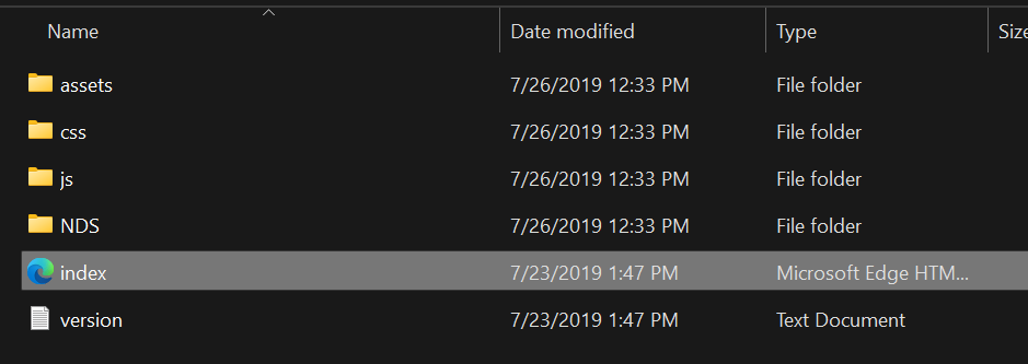

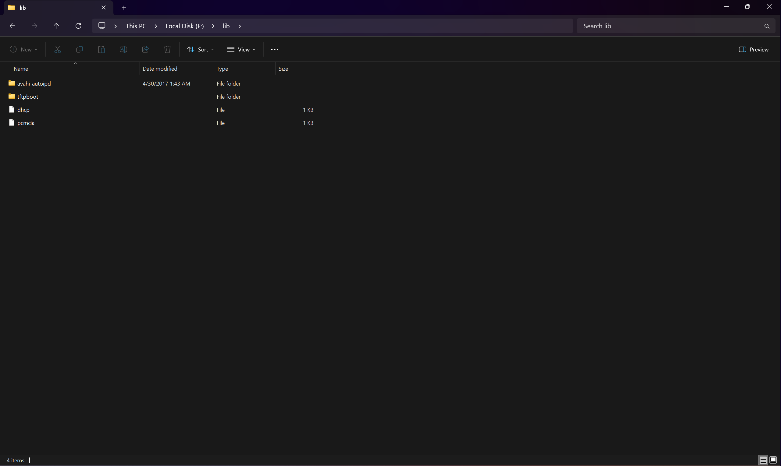

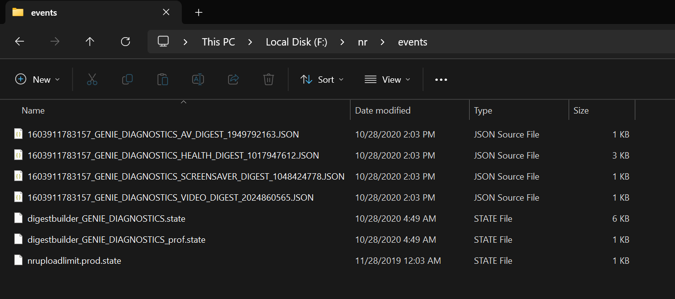

    We believe we have found the firmware. It appears to be cleverly disguised as something else. Bin walk confirms our suspicions. About to load it into a hex editor to see what secrets it holds. This likely is not the full install of the OS, very likely just the basic firmware for the board itself.
    Digging through these folders at the ungodly hour of 1224 AM, we find a interesting folder that holds diagnostic logs, these could be potentially useful, lets make note of the location and continue delving through this drive
    Diagnostic files

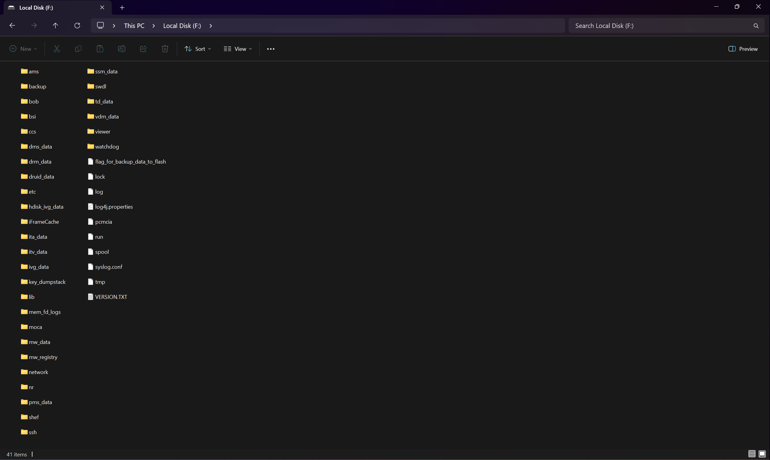

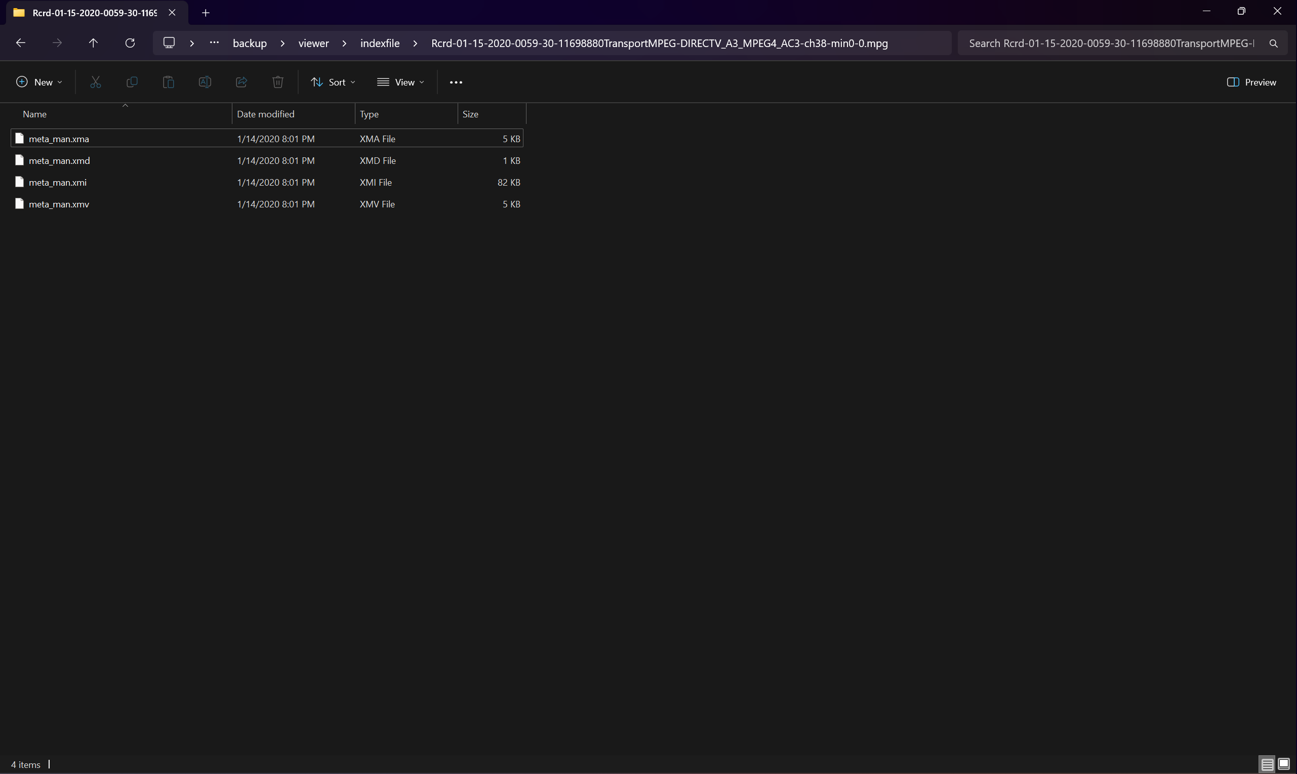

    Woohoo! finally managed to mount the elusive XFS partition on one of the many Directv hard drives I own. We managed to mount the following path :
    Z:\backup\viewer\indexfile\Rcrd-01-15-2020-0059-30-11698880TransportMPEG-DIRECTV_A3_MPEG4_AC3-ch38-min0-0.mpg
    Upon doing some more digging in the drive, we find all sorts of potentially exciting things. however, we havent figured out what that Main filesystem is , or what the very last partition on the disk  file system is.
    There's a couple other folks ive reached out too and they're attempting to restring together the M2TS files from a drive, just for the sheer sake of it. Due to DMCA, we obviously wont post those files, as we again dont want layers coming after us, not that we have anything against lawyers.. The lawyers just deserve to deal with better more exciting things rather than something as petty as copyright issues. patents, DMCA, royalties, is just a bunch of bahumbug .. its pointless.

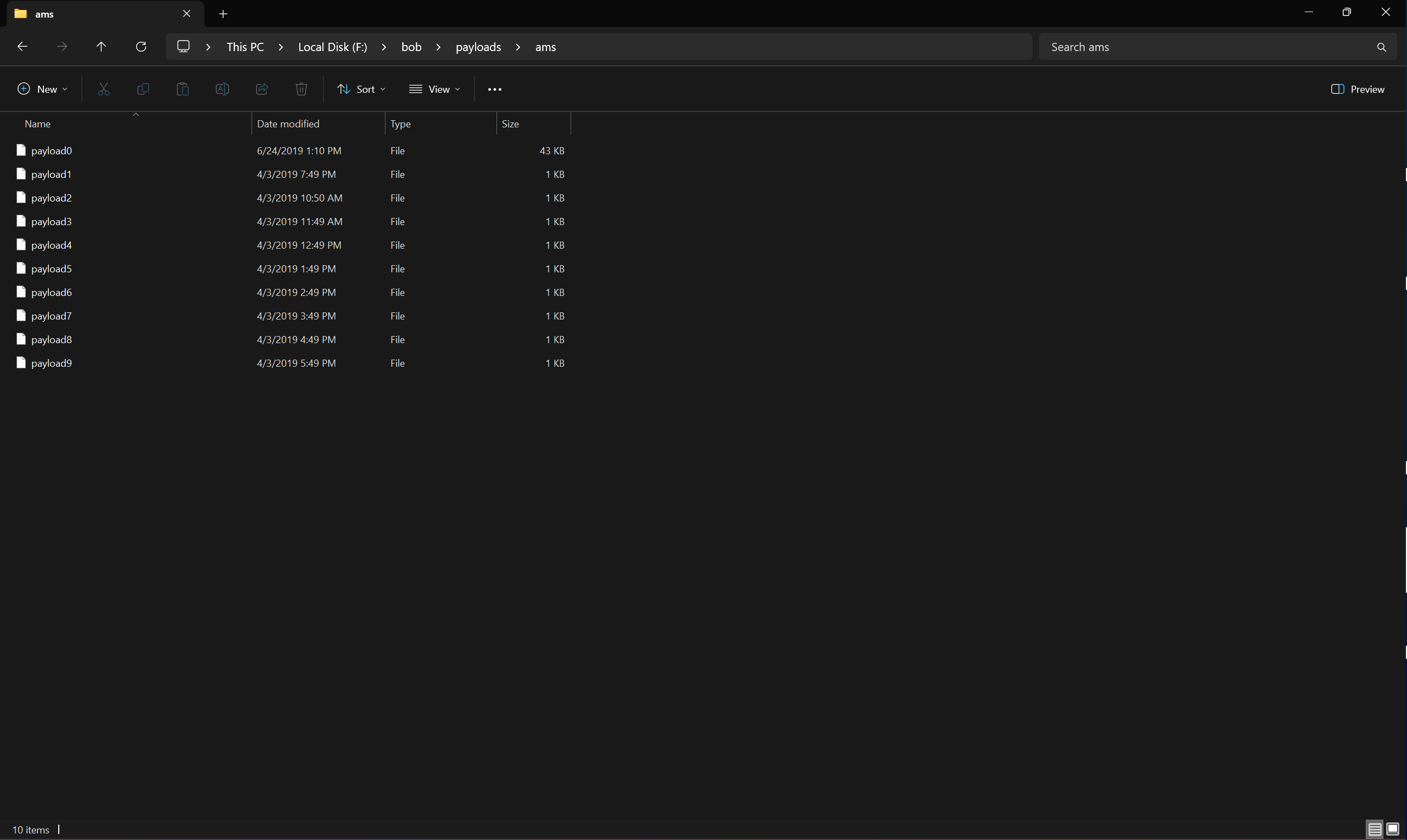

    Digging back through that root directory of the parition we find a folder named bob that has a payload folder in it. No idea what it does, but it has "file" files in it, so it has to be something. Whether or not it is of use to us remains to be seen .
