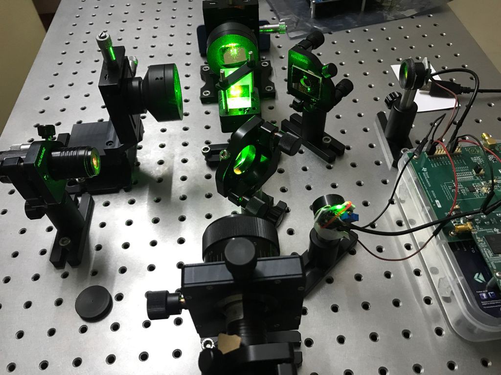

Seeing the distinct interference fringes from the green measurement laser and the red reference laser provides immediate visual proof of the system's ability to monitor both wavelengths simultaneously
Michelson Interferometer with Green Laser
Michelson Interferometer with Red Laser
