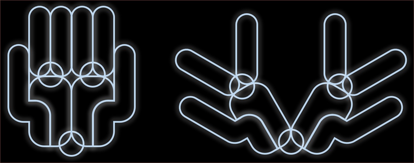

    Thus, I started to focus on hands, most likely because I've already been thinking about the human hand in general due to #Tetizmol [gd0153] and #Tetent [gd0090].
    Coincidentally enough, Boston Dynamics came out with a video on their 3-digit gripper and I agree that you can do a lot with just 3. I also learned from Sunday of the importance of being able to pick up more than one object.
    Because I like symmetry, these are essentially the reason behind 6 digits.
    The next question to solve was how many degrees of freedom do they need to have, and my solution is as follows:
    • As mentioned by Boston Dynamics, the gripper has to be durable and could be fallen upon. I imagine this is why human hands can flatten out - to increase the surface area from impact.
    • There are many grasps that only need 2 fingers and no thumb, thus this concept moves them together/apart opposite but equally.
    • The fingers and thumb have 2 degrees of freedom. For the fingers, it's to be able to do things like type on a keyboard. The thumb has a rotate-out and flex range of motion.
    • The palm splits to give each hand half more space to work in. It's also to allow a single half to more easily fit into places such as a cup.
    The two fingers aren't locked to their same axis. In other words, the design should allow to "cross the fingers":
    All in all, there should be:
    • 12 DOF for the fingers/thumbs
    • 3 DOF for splitting the palm and fingers
    • 2 DOF for the wrist
    Thus 17 DOF total.
    This hand needs to be water washable, be able to feel and have something resembling nails to be able to do things like peel an orange.
