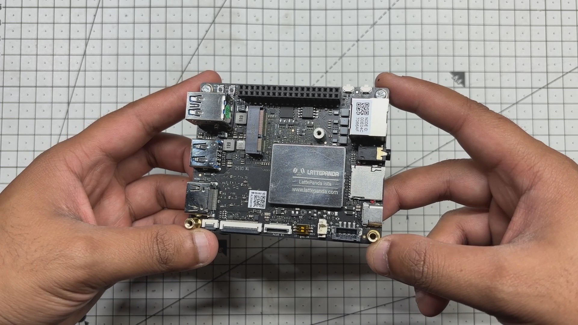

At the heart of this project is the LattePanda IOTA, a compact yet powerful x86 single-board computer designed for edge computing, embedded applications, and serious maker projects. I’m using the 16 GB RAM variant, which provides significantly more headroom than most SBCs of this size.
The LattePanda IOTA shares the same form factor as the original LattePanda V1, but thanks to its newer Intel N150 processor with 4 cores and 4 threads, it can handle much heavier workloads. I even experimented with running Bazzite on it, effectively turning it into a low-power Steam Machine.
We selected the IOTA for this project to build a super-compact mini PC capable of running Windows, making it suitable for general-purpose tasks such as web browsing.

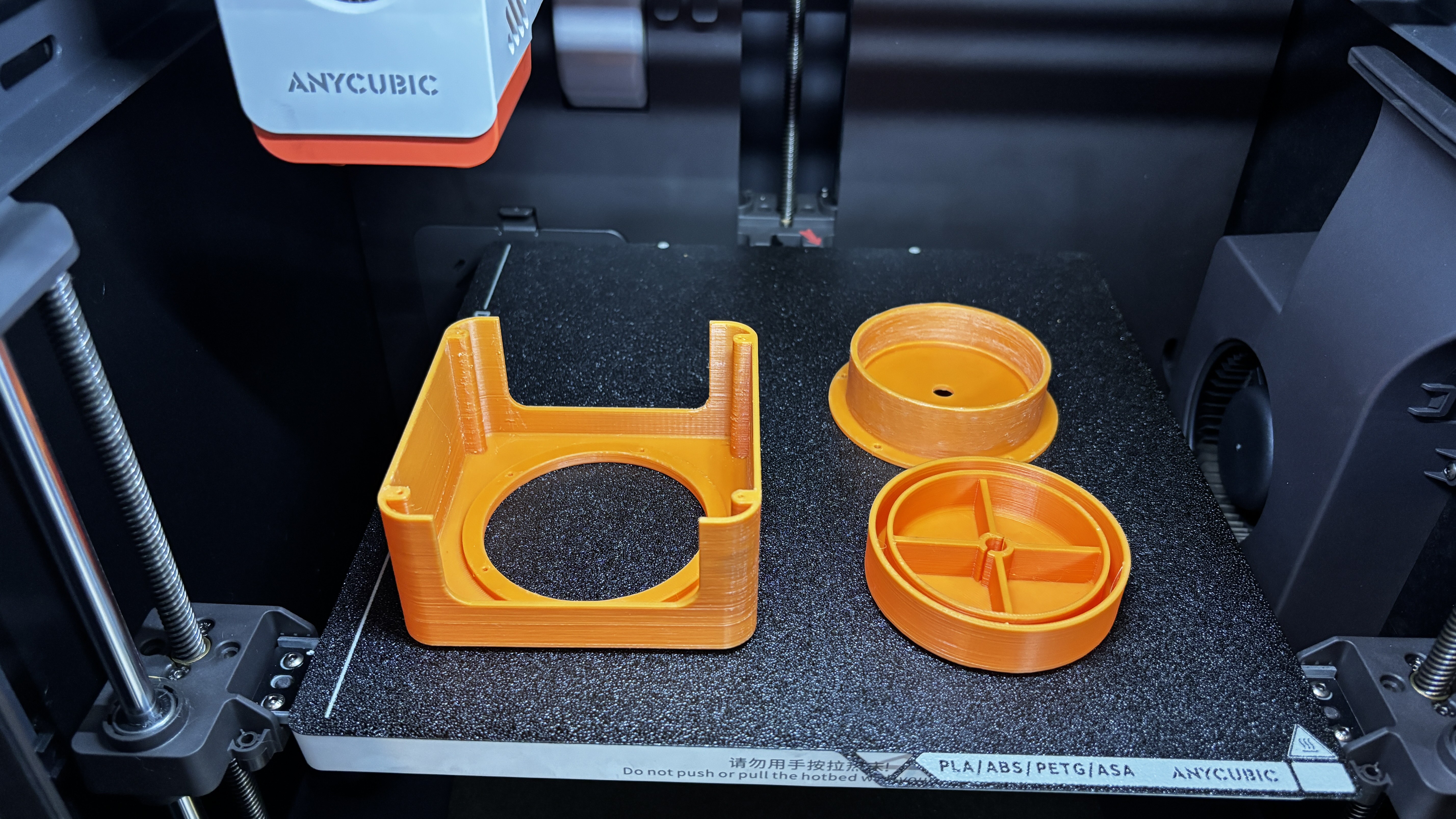

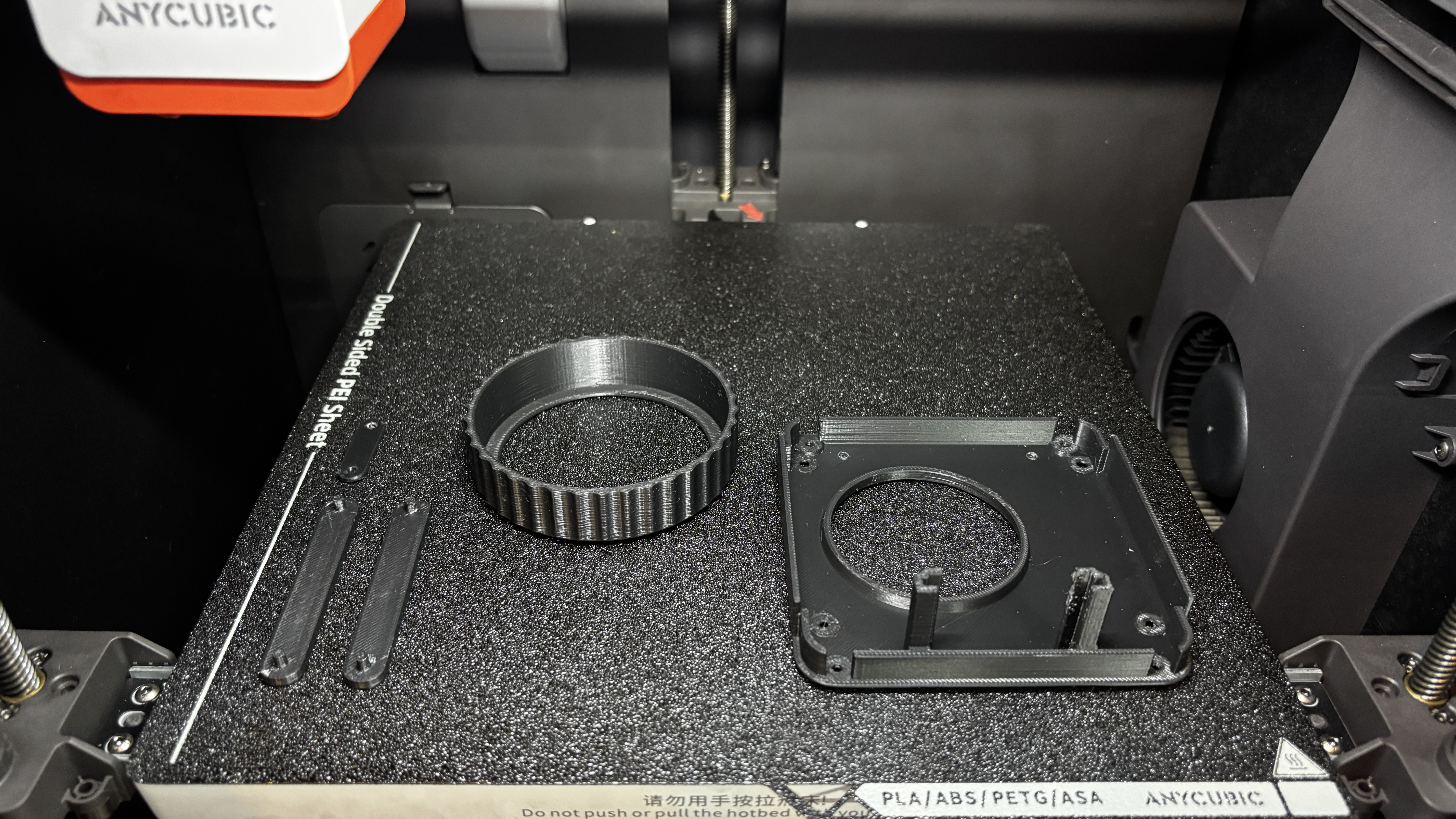

3D PARTS
All parts were exported as mesh files before printing. We first 3D printed the outer part of the knob using black Hyper PLA, along with the base, two base resting parts, and the encoder holder. Orange Hyper PLA was used to print the encoder knob and its fixture, as well as the main body.
All components were printed with a 0.16 mm layer height and 25% infill, using my Anycubic Kobra S1 for printing all the parts.

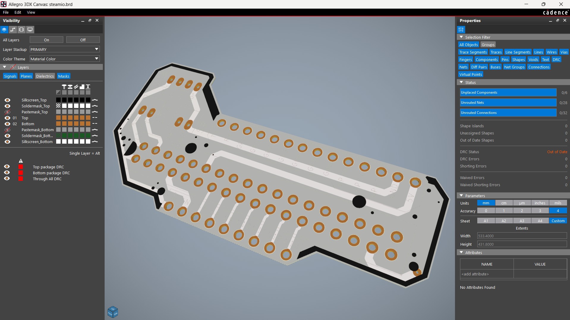

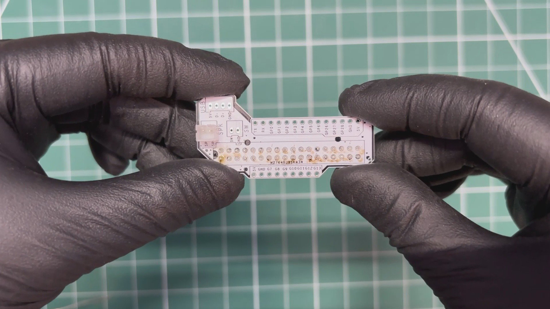

PCB DESIGN

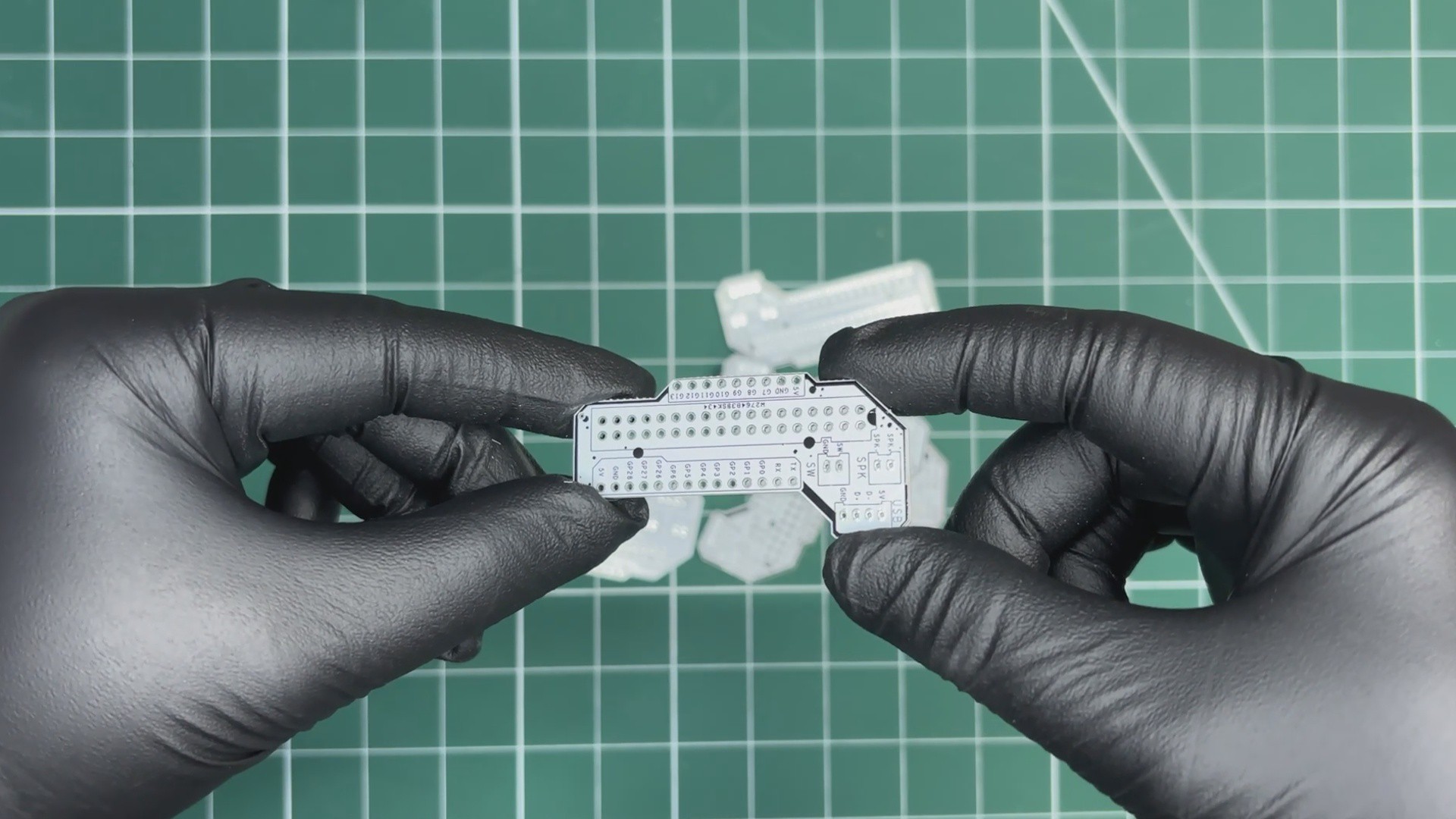

The PCB design for this project was super simple. We just needed a cleaner and more organized way to use the LattePanda’s GPIO pins for connecting the encoder and the speaker output. So the best solution was to design a breakout board that brings out all the I/O pins of the LattePanda.
We made this PCB in a way that it can also be reused in future projects, making it a handy and practical addition beyond this build.
PCBWAY SERVICE
We uploaded the Gerber files to PCBWay’s quote page and placed an order for a white solder mask PCB with black silkscreen.
PCBs were received within a week, and the PCB quality was outstanding. Here, we added a few design elements on the board's silkscreen layer to...

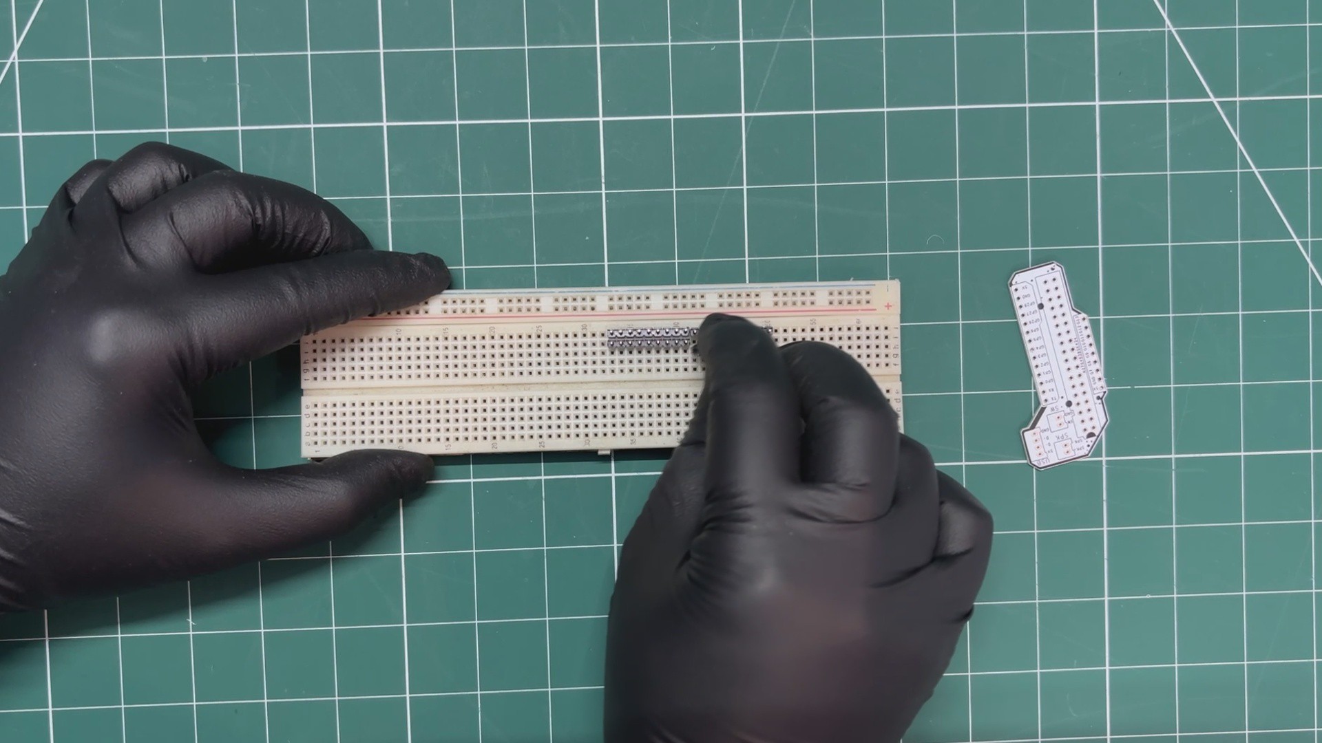

    PCB ASSEMBLY

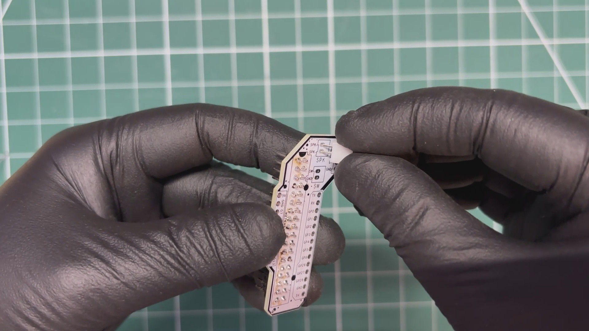

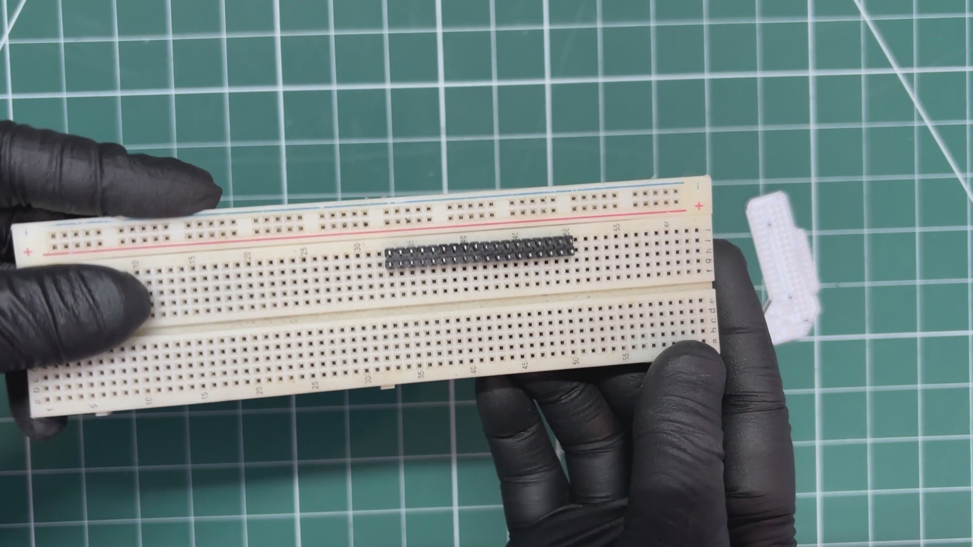

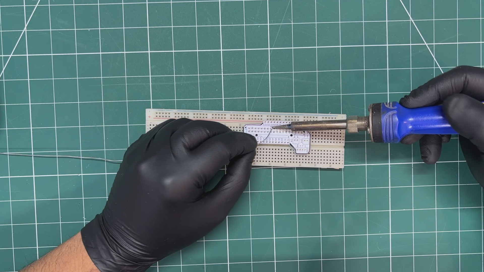

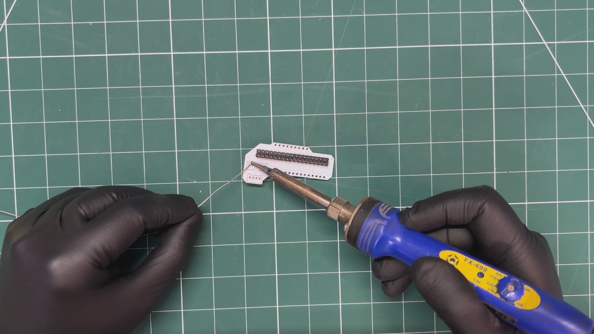

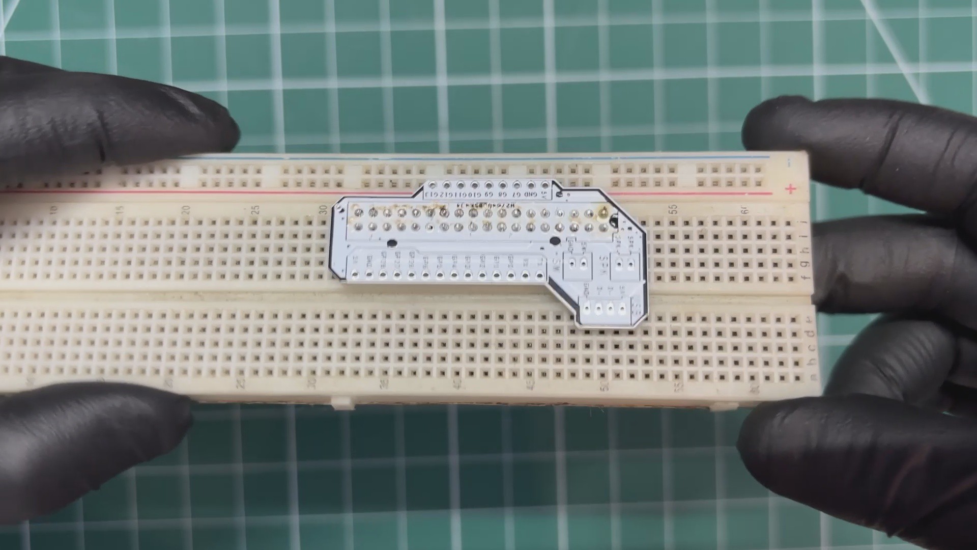

    • We begin the assembly process by placing two CON18 male header pins side by side on a breadboard.
    • The PCB is then placed over the header pins, and the connections are secured by soldering the leads using a soldering iron. This is a clever and reliable method for soldering breakout boards or modules, as the breadboard helps keep the header pins perfectly straight while soldering.
    • Next, we place a CON2 connector onto the speaker pads on the breakout board.
    • After flipping the board over, we solder the connector in place.

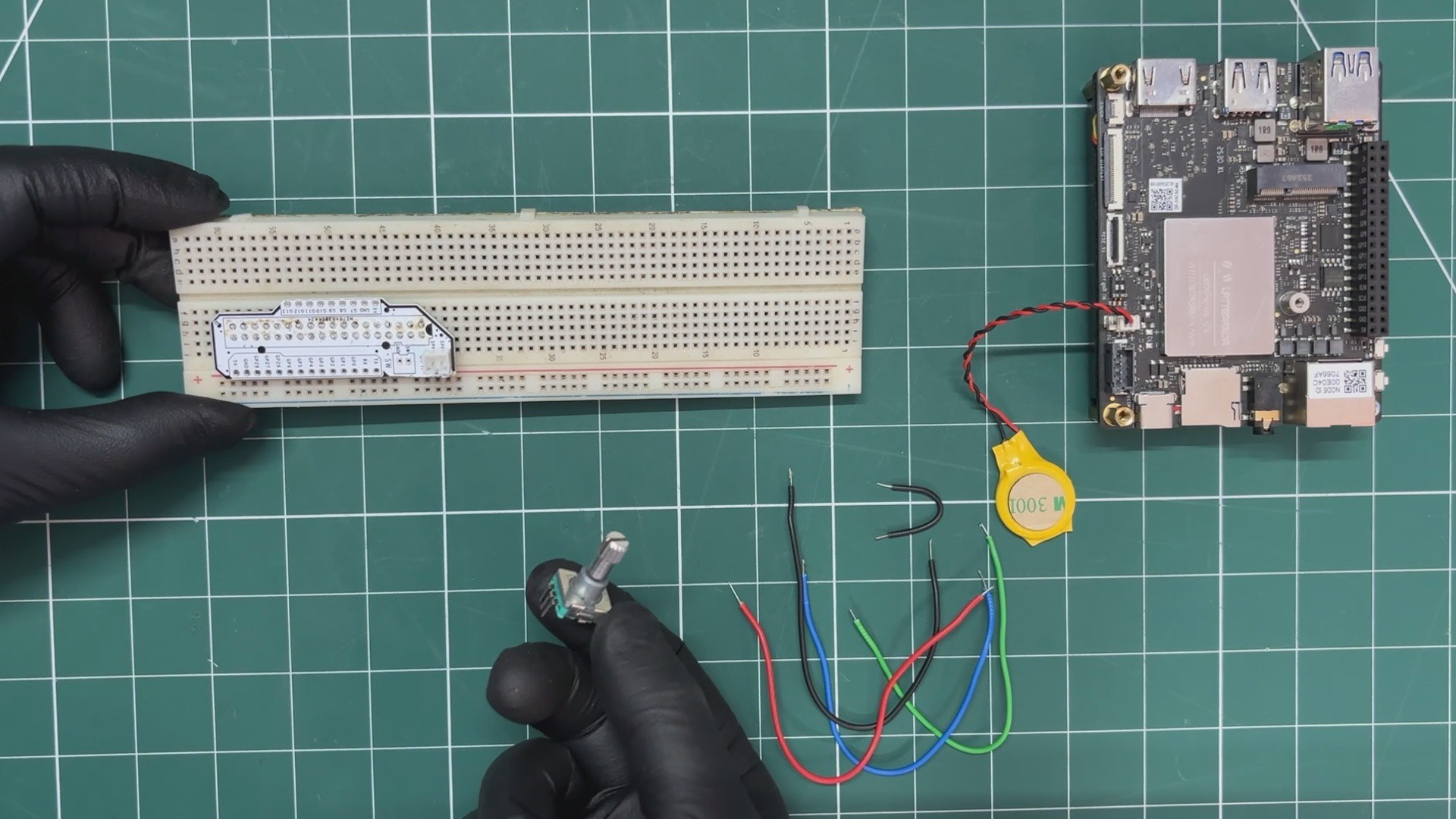

    ENCODER WIRING

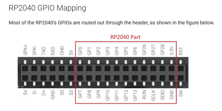

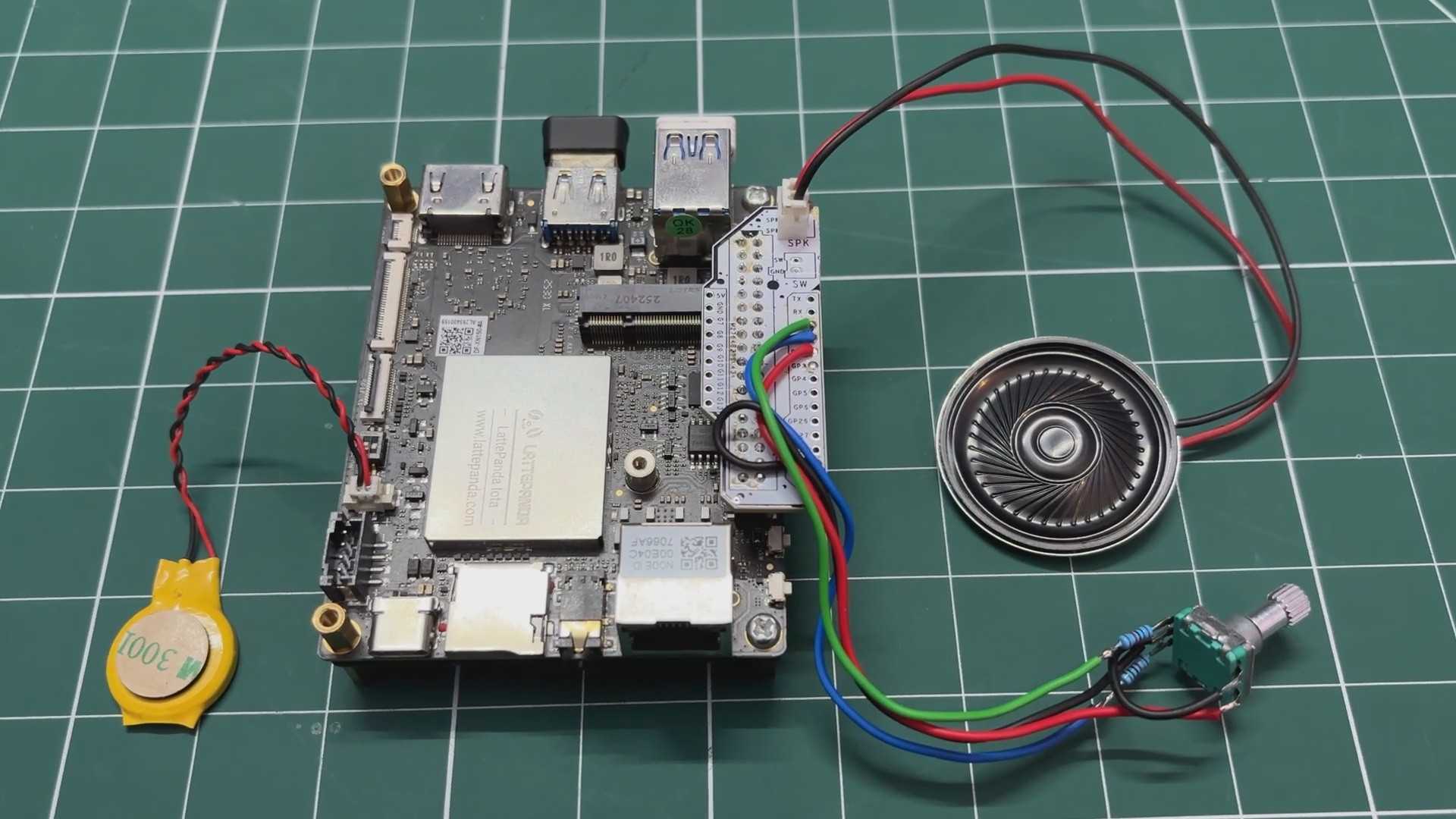

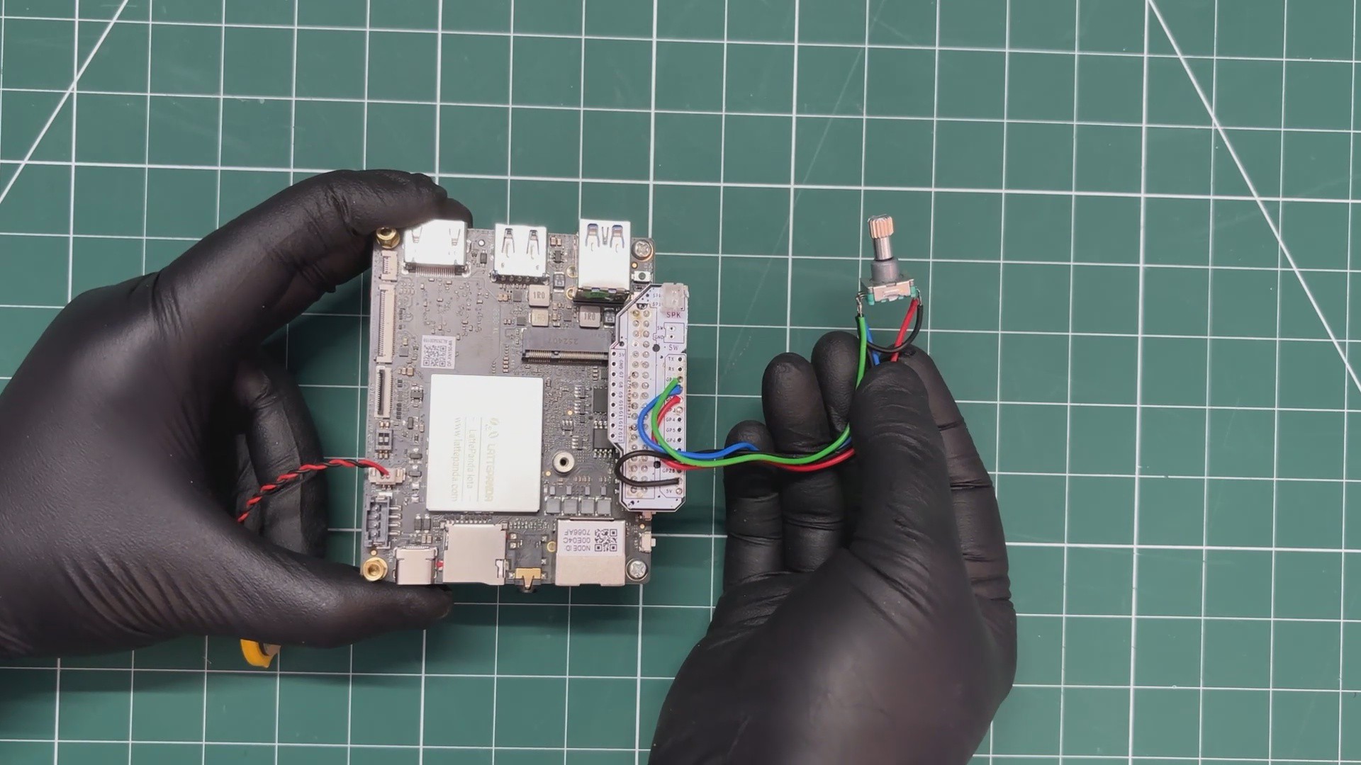

    • We connected GPIO 0 and GPIO 1 to the encoder’s A and B pins through 10 kΩ resistors placed in series.
    • The middle pin of the encoder, along with one pin of the encoder’s push button, was connected to the GND of the LattePanda.
    • The remaining encoder switch pin was connected to GPIO 3.

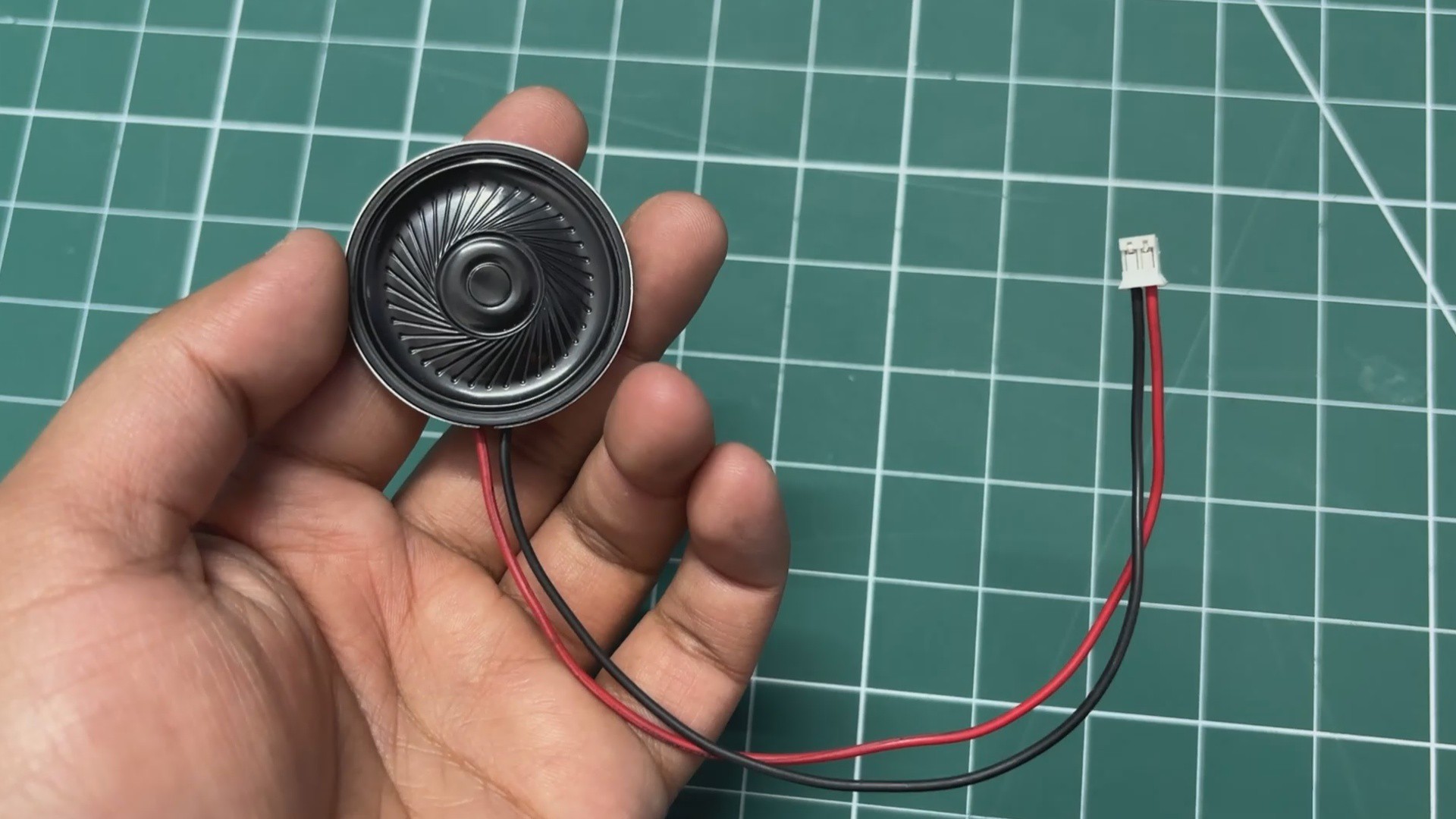

    • For sound output, we connected an 8-ohm, 0.5-watt round speaker to our setup using the onboard JST connector, simply plugging the speaker directly into it.
    • We used single-core jumper wires for all the connections, and once the wiring was complete, we moved on to the code uploading process.

    • Before uploading the code, we first set up the RP2040 in the Arduino IDE. We navigated to File>Preferences and added the below JSON URL to the Additional Boards Manager URLs.
    https://github.com/earlephilhower/arduino-pico/releases/download/global/package_rp2040_index.json
    • Next, we opened the Boards Manager, searched for Raspberry Pi Pico, and installed the board package by Earle Philhower.
    • After installing the Raspberry Pi Pico core for the Arduino IDE, we uploaded our main code to the onboard RP2040 co-processor.
    • To put the RP2040 into boot mode, we pressed and held the BOOTSEL button, then pressed and released the RST button, and finally released the BOOTSEL button. The operating system then detected the RP2040 as a new USB Mass Storage Device.
