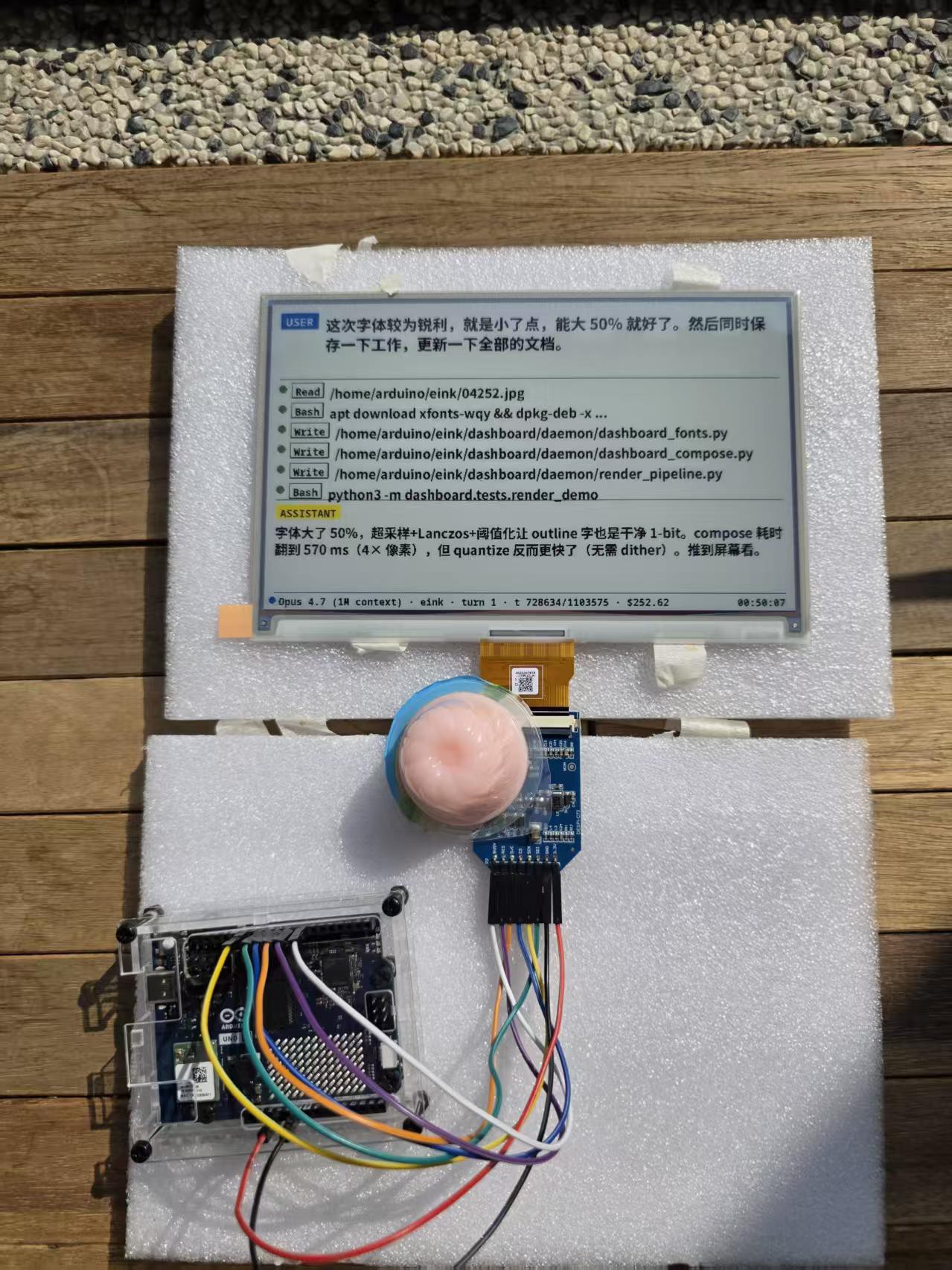

    The goal is to build a hardware-native carrier for AI coding workflows — a dedicated peripheral that displays the running state of Claude Code on a low-glare, reflective, always-on colour surface. The form factor we converged on:
    • Local agent host: Arduino UNO Q running Debian on its Qualcomm Dragonwing QRB2210 (4×A53 @ 2.0 GHz). Claude Code is installed on the board itself, not on a host PC. No network service is required between agent and display.
    • Real-time bridge: ST STM32U585 (Cortex-M33 @ 160 MHz, 786 KB SRAM) running Zephyr RTOS, driving the panel over 10 MHz SPI with strict timing.
    • Display: Good Display GDEP073E01 — 7.3", 800×480, 4 bpp, Spectra 6 colour, Solomon Systech SPD1657A controller.
    A 5-zone dashboard layout maps Claude Code's lifecycle events (UserPromptSubmit, PreToolUse, PostToolUse, Stop) to e-paper regions with throttling discipline (partial refresh ≥3 s, full refresh ≥60 s, force-scrub every 20 partials).
    This log covers the 25 days from drafting the design document to verifying seven reproducible production recipes for the 6→8-colour rendering pipeline. Most of those 25 days were not spent on waveform design — they were spent debugging the toolchain.
    Image 1: Project hardware — UNO Q + 7.3" GDEP073E01 displaying the Claude Code dashboard live (USER prompt, ASSISTANT output, tool-call list, status bar)
