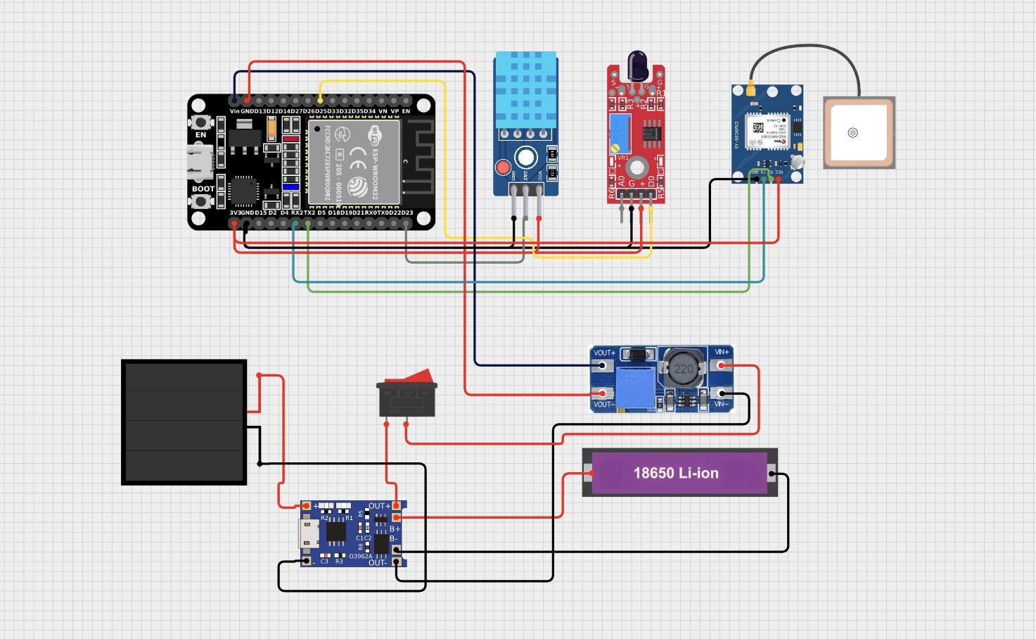

Connection diagram of the node

  • 2 × Esp32 devkit v1 Main microcontroller of the project
  • 1 × Dht11 For sensing temperature
  • 1 × IR flame sensor For sensing infrared heat signature for flames
  • 1 × 18650 lipo battery To power the whole circuit electronics
  • 1 × 1-2w mini solar panel Keeping the battery charged
View all 6 components
  • 1
    Step 1: Wiring the Sensor Node
    Follow the system connection matrix to wire your sensory peripherals directly to a 30-pin ESP32 DevKit v1. All peripherals operate natively at 3.3V logic levels:
     DHT11 VCC connects directly to the ESP32 3V3 power rail.
     DHT11 DATA connects to GPIO 23.
     DHT11 GND connects to the common system GND plane.
     IR Flame Sensor VCC connects directly to the ESP32 3V3 power rail.
     IR Flame Sensor DO connects to GPIO 25. This digital signaling output pin drops to an active LOW state whenever infrared radiation from an open flame is verified.
     IR Flame Sensor GND connects to the common system GND plane.
     Neo-6M GPS VCC connects to 3V3.
     Neo-6M GPS TX connects directly to GPIO 16 (mapped to hardware Serial2 RX).
     Neo-6M GPS RX connects directly to GPIO 17 (mapped to hardware Serial2 TX).
     Neo-6M GPS GND connects to the common system GND plane.
    Note: The primary Ground Control Station (GCS) base unit requires no sensor wiring layouts; it operates as a standalone bare ESP32 linked directly to a laptop via its USB interface connection.
