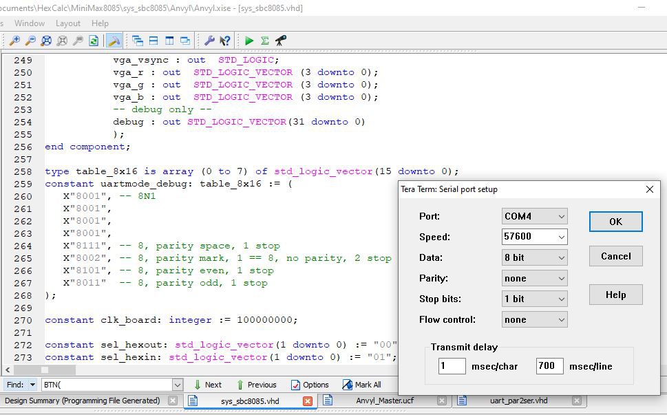

The software components are best explained by going through the 4 supported modes of operation:
-- SW7 SW6 Mode TTY (VGA) UART TX 7seg LED
-- 0 0 sel_hexout - Generated HEX mem2hex debug port (or bus if nWait = 0)
-- 0 1 sel_hexin Microcode trace Echo UART RX hex2mem debug port (or bus if nWait = 0)
-- 1 0 sel_loopback0 Echo UART RX Echo UART RX Baudrate (decimal)
-- 1 1 sel_loopback1 Echo UART RX Echo UART RX UART mode
Mode 3 - display UART mode and loopback test

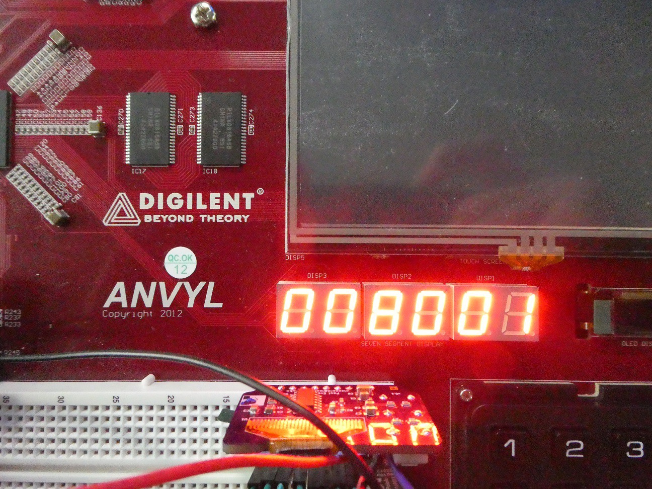

- Displays the UART mode in somewhat cryptic way in 6-digit 7-seg LED
UART is two separate circuits (SER2PAR and PAR2SER) that I reuse in many projects. They support a variety of 8-bit per character transmit and receive frames. The terminal program on the host should be set to same setting (8-N-1 in this case)
Anvyl board switches 2..0 select the mode as visible in the image below.
(note 700ms delay per line - this is to allow time for the trace of HEX2MEM microcode to display before processing next incoming character, more about this below)
- Echos the characters coming from UART input (RX) back to output and also to TTY2VGA. This allows testing those components too.

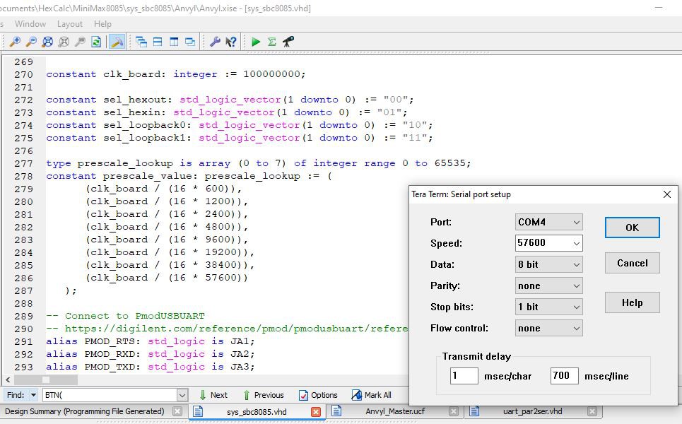

Mode 2 - display baudrate and loopback test
Another test mode which:
- Displays real baudrate (BCD format) on the LEDs
- Also provides character loop-back just like mode 3
Anvyl switches SW5..3 select the baudrate from 600 (000) to 57600 (111). Note that the number displayed is not exactly the typical standard rate. The reason is that the frequency is actually measured on the board. First, the FPGA 50MHz board frequency is divided by two prescale factors, one leads to freq_4096 that can be divided by powers of 2 down to 1 Hz, and the other based on the selected divide value to get baudrate_x8 frequency:

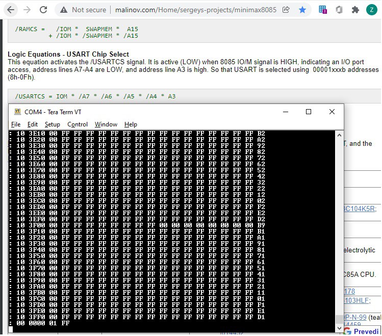

Mode 1 - Accept ASCII stream in Intel HEX format, and write to memory
The key component here is Hex2Mem which I intend to document better on its own page. But few explanations here until I get around to do it. Refer to slightly modified VHDL and microcode.
Basic operation is as follows:
- Wait for ASCII character
- If there is one, branch to location that processes it (the ASCII code can be thought of as an "instruction")
- If invalid, output error, go to step 1
- If valid, process it based on which it is and what is expected or not (for example ":" can come only once at the beginning of line, spaces or tabs anywhere but will be ignored, unless they are between hex digits that should not be split (e.g. data bytes)
- Each two digits are written into one internal byte memory location (there is a small 64 bytes buffer)
- As a byte is written into internal RAM, the checksum is updated
- The number of bytes received is checked with expected record length, for error check
- Final byte received is the checksum. Added to accumulated checksum it should result in 0x00 in the LSB of the checksum register
- If checksum is correct, the data bytes are written in a burst to external RAM bus. This means RAM will not be thrashed by bad checksum record
- Either CR and/or LF indicates end of record, this increments the line counter, clears the character counter (these are only used to show error message) and processing of new record can start.

The video is a shaky recording of a session to input from a test HEX file into the memory. It wasn't successful because I forgot to clear the wait mode, so the component was stuck waiting to write a byte (false condition, so repeat kept executing):

- TXDREADY (IN) - handshake signal for character output. Microcode waits for this signal to go high before next character is emitted.
- TXDSEND (OUT) - if TXDREADY is high, then a character is put into outside buffer and this signal driven high. The UART par2ser implements the reverse side of this protocol. A FIFO could be injected between them.
- CHAR (OUT) - ASCII code of the HEX stream generated appears here.
Here is how the send character handshake appears in the microcode:
// "UART" is supposed to signal TDXREADY = 1 when presented 0x00 or when serial trasmit is done
emit: if TXDREADY then next else repeat; // sync with baudrate clock that drives UART
if TXDSEND then return else return;
TDXREADY is checked 3 times in a row to prevent any clock domain glitches. Finally, the TXDSEND is checked, but this condition is hardcoded to "1", means it will always return to the caller at this point, but a simple comparator is hooked up to look for check of this condition to generate the send pulse:

Sanity check for I/O:
Reading the I/O space can give some indication if it "sniffs right", like in this case. The only IC hooked up to I/O space is 8251 UART, which is enabled when address is XXXXXXXX0001XXXX - when dumping out addresses that match it is visible that "something" appears in those locations, while everywhere else the DBUS returns the default float high.
