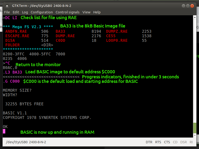

This was a natural extension to the Mega Filing System, so the S3/L3 commands were created. It meant binary chunks of memory contents could be saved as files and reloaded to the original address or a new address. To do this the first two bytes of all saved files contain the default 16bit address they were saved from, and in many cases, most likely to be reloaded back to that address. This means a saved file will always be seen by the Mega 2560 as two bytes bigger than the memory block used to create it. Why do this? Well a long term goal is to be able create a library function where unknown commands are also looked up as files and can be executed by simply typing their filename. The program would be loaded at the default address, and execution begun at the start of the file. This would allow extension of commands and memory re-use (eg sequences of programs could be run in the same memory space, others might be semi permanent etc). A related goal was have all filing transactions run in raw binary and not have the overhead of trapping trigger characters in ASCII streams etc and sending everything in hexadecimal pairs in ASCII. Going to the trouble to compute lengths of files where ever possible and only using ASCII streams for displaying purposes.

This may be best shown by a self explanatory run through a demo (user input purple, explanation in green):
It also means larger binary images can be conveniently loaded such as Microsoft basic:
This 8k image loaded in under 3 seconds and would have been quicker without the loading progress indicators. So about 24kBits/Sec.
