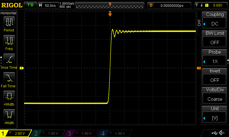

The picture above also shows that the signal generator is indeed configured as per the script. Scope, too:
If you just have the scope, remove the signal generator part. And of course also put in the serial numbers of your own devices!
