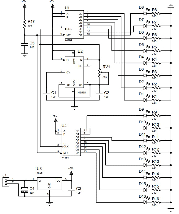

The proposed dynamic turn indicator control circuit doesn't involve any expensive or scarce components. It's easy to reproduce and it works immediately after assembly (if everything is soldered properly).
The circuit lights the LEDs in a strip one by one immediately after the power supply voltage is applied to the J1 connector. Once all the LEDs are lit, they will continue to stay lit as long as the power supply voltage is present. If you power this circuit from a car turn signal relay, you get a dynamic turn signal effect as a result.
The speed at which the LEDs in the strip gradually light up is set with the RV1 variable resistor at 50kΩ. Thus, you can pick a speed that's to your liking. At the maximum resistance of the variable resistor, all 8 LEDs will light up in about 0.6 seconds after power is applied. You can choose a position for the resistor that makes all the LEDs stay lit for a little bit after the strip is fully powered, but that's up to you.
If your turn signal relay flashes once per second, you can replace the RV1 variable resistor with a regular 43kΩ resistor.
The standards for rear turn signals are a bit of a mess right now. On some cars they're red, while others have yellow ones. Therefore, the selected R1-R8 resistors are for red and yellow LEDs with an operating voltage drop of about 2.2V. The operating current should be about 10mA. But remember that the maximum output current for the 74HC164 per output is 25mA. This value should not be exceeded. Choose whichever turn signal color you like more.
If you believe that 8 LEDs are too many for your liking, you can reduce their number down from the bottom to the top, i.e. first remove D8, then D7, and so on until you have the desirable number of LEDs left.
Conversely, if 8 LEDs aren't enough, you can safely scale this circuit without any problems or catastrophic price spikes. All you need to do is add the necessary number of shift registers, as shown in the following diagram.
The high output of the first shift register is connected to the data input of the second register. You can also connect the data input of the third register from the high output of the second register. Then you can just keep going with this chain pretty much endlessly.
When adding another circuit, you should immediately add a trim resistor with a lower resistance. I recommend using 20kΩ.
Now let's talk a little bit about powering the circuit. The 7805 voltage regulator allows you to get +5V to power the circuit. The input voltage can vary from +7.5V to 15V. But don't forget that the 7805 can heat up quite a bit, in which case you should use it with a heat sink. The 7805, like any other radio component, also has an operating current limit. Take this into account when selecting the operating current for the LEDs. The total simultaneous current consumption of all the LEDs must not exceed the maximum operating current of the voltage regulator. It would be even better to have a safety margin of about 20 percent.

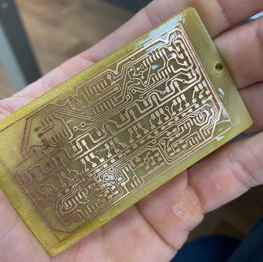

I once again double-checked everything. The circuit turned to be incredibly simple, which is probably why I continued to doubt up to the very last moment that it would work when put to the hardware. With the help of an iron, I quickly assembled the prototype and everything worked as it was supposed to on the first try.
The board looked excellent when it was printed in green! All it took was six simple microchips and a handful of passive components, and there you go – another puzzle is solved.
