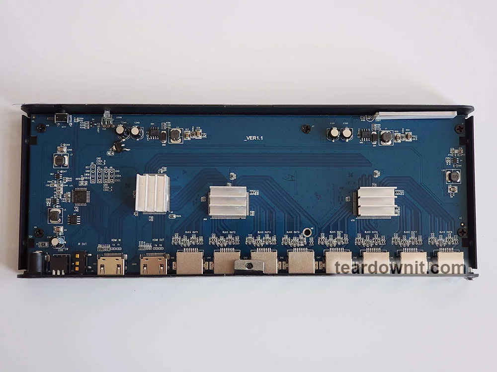

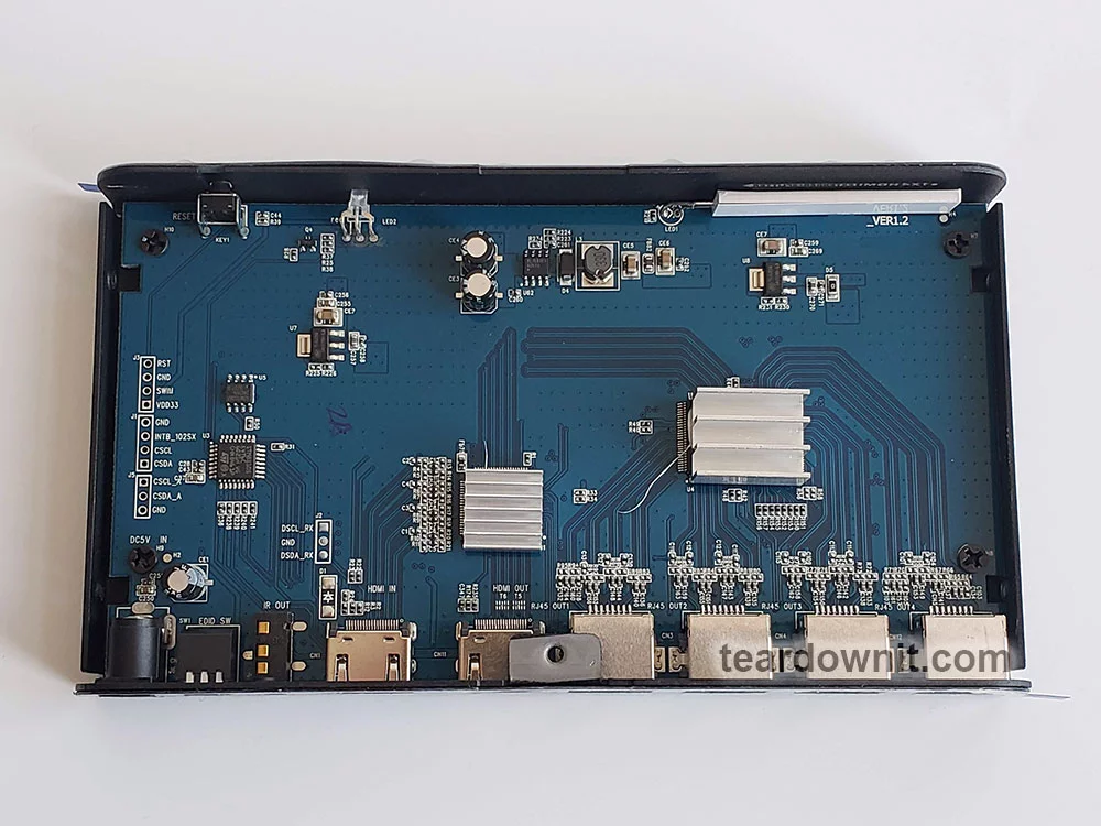

If you remove the cover, you can immediately appreciate the thickness of the steel housing. It's quite impressive. The quality of the soldering is also relatively high. You can also notice another impressive component once the cover is off, which is the heatsink that's installed over the chip responsible for the video transmission via the twisted-pair network cable.
All the connectors are fitted perfectly to the case with no gaps in between. Even if you unscrew all the fastening screws from the board, it is still not very easy to remove it.
Interestingly, in the LKV718PRO model, which has a built-in splitter/transmitter with 1 input and 8 outputs, there are actually two video transmission chips implemented.

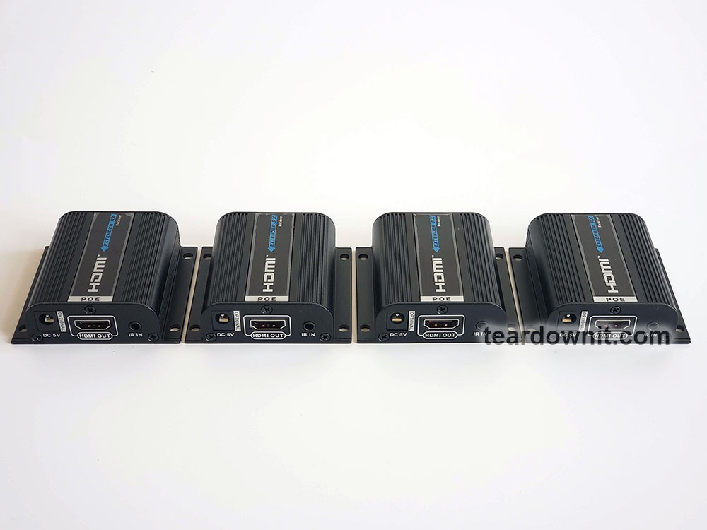

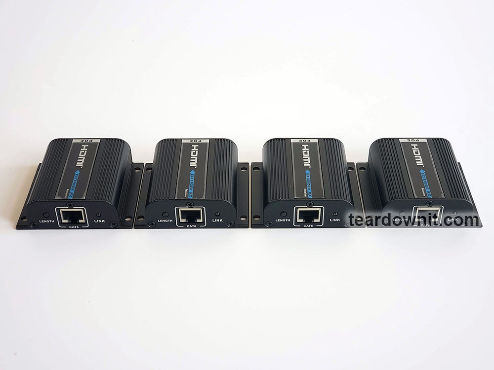

Receivers

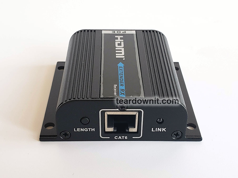

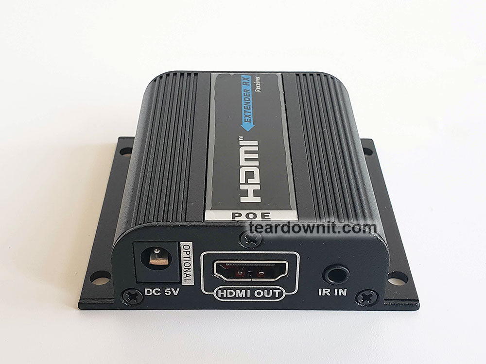

The HDMI receivers via twisted-pair network cable are fairly compact in size.
In addition to the minimal set of ports (RJ45 input and HDMI output), there is also an input for an IR receiver and an optional port for connecting a DC 5V power adapter. The adapter is not included in the package and it is not quite clear what its purpose is.

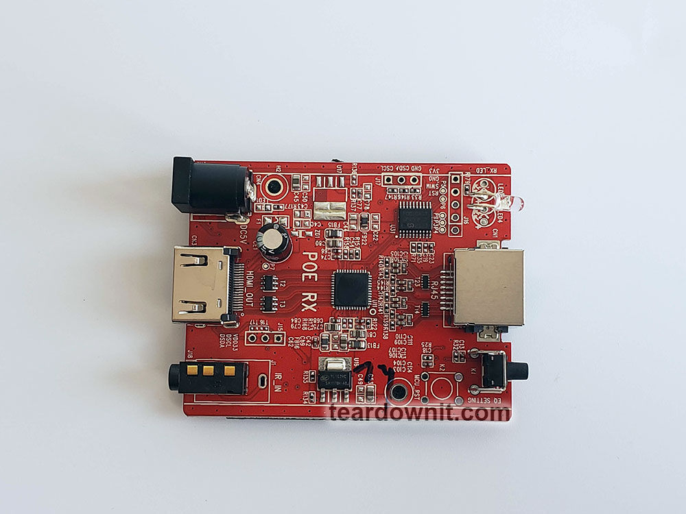

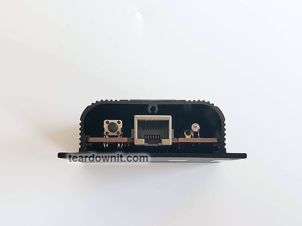

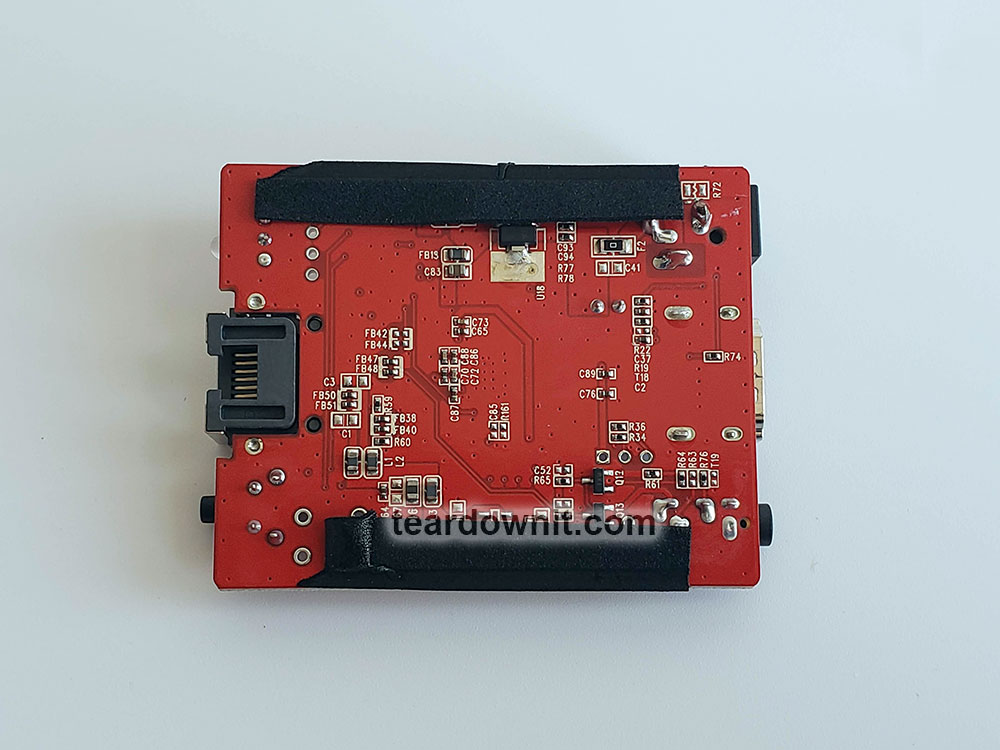

Once the case is disassembled, it becomes apparent that is also made of thick sheet metal. The top of the case has ventilation slots for better heat dissipation.
The PCB board fits almost perfectly to the case and doesn't have any gaps.

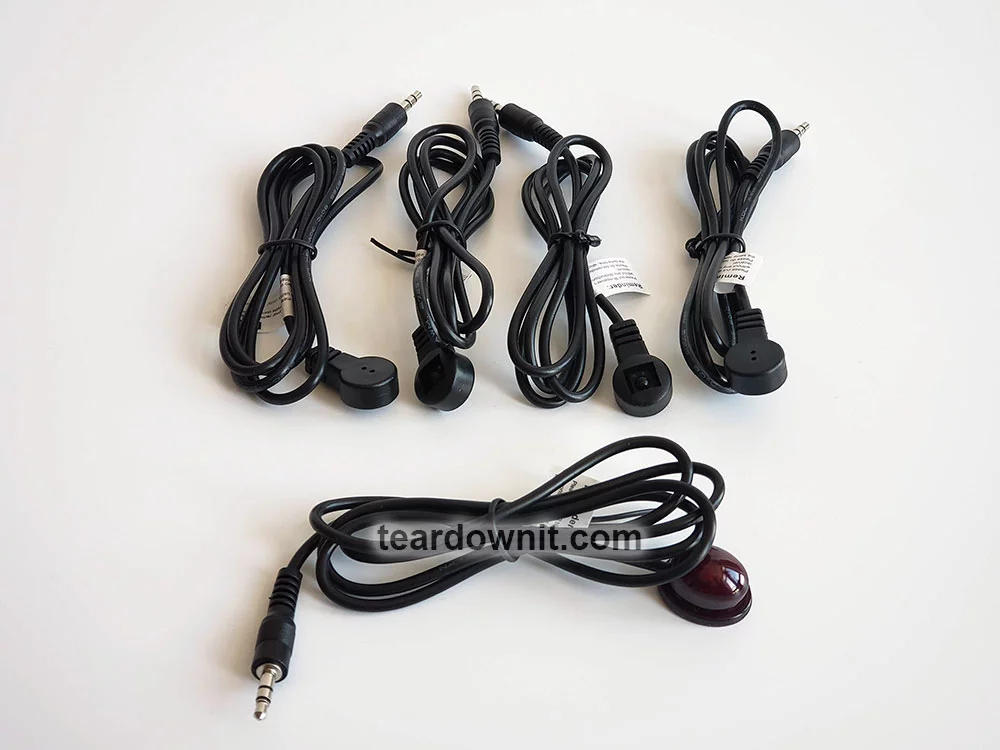

IR blaster and IR receivers
There are four Receivers and one Blaster included in the set. Note that they are necessary for an additional function: the reverse transmission (pass-back) of the infrared signal. You can read more about this function in this article (link). In our case, it is possible to control the video source via IR from any of the connected TVs.
