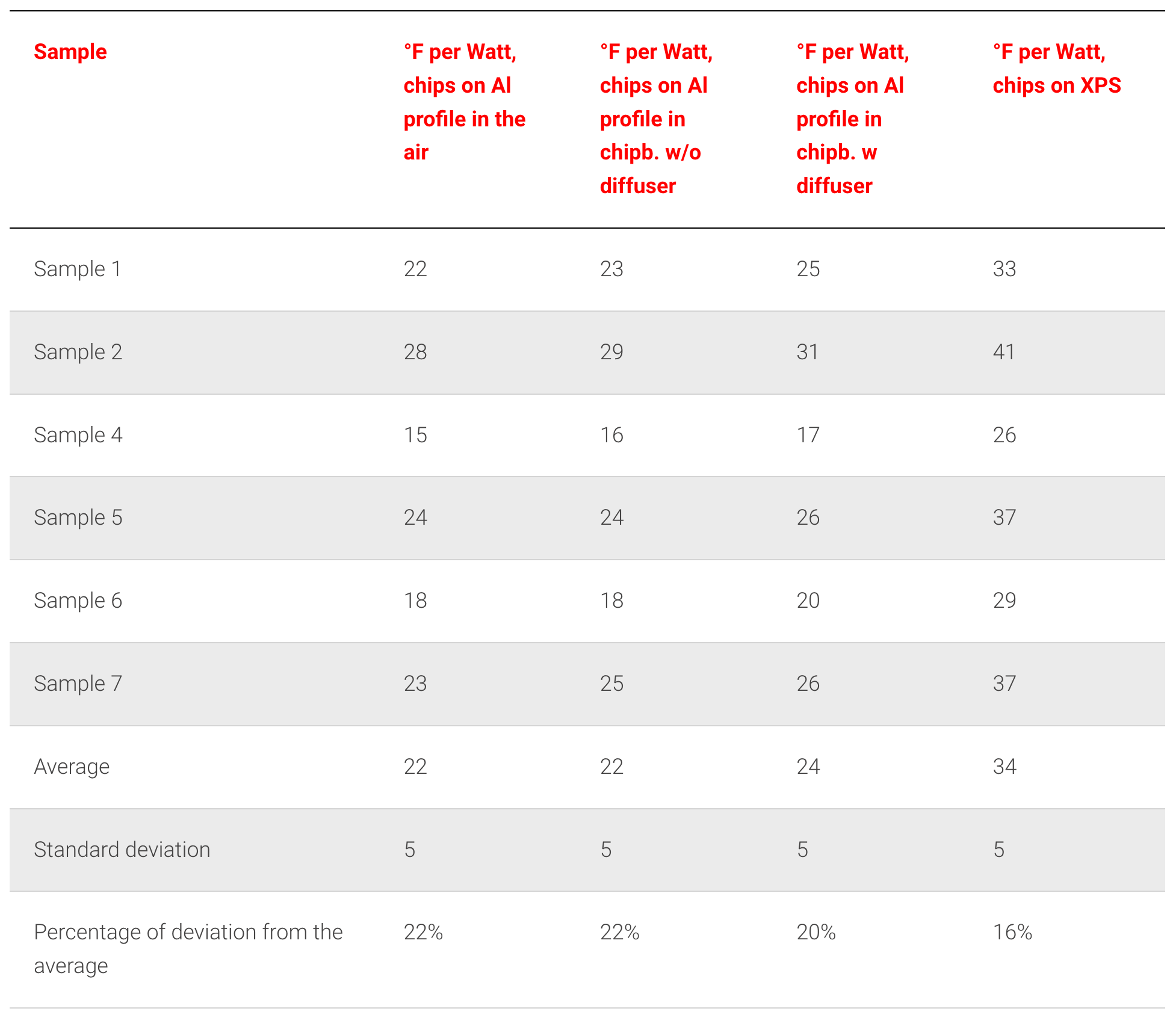

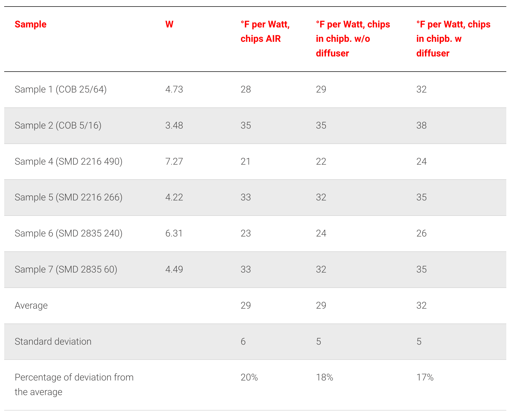

How does the power consumption affect the LED chip heating?
Modern LED chips have an efficiency of 35-45% for the top manufacturers (Philips, Cree) and an efficiency of 10-45% for the available range on the market. This parameter means "how much energy is converted into useful light". The rest of the electricity goes to useless and harmful heating.
Electricity consumption is measured in Watts or Volts*Amps.
In a previous experiment I checked the real power consumption of different LED strips. (learn more)
I calculated how much heat (in degrees) per watt the samples produced. My sample strips have different designs, characteristics, and LED chip efficiencies. So I calculated the average values and deviations from them for each sample to find commonalities for all samples.
The values for "Sample 3 (COB 5/32)" are strange and way out of line with the average. I am still trying to figure out the reason. I measured all values again for this sample and got the same result.
Therefore, I removed this sample from the list and got a deviation of less than 22%. This deviation value allows me to speak about the objectivity of my experiments and each heat transfer method. My conclusions can be applied to many other LED strips of similar power (based on the repeatability and similarity of my several results for different strip types).

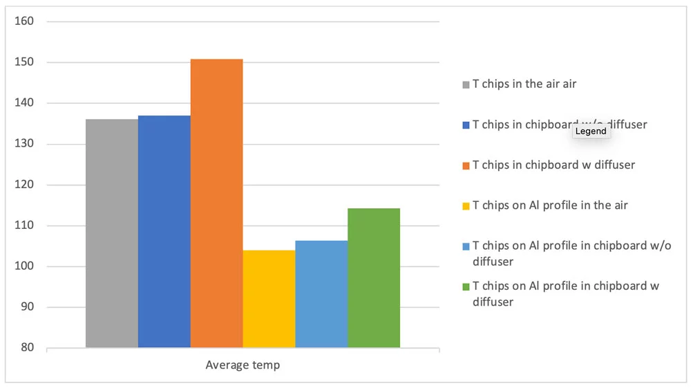

LED strip cooling efficiency in different ways (within the limits of my experiments)
I've sorted my experiments and cooling methods by effectiveness.
Why is cooling important? Because at temperatures above 180-185 °F the LED chips and phosphors work under unfavorable conditions and degrade quickly. The lifetime of such a device decreases. For example, at less than 180 °F the average lifetime will be 20000-50000 hours, but at 200 °F the average lifetime will be 5000-10000 hours. The lifetime may be reduced to 1000 hours because factory errors in manufacturing cannot be excluded.
1st place (the most efficient way / experiment with the lowest chip temperature) = LED chips on Al profile in the air.
2nd place = chips on Al profile in the groove in chipboard w/o diffuser
3rd place = chips on Al profile in the groove in chipboard w diffuser
4th place = chips in the AIR
5th place = chips in the groove in chipboard w/o diffuser (4th and 5th places are almost the same)
6th place = chips in the groove in chipboard w diffuser
7th place = chips on XPS (the most inappropriate way - don't do that!!!!)

My experiments 5, 6, 7 showed the high usefulness of aluminum in cooling LED strips and chips. The temperature of the LED chips is reduced by 30 degrees or more.
Here is what it looks like in the temperature comparison:

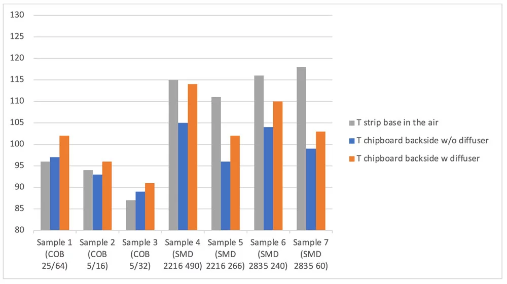

Is COB technology really more efficient at dissipating heat from LED chips than traditional SMD technology?
Yes! The direct contact of the chip with the strip base ensures direct heat transfer from the chip to the copper base of the strip with a continued transfer of this heat to the external environment. This design perfectly reduces the overall temperature of the chip and strip.
This effect is poorly visible in the tables but well visible in the graphs.
Experiments 1, 2, and 3.
Please note. The electrical power consumption of sample 1 (COB) is greater than that of samples 5 and 7 (SMD). More power means more electricity is used for heating. But the temperature of the COB sample is less than the SMD sample.

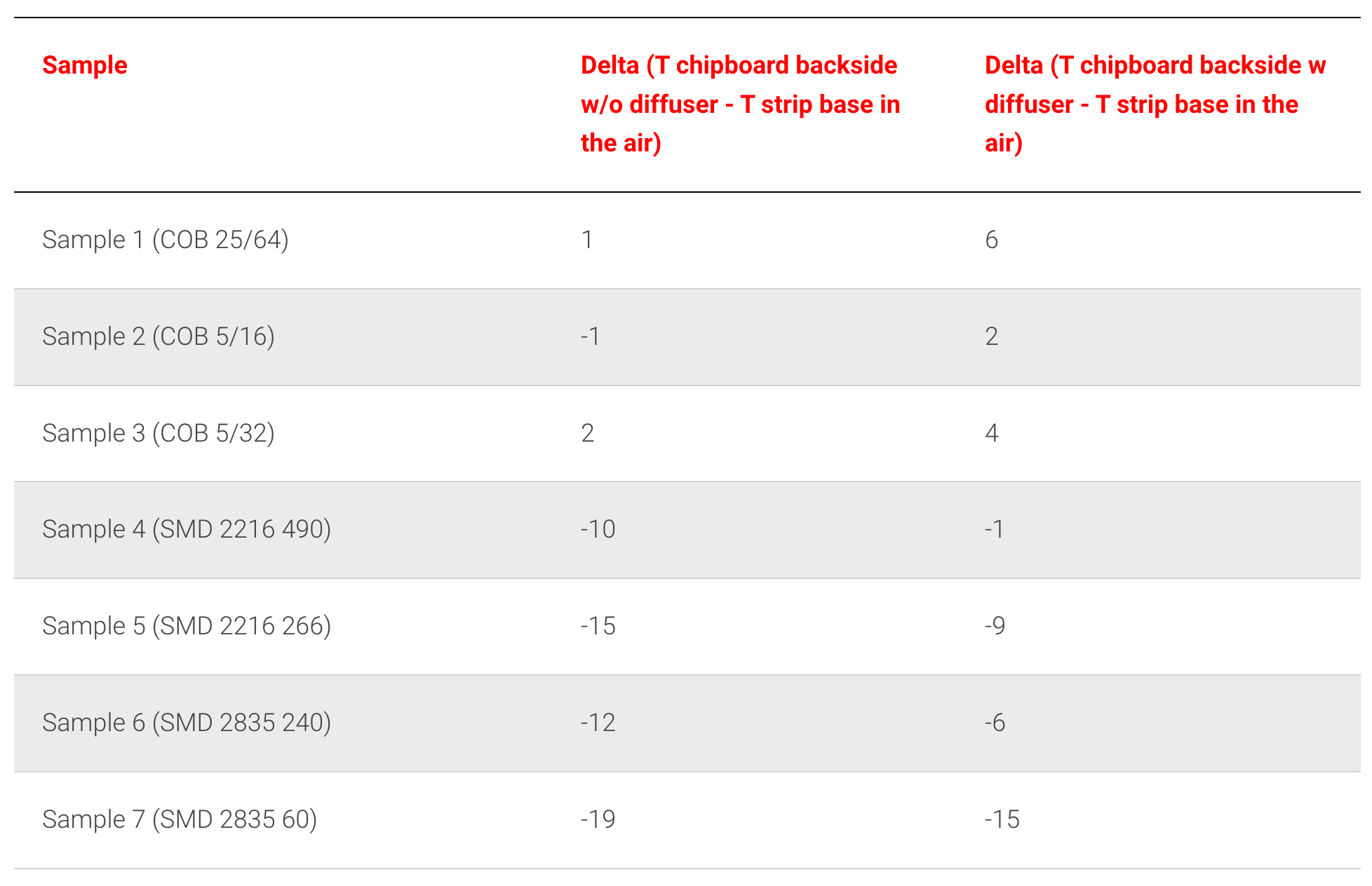

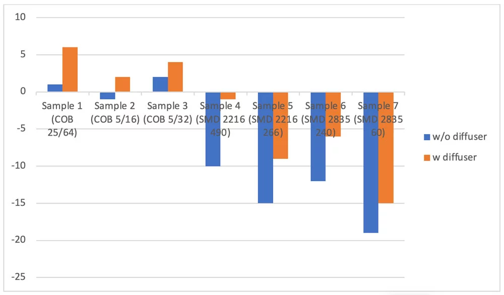

Additionally, I did some calculations.
I measured the strip base temperature in air (experiment 1). This experiment's primary heat sink for the LED strips is air (convection).
And in experiment 2, I placed the strips in a groove in the chipboard and measured the temperature of the back side of the chipboard in this area. The primary heat sink for the strips is the chipboard in this experiment.
I calculated the temperature difference at the back of the chipboard and the strip base in the air.
The temperature delta nature of COB strips is quite different from SMD strips. The heat is transferred mainly through the base of the COB strips.
Why? The LED chips are soldered directly onto the base metal with high thermal conductivity. The heat from the chips goes immediately into the material with lower thermal resistance. On the other chip side is silicon with a phosphor with a much higher thermal resistance and thermal conductivity - 2800 times more (Silicone = 0.081 and Copper = 228 in the table (link, new tab).
Cooling through the strip base (not through convection) for COB strips is much more effective in prefabricated/assembled luminaires with housing and a diffuser.
