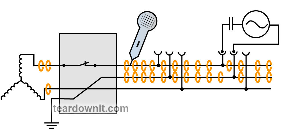

There are three ways to send a signal to live wiring in the active tracing mode.
THE FIRST WAY
is to use a signal generator that provides resistive load with alterating resistance at a constant frequency. When you connect such a signal generator to the mains socket, the wires will start emitting a specific signal. This signal can be detected by a receiver with an inductive sensor. Moreover, the alterating resistance of the signal generator has no affect on the operation of the equipment that's connected in parallel, nor the alterating resistance of any other device.
In this case, the wiring can only be traced from a specific socket to the switch or breaker that's located inside the switchboard. However, you can find a switchboard and identify the relevant circuit breaker inside it without even performing line tracing.
The signal from such a signal generator goes from the load towards the power source. It can successfully overcome transformers. Thus, the signal amplitude varies in accordance with transformation ratio. But this signal is not passed along to circuits that are connected in parallel (e.g. other mains sockets). This hapens due to the fact that the traced signal is generated by current fluctuations caused by an alterating generator resistance.
THE SECOND WAY
is to use an induction clamp. The clamp is installed only on the phase wire conductor. The traced signal is generated by both the voltage and current fluctuations. The line is traced with the use of an inductive sensor starting from the point where the clamp is attached. Tracing can be directed to the load point (anything that consumes electricity) or to the power source.
Due to the high frequency of the signal sent, this method can be used to trace even those disconnected circuits. This is possible due to capacitive leakage current.
THE THIRD METHOD
is based on the use of the signal generator with high-voltage capacitive decoupling. The signal generator is connected directly to any wire in the line. It generates an AC signal in the wire regardless of the circuit voltage availability. The choice of sensor depends on the signal frequency. An inductive sensor is used for low-frequency signals, while a capacitive sensor is used for high-frequency signals.
Meanwhile, if the line capacitive leakages are insufficient, then line can either be loaded or terminated at the far end.
IN CONCLUSION
it is important to note that the signal generated by a professional-grade signal generator is actually combination of three or four frequencies. This provides reliable tracing in conditions of high interferance. Signal generators that can be directly connected to powered lines can be utilized with both direct and alternating current of up to 600 V. Therefore, they are also suitable for tracing power circuits on power supply nodes.
