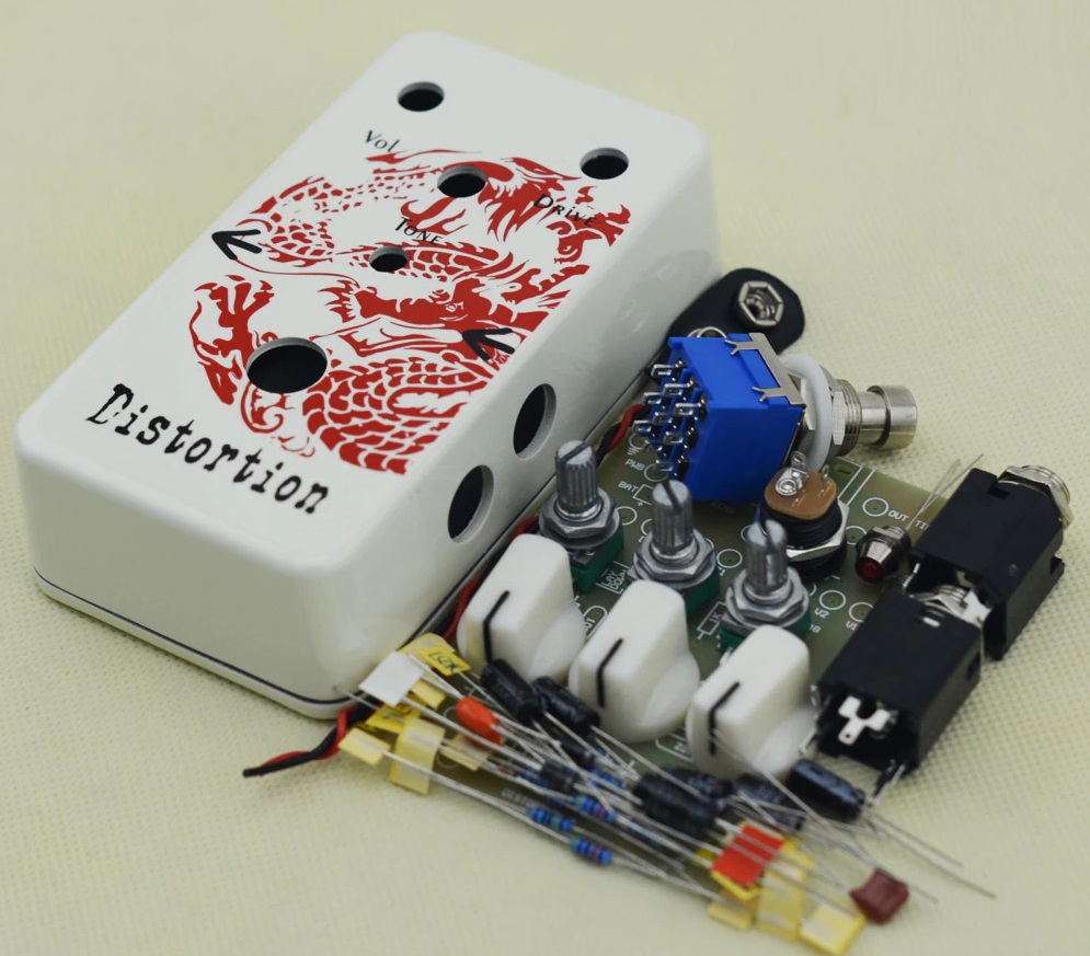

The pedal is assembled from the DS-1 with a 1590 B-style box from LANDTONE, aka TTONE. Under the MOEN effect lab brand, they also sell pre-assembled pedals.
Interestingly, the company makes two different types of kits marked DS-1. The one I assembled is a BOSS clone. It has round variable resistors, black jack sockets with a red stripe, and three transistors in the kit because it uses true bypass.
There is another set from the same manufacturer, DISTORTION-1 or NO-1, without transistors, with two 5 mm LEDs, square potentiometers and black jack sockets without red stripe. I also ordered and will assemble it, but it will be a clone not of BOSS but another pedal.
The color of the pedal body, the images, and the inscriptions on it can be different in different kit variants. And then there is the DS-2, "Dragon Roar" without LEDs and transistors. And I will build it one day, too, because I like guitar electronics and quality DIY kits.
