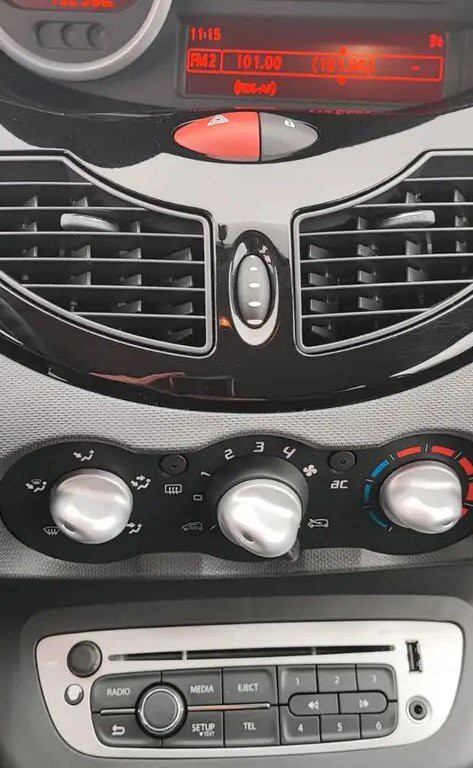

Radio R1 and Display A2 are discontinued. (replaced by Radios with integrated Displays). Scenic 3 drops R1 support on cluster.
Radio R2 gets a new Version and now has front USB (still uses Protocol R2)

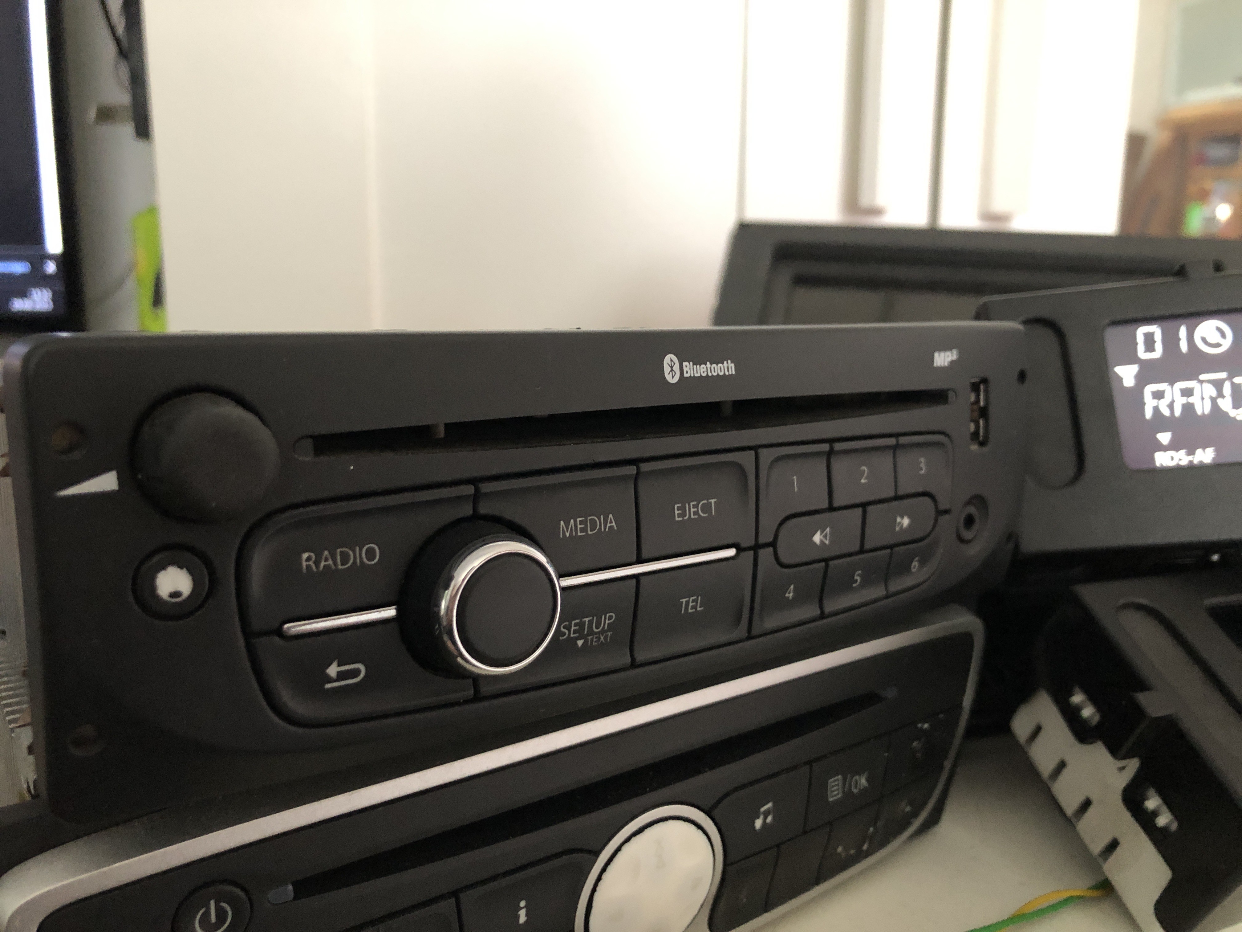

Freshly added to the reversing collection: Radio R2 Facelift out of a Renault Master (R-Plug & Radio): Notice its a different shape but the buttons and connector placement (and inner workings) is the same on all versions.
I now have all parts ( Display A3 and Radio R2) to start reverse engineering Protocol R2. Protocol R1 is fully documented now and i am working on a "library like" arduino solution to make it easy to control Display A2 (Protocol R1).

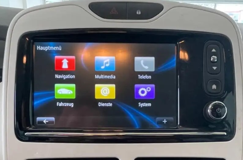

From 2012 Radio RLink + Display (Protocol RLink):
RLink Radio is just compatible to the RLink Display (Touchscreen and no SD slot on the display).

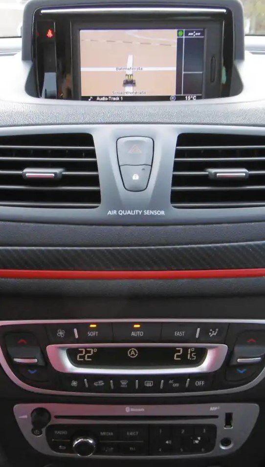

Depending on the car RLink was equipped to, the controls are different. On Megane 3, Laguna , Fluence it uses a "Radio Style" control with an seperate remote control near the arm rest. On Clio 4, Twingo 3, Zoe and Captur it uses a reduced control element rignt next to the display and have no CD Player. The Maps are now located in an external SD card reader/USB socket housing. RLink will not output to old TomTom or Scenic 3 cluster.
"Radio Style" controls on for example Megane Scenic 3:
"Reduced" controls on for example Zoe:
I own 2 R-Link Displays (one out of Clio 4 and one out of a Smart) and a R-Link Radio (out of a Laguna). It works on the bench and waits to be reversed further.
