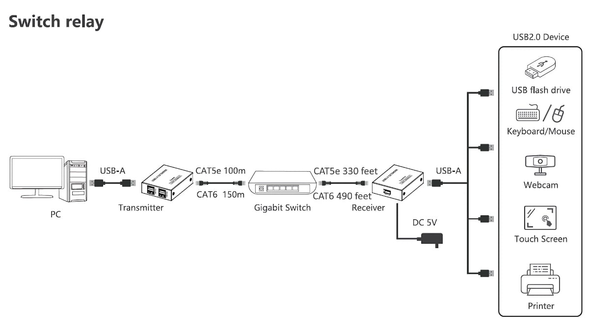

A unique feature of the INRIKS EX100USB kit is the ability to work in two modes: one-to-one connection and switch relay.
One-to-one connection connects the transmitter to the receiver with a single piece of twisted-pair cable up to 490 feet.
Switch relay connects the transmitter to the receiver through a gigabit switch. This scheme will increase the transmission range to "490 + Switch + 490" feet.

Switch relay connection
In the next step, we tested the possibility of extending the range with an Ethernet Switch. We took two 330 feet of CAT6 twisted pair cables and connected the equipment following the diagram in the manual:
After powering up, the LEDs on the RJ45 started blinking as if it was a One-to-one connection. But then we had a failure. The peripherals did not even try to be detected in the operating system of our laptop. Most likely, the transmitter and receiver do not see each other.
We cut the twisted pair cable sections down to 230 feet each. The result was the same - the kit did not work. The effect was still negative when we replaced the Gigabit Switch with a different manufacturer.
Instead of a conclusion.
In one-to-one connection operation, the extender performed flawlessly. This is an excellent device if you need to extend the USB 2.0 interface up to 490 feet.
But if you want all the claimed functionality, we recommend something other than this device. The test in Switch relay mode failed.
