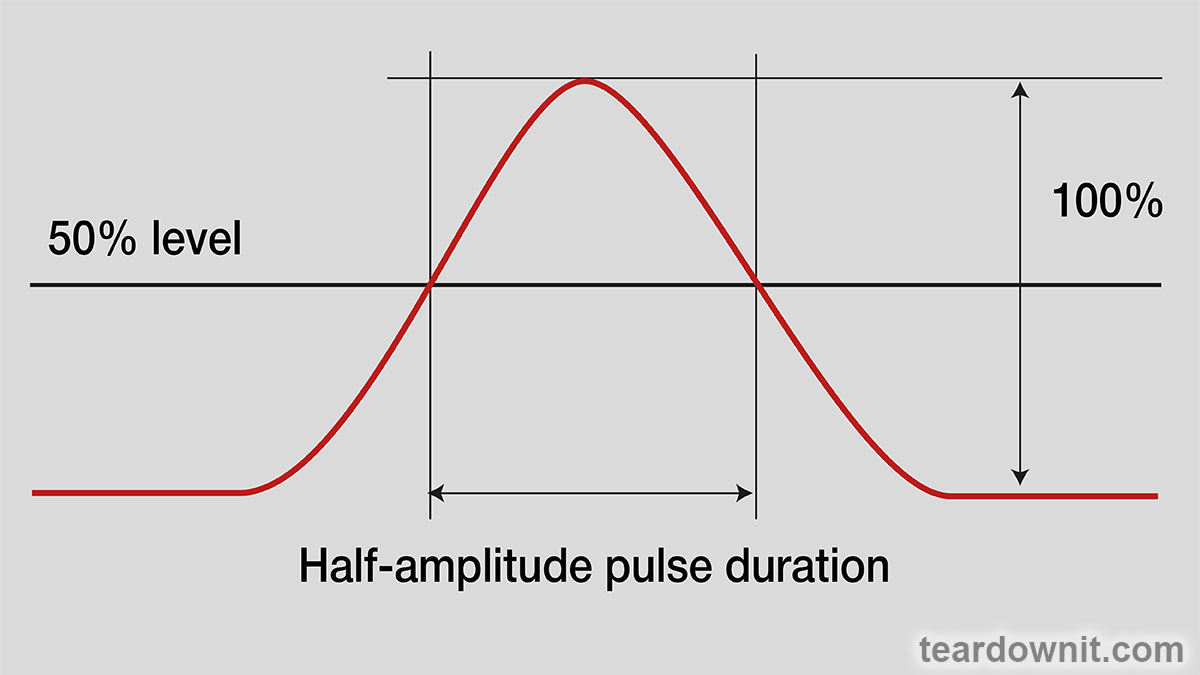

The Pulse
Most reflectometers are able to generate probing pulses of various durations. Short pulses allow one to detect a faulty spot relatively close to the point of connection of the reflectometer; they also provide better search resolution, meaning it's possible to detect two individual damage points close to each other. Longer impulses help find remote faults in the cable as they carry more energy. However, the search resolution in this case is decreased.
It is a common misconception that decreasing pulse width necessarily results in increased accuracy. This is not entirely true. When using a reflectometer, the measurement is made along the edge of the pulse. Therefore, if the primary purpose of the test is to detect just the first fault, the pulse duration has virtually no effect on the accuracy of the pulse edge measurement.
The main advantages of a short pulse are the narrowing of the so-called "dead zone" following the transmitted pulse and a corresponding improvement in resolution when detecting faults. The easiest way to explain the "dead zone" effect is by using the example of searching for two closely located damage points. Comparing graph shapes on the display for shorter and longer pulses, we'll clearly see that short pulses make both spots identifiable. But as the pulse width increases, the two spots become indistinguishable, as the dead zone covers the second one.

It makes sense to mention that the amplifier and sampling system of the reflectometer are not always capable of displaying very short pulses. However, some reflectometers can generate and output them. It's elementary to check; simply connect a resistor with a value of Zo to the output terminals of the reflectometer and then measure the pulse duration at half amplitude using the reflectometer cursors. If the device has a balance adjustment, it's the best time to use it to get a clear pulse.
