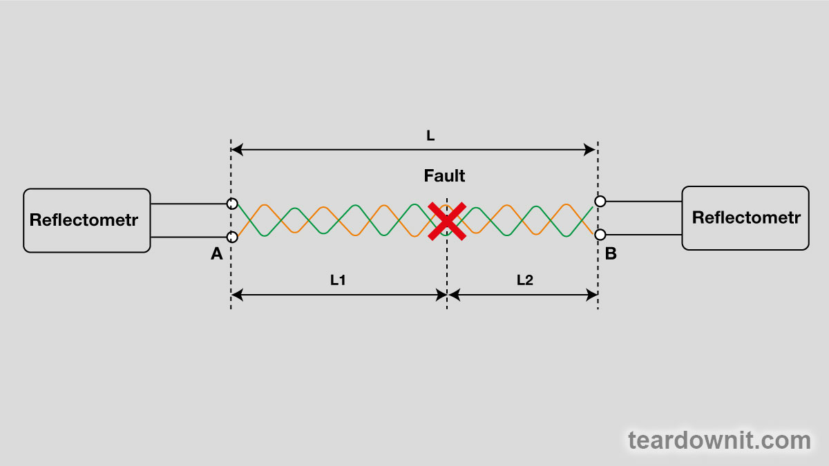

4. If the cable length is known, but there is no suitable pair for comparison, then it is necessary to have access to the cable from both sides.
Roughly pick a VOP value and determine the approximate distance (L1) to the fault on side A. Using the same VOP value, determine the approximate distance (L2) to the fault on side B.
The exact distance to the damage can be calculated with L1 and L2.
From side A, according to the formula:
(L1/(L1 + L2)) x L, where L is the known cable length.
From side B, according to the formula:
(L2/(L1 + L2)) x L, where L is the known cable length.
