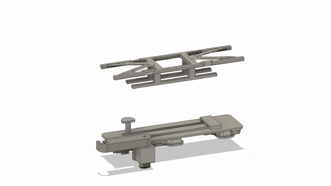

Step 3: Designing the Drop Mechanism With AI🤖
Now, let’s dive into the design of the package-dropping components 📦.
Now stick with me here, because this is where things get exciting 🧐. Designing these components turned out to be both a fun and challenging process, requiring multiple iterations to get just right. The main goal was to create a design that’s easy to assemble, compatible with a wide range of drones, and both robust and practical.
(a few early sketches ✍️)
After finalizing a design robust enough to handle multiple drops, we can now take things to the next level by leveraging, wait for it…
✨AI✨
With the help of AI, we can minimize the material required to produce the parts and optimize flight performance by reducing the component weight to an absolute minimum.
Using Fusion 360’s generative design feature 🤖, we can tackle the weight optimization challenge efficiently.
After considering all factors, I developed the final drop mechanism, which consists of two parts:
- Droke: The component that attaches to the drone.
- Flatch: The part that drops along with the package.
The Droke
The Flatch

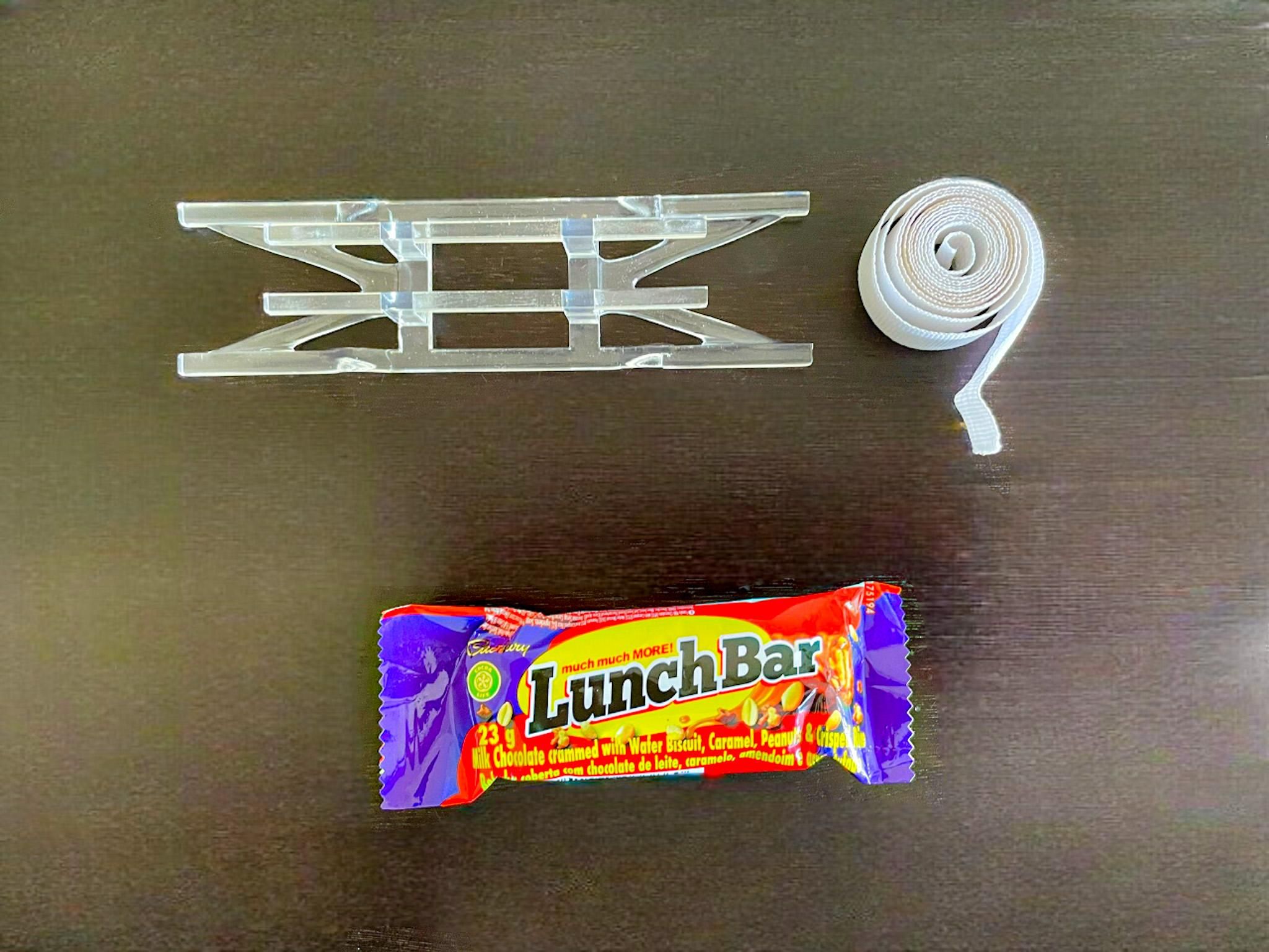

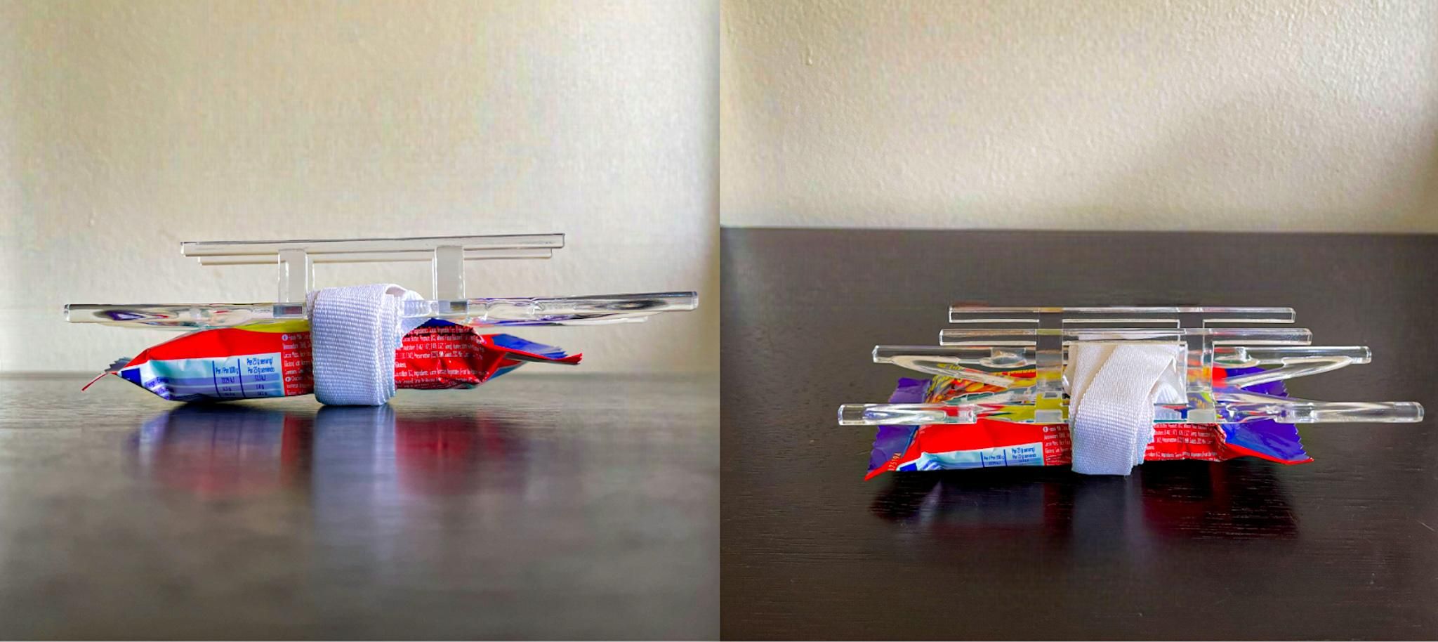

Step 13: Loading The Cargo
Get all your cargo ready 📦. For my test flights, I used a chocolate bar, but you can really attach anything...
You'll need some string to tie it onto the flatch:
You can tie it on like this:
