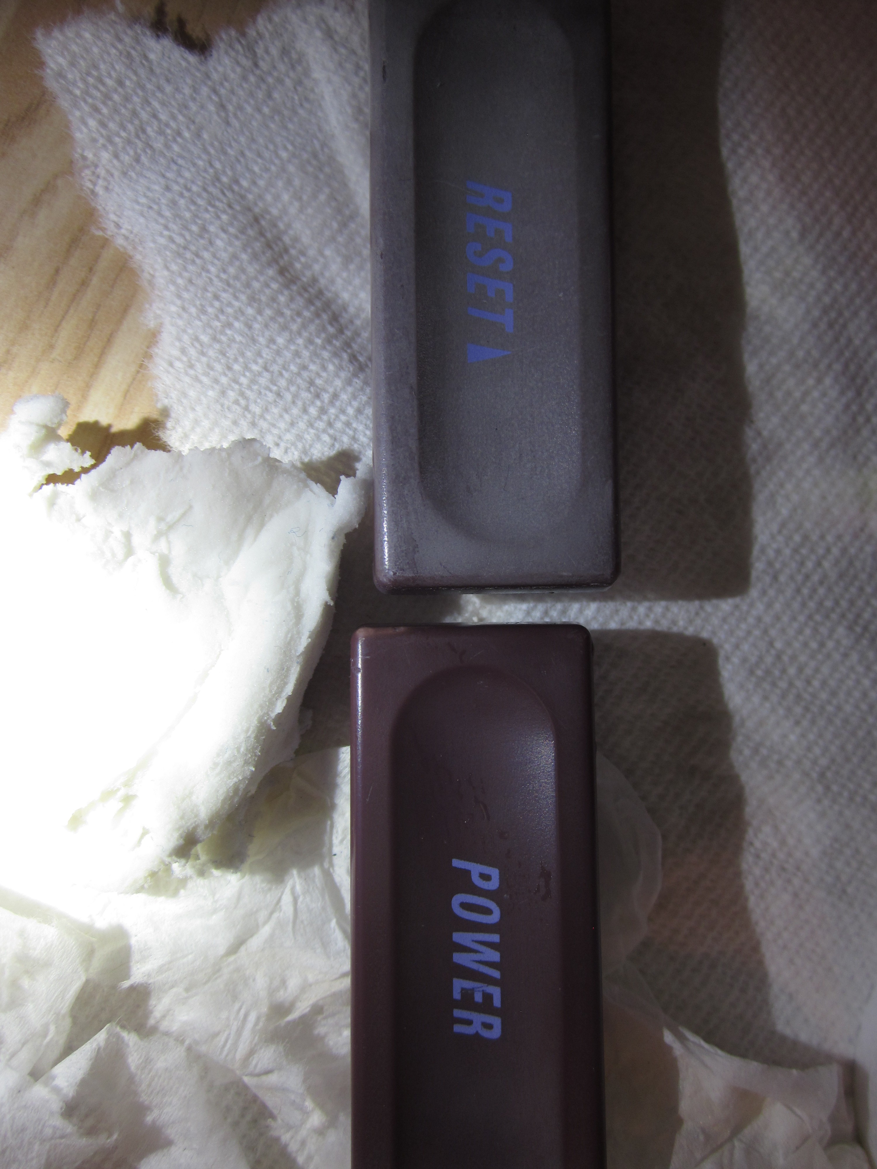

There was one significant fail though; the power and reset keys. The keys were a bit darkened so I threw them into a small container. Everything appeared fine but after I left them to dry a bit, I noticed something terrible. A whitish haze appeared! I tried everything to get rid of it, a magic eraser, vinegar, some diluted bleach and even some automotive plastic polish. Nothing worked. When they're submersed the haze seems to go away but after it's left to dry it reappears! It's likely that a white haze is on the other parts as well but since they're much lighter colored, it's not noticeable. If anyone knows of a fix to this please do tell. In the photo you can see the power button recently taken out looks fine but the reset button which was taken out earlier really shows the haze.
