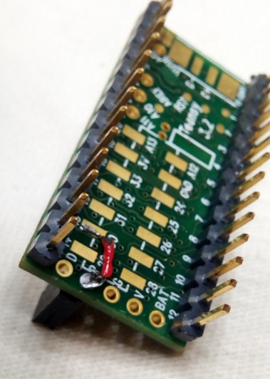

(1) you must remove a small capacitor that is connected to pin 15 on the audio shield.  It’s ok.  Paul added this capacitor to tame signal noise when pin 15 is used with a volume pot, but it’s not really needed.  The teensy native quad device sends out the i2s on pin 15 and it definitely doesn’t work if that capacitor is in place.  You will need to use a different pin besides for the volume control to use the native Teensy Quad Device.
(2) On the teensy 3.2, the second i2s channel RX1 pin is gpio30.   This pin is on the bottom of the teensy 3.2, and so I had to add a jumper and wire to my teensy 3.2 for this test configuration.  The alternative is to use a teensy3.6, which brings the second i2s channel RX1 out to gpio38, which is a “normal” pin on the teensy 3.6.  All my teensy 3.6’s are occupied at the moment, and  It only took a few minutes to solder the jumper on one of my 3.2’s, so the proof of concept is with a teensy 3.2.   I scratched away the connection between the Teensy "program" button and one of the holes on the edge so that I would have someplace to solder a female connector:
