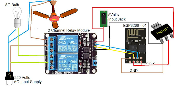

Connecting Appliances with the Device
Here, An extra care needs to be taken as you are playing with AC now. If device installation demands help please ask some professional to help you before doing anything with AC supply.
| Connections |
Connect everything as shown in the image above and make sure connections are not loose.
you can create your own PCB also as it will look more neat and clean.
for using your existing switchboard as earlier with manual button operations too then there are some additional connections to do.
| Final Diagram |
According to above Diagram we are using GPIO1 and GPIO3 as input pins connected to switches. Changing the values of these pin can change the status of relays respectively and at the same time ESP-01 is updating the Blynk server with status of that appliance. So, that user won't get confused about current status of that appliance.
