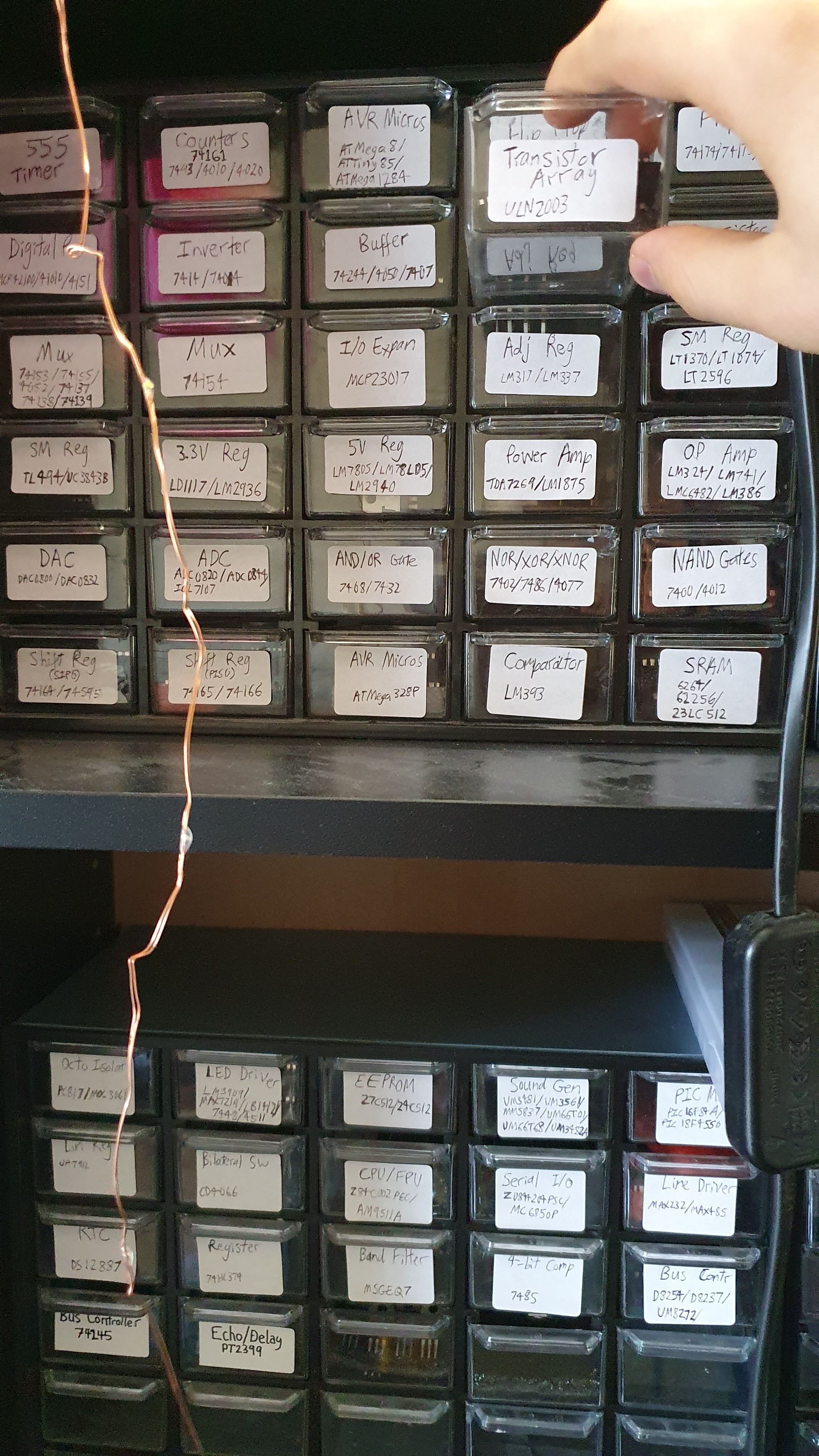

It can take a long time to find a list of them for a prototype.
This is just one cupboard:
So I've come up with a solution: transferring everything into draws and putting lights behind the draws that flash and tell you which draws to search.

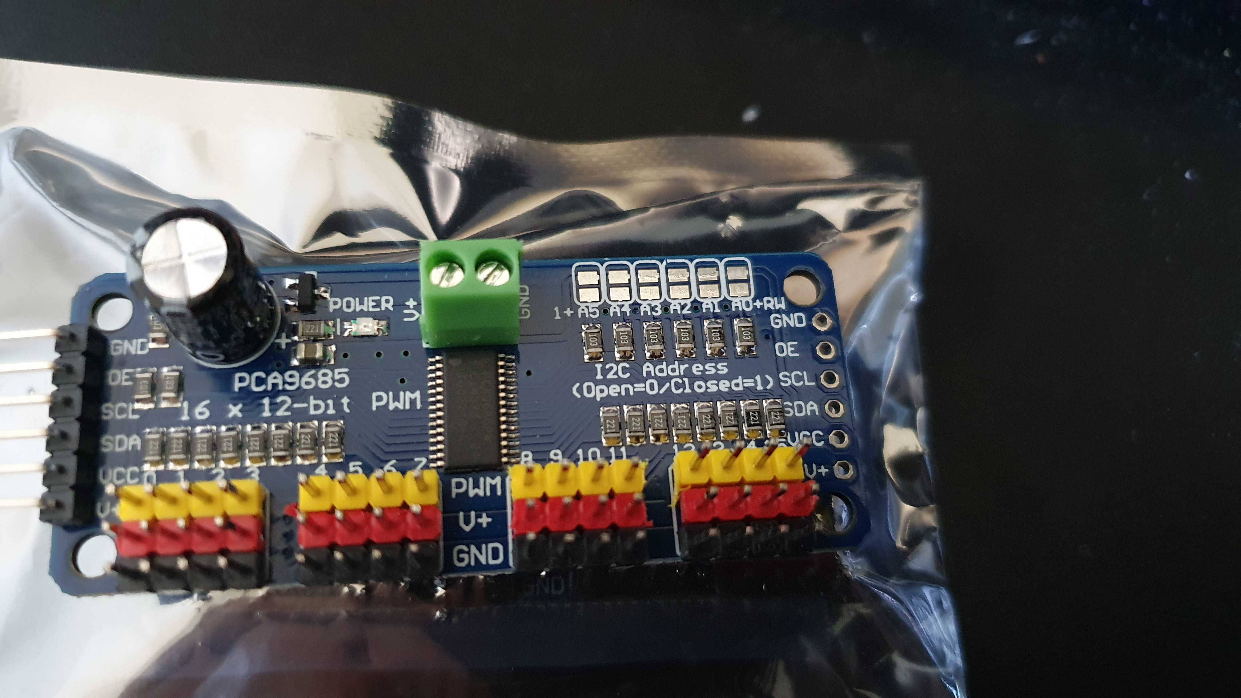

So it turns out getting the version with the headers already installed was a pretty bad idea.
They're all on the wrong side!
Now I'll have to desolder 50+ pins per module.
Or will I?
After engaging my brain for I moment I realised that you can just flip the capacitor and terminals. then install the module upside down and all the pinout remains the same!
Well, I'll have to connect the terminals the opposite way around and the pin numbers are now flipped such that channel sixteen becomes channel one and visa-versa. But that's something fixable in software.

I've just got a few of these little PCA9685 PWM controllers:
That's 16 PWM outputs easily.

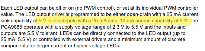

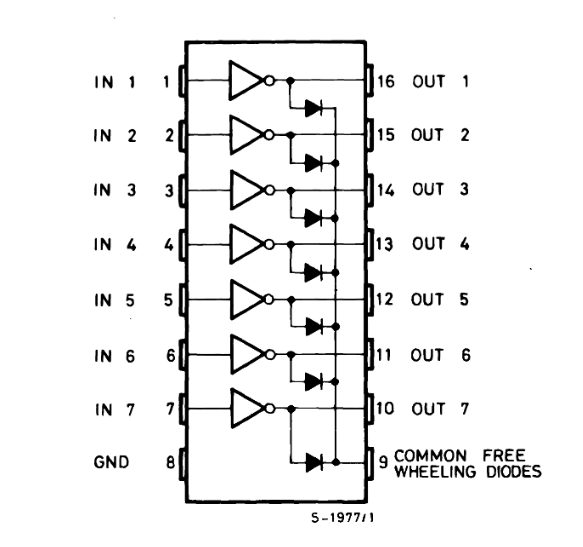

So I'm guessing I can't drive very much current directly off this chip...
No good, I want at least 100mA per channel. That was the limit for the previous version.
Let's see what I have in the workshop.
Ah, perfect.
Looks like that'll support the required 100mA per channel even with all channels running simultaneously and it should be very easy to wire.

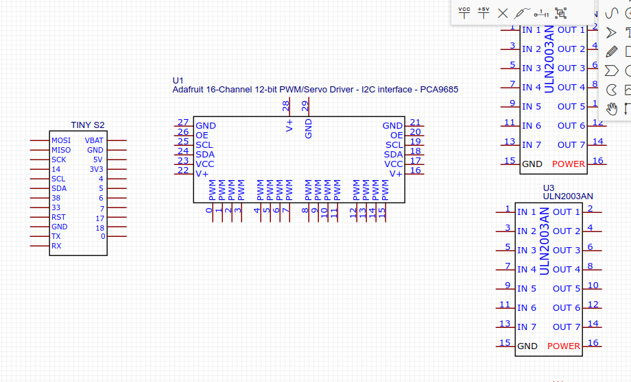

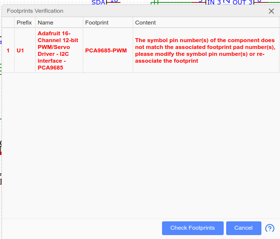

I'll add in a TinyS2 ESP32 module and draw up a schematic for that.
Gotta love these user-supplied components. I'm eternally grateful to the people making these.

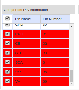

Oh... the problem is just in EasyEDA's imagination anyway. *sighs*
Finally got it after trying a third version of the component design.

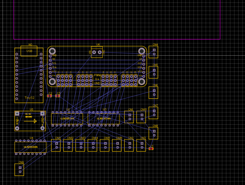

Now let's sort this mess out:

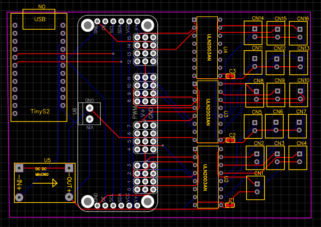

I arranged the headers into a rough grid of threes and put the other component wherever they would fit to form a nice rectangular board with minimal dimensions. I'll give the USB-C power connection a little overhang so it can reach outside the housing.

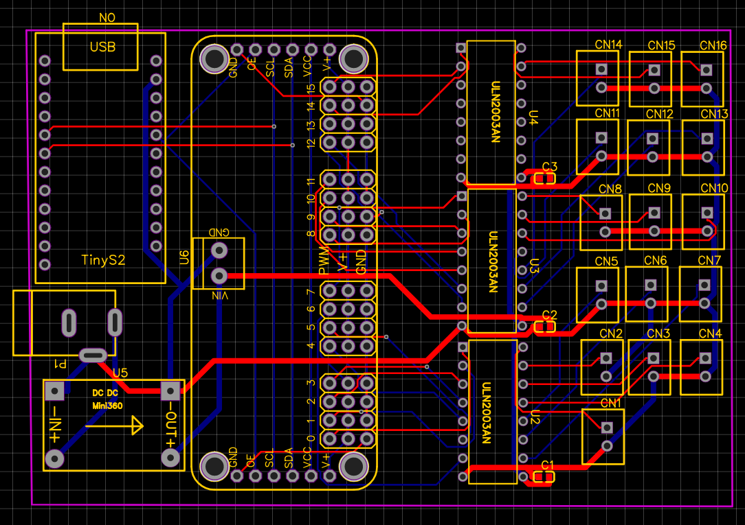

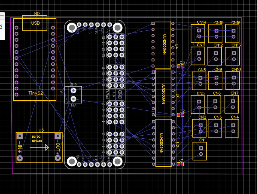

Autorouter, go!
That went better than expected. I forgot this was a dual-layer board. I probably could have even moved them closer together.
But I should probably increase the track thickness for the tracks carrying high currents.
Given the 1.7 Amps, I'd say 0.75mm should be fine.
Then I'll just wire that to the TinyS2... oh huh.
I've added a barrel jack to power the board instead, I'll just plug in a 12V supply.
