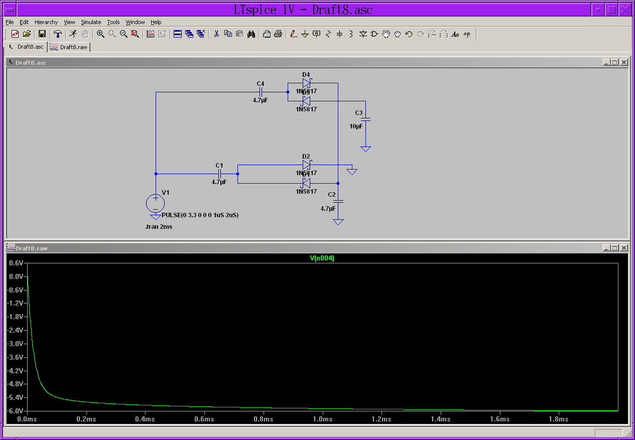

How to get -5V from a 3.3V square wave
02/02/2018 at 23:48 • 0 comments![]()
A cockroft-walton generator configured for going down instead of up. Unlike a charge pump, it only requires a single input.
