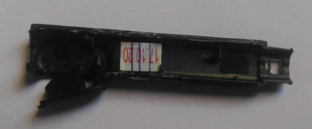

Yet again all of the housing for the control module was glued together. The two end caps could be popped off first, followed by prying open the housing with a craft knife.

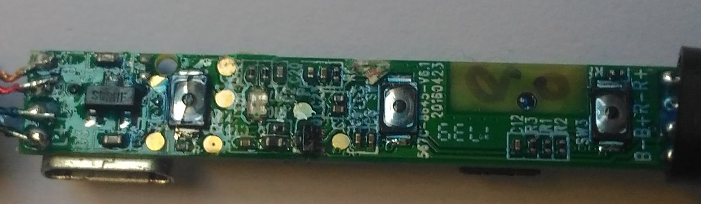

The inside revealed a very sleek tight PCB design on one side and the tactile buttons & a simple small light pipe on the other. The other side of the housing contained a small piece of marked foam pushed up against the MCU of the PCB to dampen any vibrations (which may also help the microphone performance?).
The Guts
- CSR audio SoC (https://www.qualcomm.com/products/csr8645. DS:http://www.czwtech.com/uploadfile/cfile/20121224103629171.pdf) w/ in-built LDO/SMPS
- FM24CL64B Cypress FRAM SOIC-8 (https://www.cypress.com/file/41656/download)
- Blue 2.4GHz antenna component. Likely has inbuilt bandpass filter for the ~2.4GHz. Ground stitching has been around the
- Inductors (for PS or antenna or mic?)
- A microphone with marking (2008\n7936)
- Micro-USB port
On the other side...
- R/B LED + transistor driver
- Snap dome buttons
- Potentially a MOSFET/diodes for the USB power?
The space constraint on this PCB is huge the DRC has allowed components to be extremely close to the edge of the PCB. I did often experience audible interference with the headphones whicch could be due to the smalll antenna configuration. Overall an extremely tight design and super well laid out boards.
