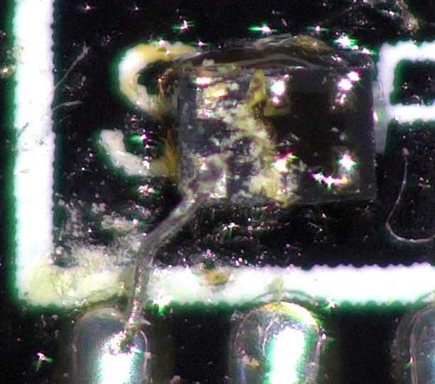

How to solder a 1 mm x 1.5 mm, 6 pad USON package IC

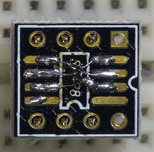

06/22/2018 at 16:51 • 3 commentsThis page describes how I tested a TPS3420 reset chip on a breadboard. First I glued the chip in dead bug style on a SMD adapter board:
Then I tinned the pads of the IC and of the SMD adapter (the pink things at the left side are my fingers) :

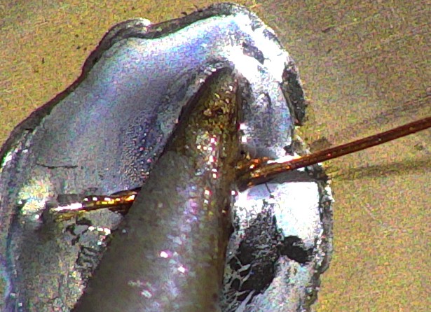

For connecting the pads of the IC to the pads of the adapter, I used enameled wire, AWG 36 (0.12 mm diameter) :

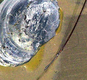

To remove the enamel, I used a scrap board and some more tin. The lacquer melts after some time and the wire gets tinned as well:

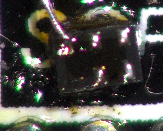

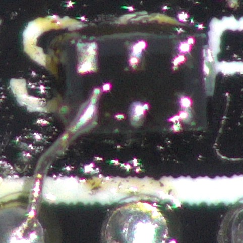

Then I soldered one side of the wire to the SMD pad, first, and cut it to length. The scratches on the IC are in the flux residue, when I tried to position the wire with a scalpel. You need eagle eyes or a good microscope to do this.
Then I soldered the other end the IC pad:
If you move the soldering iron to strong, or apply too much heat or for too long, pads disappear, as happened for me. Buy some spare part.

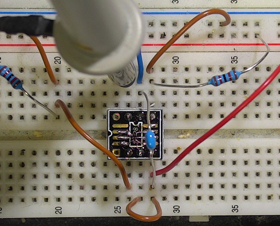

Finally I plugged in some pin headers in a breadboard and placed the SMD adapter on it. This guarantees that the pin headers are straight when soldering.
Connected in a testing circuit:

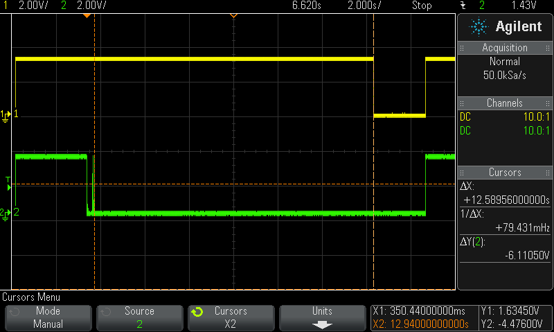

Testing: green is both button inputs and yellow is the reset output.
As specified in the datasheet, reset triggers after holding down both button inputs for 12.5 s, with TS=VCC configuration.
