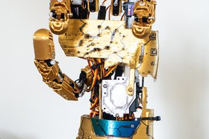

This bionic hand uses an arduino nano V3 to controll 7 servo's. The hand is modelled after my hand so I could make a mold that fits over it.

Hi Brian, I had some servos plugged incorrectly.. and I think thumb rotate servo should have a stop on it..just spins for now so will work on it. I have posted a picture of my copy of your great design.. in "I built it" cheers Gary
Hi Brian, not sure if you still look at these comments, but I have built your project recently and am finishing off the springs and outer two servos for the Thumb. I will have to check the code supplied as some finger servos move on initial power up but none of the switches move the fingers. One switch allows a binary pattern on the leds as I press it..but that is all. Is there another version of the .ino file please?
Hello Gary, the first button indeed selects the desired program and this is displayed with a binary pattern on the LEDs. The second button excecutes the selected program. Did you wire everything up according to the circuit diagram provided on this page? Sounds to me you might've missed the connection from the ground of the servo's to the ground of the Arduino. Could you check this for me and let me know?

I have made the PCB for the hand the same as yours, not using the expansion I/O board now . this is my third attempt second on perf board. I can get the switches working and the LED's switch modes, but I cant get the servos to operate. as you said I have used two power supplies, one to the Nano and the other to the servos.
The first attempt the Nano got so hot but not a wiring problem ???
The second attempt was on hookup board this runs cool led's and switches work etc. but still no servo moment.
Can you tell me poss why and what do all the switches do.
Is there a mode that operates each finger manually.
Mike

Hi, Thank you for the really great design! I am trying to make this project but the bottom joint of finger I have printed out doesn't seem to have anything to stop it when it is straight. I.e. it goes all the way back when you pull the string to straighten it. Is there any way to stop it doing this please?
I used a piece of wire glued to both ends to stop it from going to far

Hi Brian..all working, thank you! I had wired my momentary switch's S1 and S7 90 degrees out on the veroboard, so pressing them did nothing....doh! I can send you some pictures if you are interested cheers Gary
