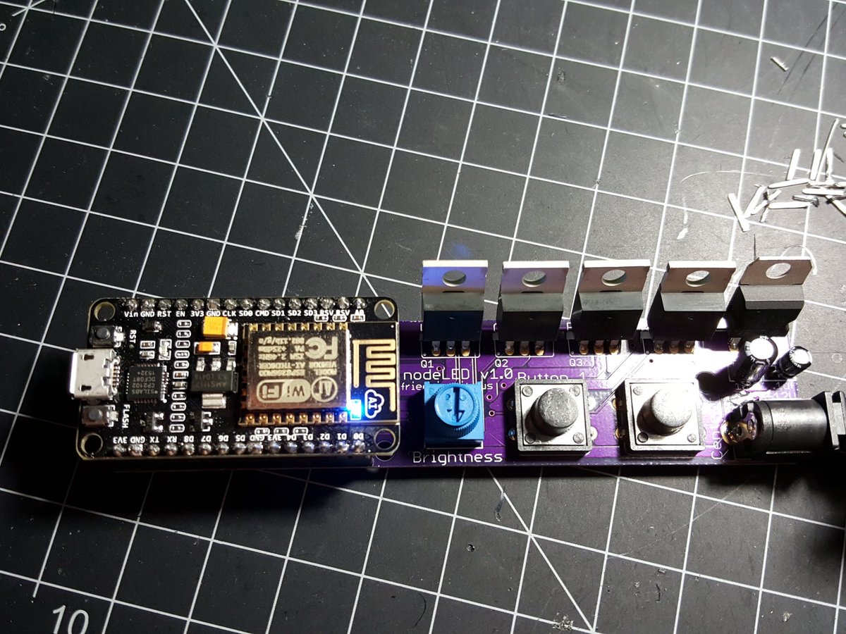

As a hacker, I know all too well how much workbench space is vital. Alongside my three monitors, I have an extended desk that houses my soldering irons, compartment shelving, and countless projects, amongst other tools and devices. One constant that seems to get in my way is an old desk lamp. That’s where this project came to light, ha! I decided to design my own lamp using an analog RGBW LED strip. This board I designed will give you the tools to design your own WIFI controlled light source.
The board’s controller is run by the NodeMCU which is connected to a N-Channel MOSFET for each color of the RGBW LED strip. Trimpot for brightness and 2 user buttons (that can be setup to change modes, possibly) were also added. A 5v regulator was then added so the power can be shared with 9-12v input for the LED strip. The nodeMCU will be wirelessly updatable as well.
My idea is to have the nodeMCU be a web server for direct control via a web page. The site will have various configurations including color options, number of channels, animations (like fade effects) and a timer. I’d like to have it connect to MQTT server to integrate with larger servers such as openHAB.

    This past weekend I had a chance to demo the nodeLED at the MakerFaire Hackaday meetup and at OSH Park’s Bring-A-Hack. I wasn’t sure if I would have power, so I decided to use a 7.4V LiPo I had from an old project. It wouldn’t be full brightness but enough to demo. During the first meetup, I left it running on the table but after some time passed, I noticed it was off and the regulator was quite toasty. I quickly unplugged it. Dead battery was my initial reaction. Especially after I had plugged it in again, the esp8266 LED seemed to flutter and go out. But by using the handy USB Tester with the DC Tester, I could tell the battery wasn’t dead because it dropped straight to <1v when plugged into the nodeLED. So something else was going on if the battery cutoff was triggering. Also, I didn’t get to demo it at the Bring-A-Hack! Bummer!
    I can’t leave a problem unsolved so upon arriving home from the weekend away, I tested the nodeLED with a 12v wall-wart. Um yeah, I about burned myself on the regulator! I should've known better, especially if the battery was cutting out. I also noticed if I plugged the nodeMCU into my computer, the onboard user LED would only illuminate very dimly, also becoming a bit toasty.
    Following up a couple of days later, I did some more testing and I could tell that the nodeLED itself is fine; the regulator is healthy. The problem lies with the nodeMCU, which is very strange. I plan on investigating the cause further, but for now, and in the interest of time, I will have to use another nodeMCU. Good thing I have extras!

    The PCB has finally arrived and I can start testing and writing code. Here are some pictures of the PCB and a simple LED color test.
