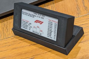

Real thermometers has ethernet
90% copy paste mocked up code from Arduino examples. And a small custom shield for the DS18S20 and 1602 LCD.
This replaces my China Temper USB (Laboratory, LOL) indoor thermometer that was running using questionable third party software from sourceforge to upload measurements to my webserver which is programmed as a "brain" for my home automation system. I'm using an RFXcom usb tranceiver to talk to my EMW100R switches running both lighting and heating in my rented house.
Software may get some updates.
