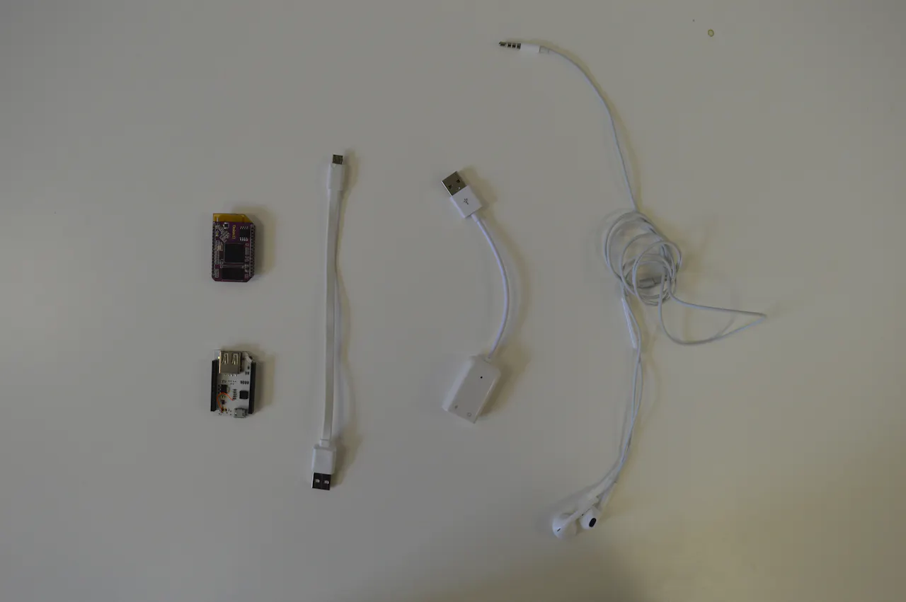

In this tutorial, we will go through how to make Omega as a airplay music player.
Connect all the components as shown:
2A) If avahi-nodbus-daemon is already installed on the Omega, we have to uninstall it:
opkg remove avahi-nodbus-daemon --force-depends
2B) Update opkg:
opkg update
2C) Install avahi-dbus-daemon:
opkg install avahi-dbus-daemon --force-overwrite
$ opkg install shairport-sync
