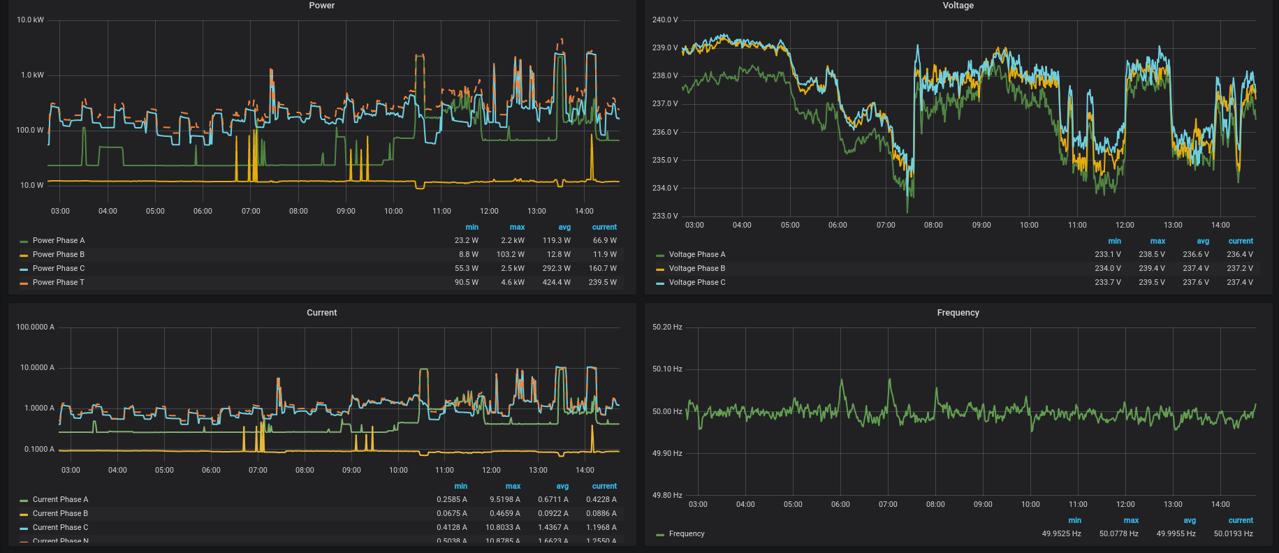

The ESP8266 provides measurements on http://<IP>/metrics in an InfluxDB compatible format:
threephase,loc=main,phase=A,name=voltage_rms value=236.86 threephase,loc=main,phase=B,name=voltage_rms value=237.57 threephase,loc=main,phase=C,name=voltage_rms value=237.77 threephase,loc=main,phase=N,name=current_rms value=1.265 threephase,loc=main,phase=A,name=current_rms value=0.42240 threephase,loc=main,phase=B,name=current_rms value=0.08956 threephase,loc=main,phase=C,name=current_rms value=1.20591 threephase,loc=main,phase=T,name=power_active value=0.24127 threephase,loc=main,phase=A,name=power_active value=0.06691 threephase,loc=main,phase=B,name=power_active value=0.01197 threephase,loc=main,phase=C,name=power_active value=0.16239 threephase,loc=main,phase=T,name=power_factor value=0.590 threephase,loc=main,phase=A,name=power_factor value=0.668 threephase,loc=main,phase=B,name=power_factor value=0.562 threephase,loc=main,phase=C,name=power_factor value=0.565 threephase,loc=main,phase=N,name=frequency value=50.000 threephase,loc=main,phase=T,name=total_energy value=X threephase,loc=main,phase=A,name=total_energy value=X threephase,loc=main,phase=B,name=total_energy value=X threephase,loc=main,phase=C,name=total_energy value=X
This data is gathered every 10 seconds by a Telegraf instance and stored in an InfluxDB database, both running in Docker containers on my Raspberry Pi 3. To improve reliability and write endurance over the Pi's SD card, I use a WD Green SSD as a boot drive.
Data exploration is made possible by Grafana, which resides in another docker container, connects to the database and hosts a webpage allowing you to create beautiful dashboards such as this
As of now, the database contains around 15 million points and despite taking longer for large queries, the Pi handles this amount of data without a problem and plenty of power to spare, allowing for future expansion.
