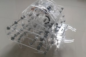

I used the Primus X flight controller board to manoeuvre an extremely agile hover-craft frame I designed.
A hover craft that uses the drone sensors to stabilise and maintain ground autonomy. Its smooth and extremely agile on all terrains .
The hover cradt uses two motors for thrust on the X and Y axis while four motors use thrust on the Z axis to maintain a smooth and table
hover.
A basic 3D printed hovercraft frame that I designed on a 3d modelling software .
I put 7 mm DC brushed motors as the actuators with 55 mm bi-blade props.
The setup is a 1s 3.7v setup that used a 600 Mah battery with a disharge rating of 45C. Its an agile setup thats extremely fun to handle .
I used the Primus X flight controller to mimic the drone stabilising features to easily control the craft.
I added two extra motors that I used on the ports supporting H bridge to get the reverse function by reversing the prop spin .
I used the simple API based SDK that was offered with Primus X called Cygnus IDE .

  • 1 × Fusion 360 3D modeling software
  • 1 × 3D printer MK2 Prusa printer
  • 1 × PrimusX flight controller
  • 1 × Cygnus IDE API based SDK
  • 1 × 7mm brushed DC motor actuator
View all 7 components
  • 1
    Step 1
    Ideate and draw out design. 3D model the design to perfect scale.
  • 2
    Step 2
    Print out the design and mount the flight controller , motors , propellers and battery.
  • 3
    Step 3
    Use Cygnus IDE to code in the simple changes in the firmware and flash the new firmware.
