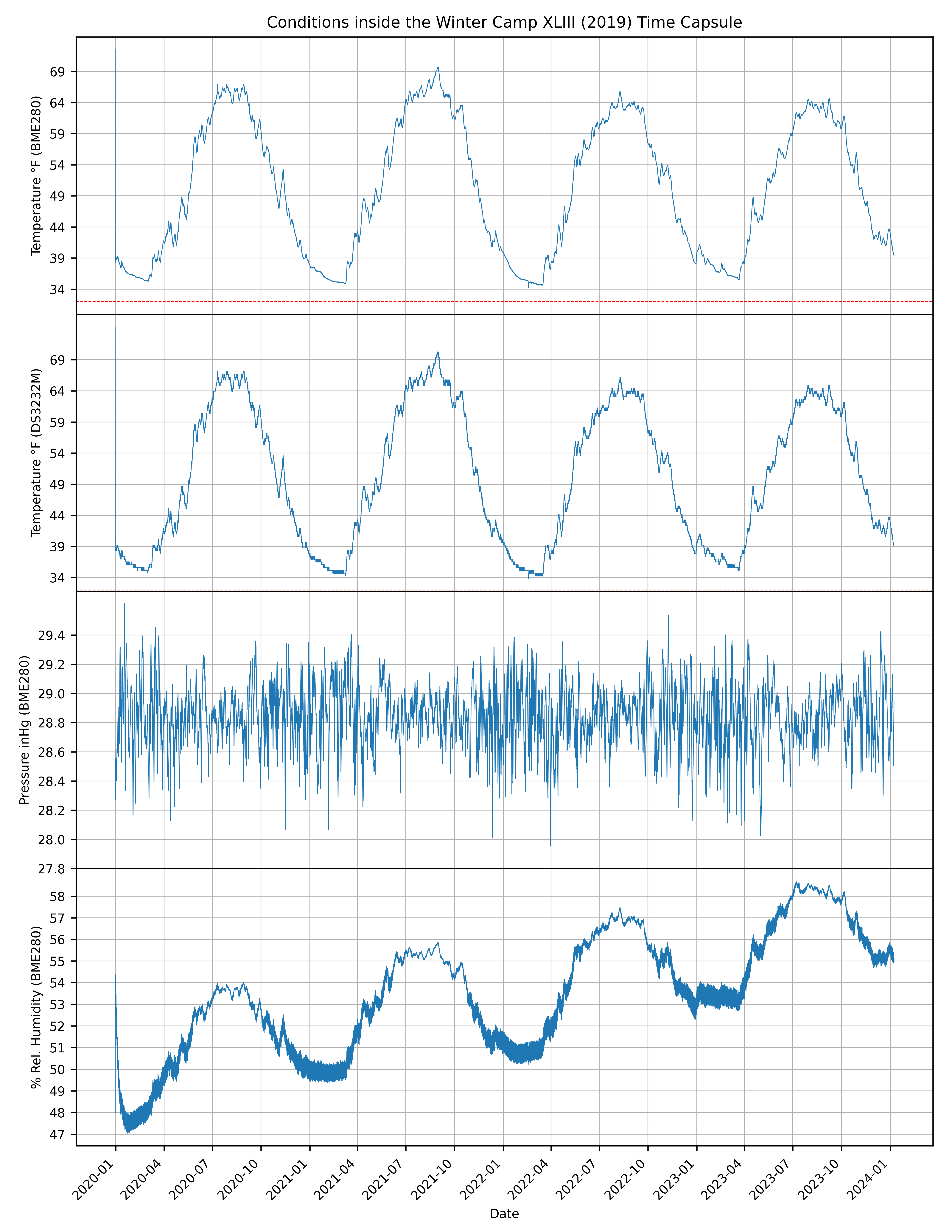

    Ok, so how long did it last? Well, first I had to make something that would show me the data after it was dumped out over the serial port. I always found working with plots in Matlab confusing, and now that I'm out of school I use python's MatPlotLib instead, and it's also confusing. Is satisfying when you finally get it right though; here it is:
    Actually, I already messed up; it's supposed to say "Winter Camp XLII".
    Looks like it lasted a bit over 3.5 years; 33471 hourly samples. I do have a control unit which I check up on once a year; it too was dead this July after 35553 hourly samples. Perhaps my lifetime calculation are a bit off, and I'll need to install a bigger battery next time. Current life is kind of ok for this part of the project - since the time capsules are staggered by 1 year, there should always be coverage, even if one unit fails.
    I have to believe the temperature readings are fairly accurate, since I have two sensors for that which agree quite well (the BME280 and the internal thermometer in the DS3232M real time clock). Looks like the capsule gets down to just above freezing (the red line) in the winter, and goes up to a cool 65F in summer. Very reasonable.
    How about the barometric pressure?...
