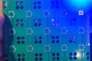

The FPGA generates an SPI clock and data signal to each LED panel. The signals are immediately fed from a simple shield to another custom PCB with RS485 transmitters shown above. The transmitter chips output differential signal pairs that pass easily in ethernet cords over 20-30 feet to each panel location. At the LED panel, the signals are received with transceiver chips back into clock and data lines and connected to their respective LED panel. This custom PCB also has a small DC-DC voltage transformers that take a 45VDC buss down to the 5V required for the LEDs.  The below PCB has tranceiver chips and three DC-DC transformers serving 3 LED panels. Thanks to the hardware maverick Tom Moxon with Pattern Agents for help designing this circuit.
The led panels themselves are little more than strip LEDs that have been connected together.  We had them customized for our particular geometry by our favorite supplier Raywu.

The transmitter board takes two SPI signals (Clock and Data) and passes the signals through an RS485 transmitter chip. The differential signals are routed to an ethernet jack. This board could have been integrated into the Mojo shield to reduce noise but my disigning, programming, prototyping, and installing timelines compressed the schedule and I had to learn as I went. Oshpark transmitter chip: Texas Instrument AM27LV31 296-24690-1-ND RJ45 ethernet jack: 380-1316-5-ND

The receiver board receives RS485 signals via a RJ485 ethernet jack. Converts the two differential pairs back into clock and data SPI signals and connects to one LED panel. The board also has a DC-to-DC converter that takes 45V to 5V to supply to the LED panel. I did not put the TVS protection diodes on the boards but added them on just the last few boards I made when troubleshooting noise issues. Also, in addition to the 120ohm termination resistors on the RS485 bus, the original boards have 4.7k pullup and pulldown resistors on the bus. Modern RS485 chips have whats called "failsafe" against idle(no Data) conditions that these resistors are meant to deter.... so I left them out of these last few single signal boards shown here. Oshpark
