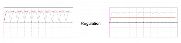

Step 3: Filtration
The output after the Rectification is not a proper DC, it is oscillation output and has a very high ripple factor. We don’t need that pulsating output, for this we use Capacitor. Capacitor charge till the waveform goes to its peak and discharge into Load circuit when waveform goes low. So when output is going low, capacitor maintains the proper voltage supply into the Load circuit, hence creating the DC. Now how the value of this filter capacitor should be calculated. Here is the formulae:
C = I*t/V
where, C = capacitance to be calculated; I = Max output current (let’s say 1000mA or 1A); t = 10ms,
We will get wave of 100Hz frequency after converting 50Hz AC into DC, through full wave bridge rectifier. As the negative part of the pulse is converted into positive, one pulse will be counted two.
So the Time period(t) will be:
t = 1/100 = .01 second = 10ms.
V = Peak voltage – voltage given to voltage regulator IC (+2 more than rated means 5+2=7)
12-0-12 is the RMS value of transforms so peak voltage is:
Vrms * 1.414 = 12 * 1.414 = 16.968V
Now 1.4v will be dropped on 2 diodes (0.7 per diode) as 2 will be forward biased for half wave.
So, 16.968 – 1.4 = 15.568V
When capacitor discharges into load circuit, it must provide 7v to 7805 IC to work so finally V is:
V = 15.568 – 7 = 8.568V
So now, C = I*t/V
C = 1000mA * 10ms / 8.568
= 1 * .01 / 8.568
= 0.001167134 ~ 100uF

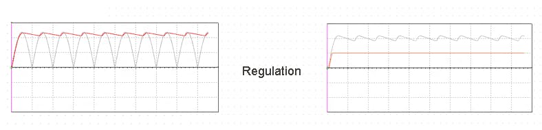

Step 4: Voltage Regulation
A voltage regulator IC 7805 is used to provide a regulated 5v DC. Input voltage should be 2V more than the rated output voltage for proper working of IC, means at least 7v is needed, although it can operate in input voltage range of 7-20V. Voltage regulators have all the circuitry inside it to provide a proper regulated DC. Capacitor of 0.01uF should be connected to the output of the 7805 to eliminate the noise, produced by transient changes in voltage.
