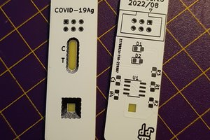

Hackaday.io Hackaday.io
Sign up Log in
Pico555
Breaking the stigma that soldering 0402 parts is hard by dead-bugging a chip scale DSBGA packaged 555 timer with 01005 parts
twiresTWires
Following Follow project
Liked Like project
Become a Hackaday.io member
Sign up with Github
Sign up with Twitter
OR
Forgot your password?
Just one more thing
Pick an awesome username
hackaday.io/
Pick a few interests
Choose more interests.
OK, I'm done! Skip
Join this project
7.4k views
9 comments
25 followers
37 likes
  • Description
  • Details
  • Files 0
  • Components 5
    • View all
  • Logs 0
  • Instructions 0
  • Discussion 9
View Gallery
7.4k
9
25
37
Team (1)
  • twiresTWires
Join this project's team
  • Mikeselectricstuff blinker
  • Ted Yapo on 555's
  • Project video on youtube
completed project
555 soldering DSBGA Blinkie smd
Related lists
Featured Projects
Featured Projects on Hackaday.io
This project is submitted for
  • Hackaday.com Tip Line
This project was created on 04/09/2019 and last updated 7 years ago.
Description
It al started when I found the LMC555CTP on Farnell, a 555 timer packaged in a chip scale DSBGA 1.4x1.4mm housing. Quite soon after that, mikeselectricstuff posted a small blinkie based around a supercap and microcontroller, I could do that with an 555! Then recently Ted Yapo made an article about the 555 in which he wrote "dead-bugging the DSBGA version would be quite a feat" This all concluded in me dead-bugging this blinkie together.
I started by creating a dead bug style schematic. I flipped the chip and stuck it down to some tapes because physics get weird once you get to chip scale. I then started putting on the 01005 passive components which was quite easy with a JBC C105101 tip. the hardest part came up next, making the wire bridges. If you heat up one of the sides, the other side instantly also heats up. Next up I put the capacitor underneath and soldered the 0201 LED on. I charge the circuit up to 3V and it will blink for about a minute.
Details
Components
  • 1 × LMC555CTP Clock and Timer ICs / Timer ICs
  • 1 × RC0100FR-0710KL 01005 10k resistor
  • 1 × CRCW01001M00JREL 01005 1M resistor
  • 1 × APG0603SECTT 0201 LED
  • 1 × CPH3225A Capacitors / Electric Double-Layer (EDL)
Log In/Sign up to comment
Become a Hackaday.io Member
Sign up with Github
Sign up with Twitter
OR
Morning.Star wrote 04/27/2019 at 05:56 • point
Damn, dude. :-D
salec wrote 04/10/2019 at 14:55 • point
I see the IC layout is visible. Is it supposed to be covered with epoxy by user (builder) after placing? Is there a danger of accidentally connecting to internal nodes of the circuit?
TWires wrote 04/10/2019 at 15:47 • point
It seems like there is an electric isolating layer over the bare die, it doesn't take much mechanical force to damage it though. The exposed die can be problematic when it comes to photo-electrics. Dave did a nice video on that, https://www.youtube.com/watch?v=SrDfRCi1UV0
salec wrote 04/10/2019 at 14:42 • point
Superb! How do you steady your hand, working on such a small scale? And how much space you have between microscope objective and, ... well, objects?
TWires wrote 04/10/2019 at 15:42 • point
Thanks, I steady my hand by supporting my fingers as close to the chip as possible, i kind of create a leverage which acts as an attenuator for my movements. I have about 100mm working distance with my quite basic stereo microscope, I have included a picture of my setup in the project. I would like to film and explain how I solder this but i don't have any means to film and solder at the same time.
salec wrote 04/10/2019 at 16:49 • point
10cm, it is quite a lot. I thought microscopes needed smaller distances (judging by ones we used in biology classes back in school)
Barry Callahan wrote 04/11/2019 at 14:43 • point
You're not trying to get nearly the same level of magnification when you're soldering as when you're trying to look at something on the cellular level. The stereo scope on our bench only goes up to x4. For biology, you really want to get up in the 100s - 1000s of magnification.
Ted Yapo wrote 04/10/2019 at 10:30 • point
Amazing work!
deʃhipu wrote 04/09/2019 at 14:43 • point
Well done!
You could do it with a raspberry pi ;-)
Idea of combining shaped printed circuit boards, Acryl and LEDs to create a PCB art object.
Project Owner Contributor
Hot Air Balloon Animated Color LED Lamp
yaroslavYaroslav
Idea of combining Acryl and LEDs with printed circuit boards to create a PCB art object.
Project Owner Contributor
ATOMPUNK ROCKET LAMP MADE OF BARE PCBS AND LED-LIT
yaroslavYaroslav
Astable multivibrator, but with 5 branches instead of two.
Project Owner Contributor
Pentablinky
michimartinimichimartini
Step by step instructions for our Learn to Surface Mount Solder board.
Project Owner Contributor
SMT Garden
alpenglow-industriesAlpenglow Industries
Going up?
© 2026 Hackaday
Yes, delete it Cancel
You are about to report the project "Pico555", please tell us the reason.
Send message
Remove Member
