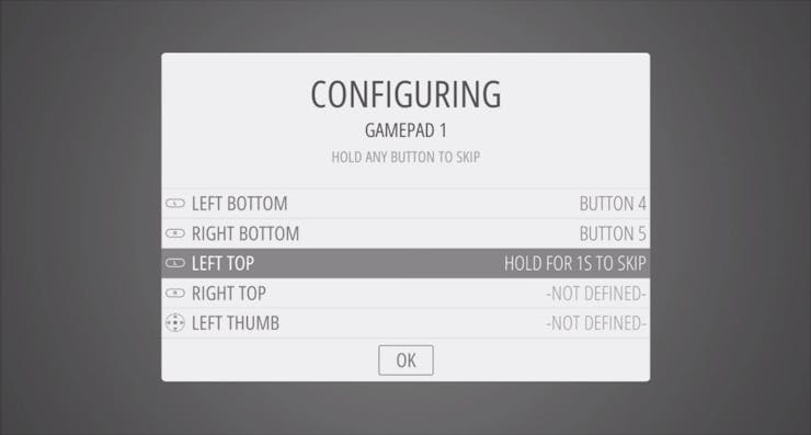

    Game Controller
    If you see this screen, you can hold any button on your Game Controller to enter Configuring screen.

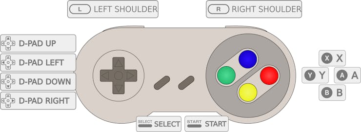

    In Configuring screen, you can refer the picture below to configure buttons. The button unused in Configuring screen, can be skipped by hold any button.

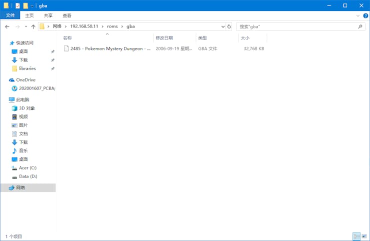

    Upload game ROMs
    Open Windows Explorer in your PC, type "\\yourraspberrypi_ip" in address bar, and you can copy game ROMs to roms floder now.
    For example, we copied a Pokemon's rom file to roms/gba folder.
