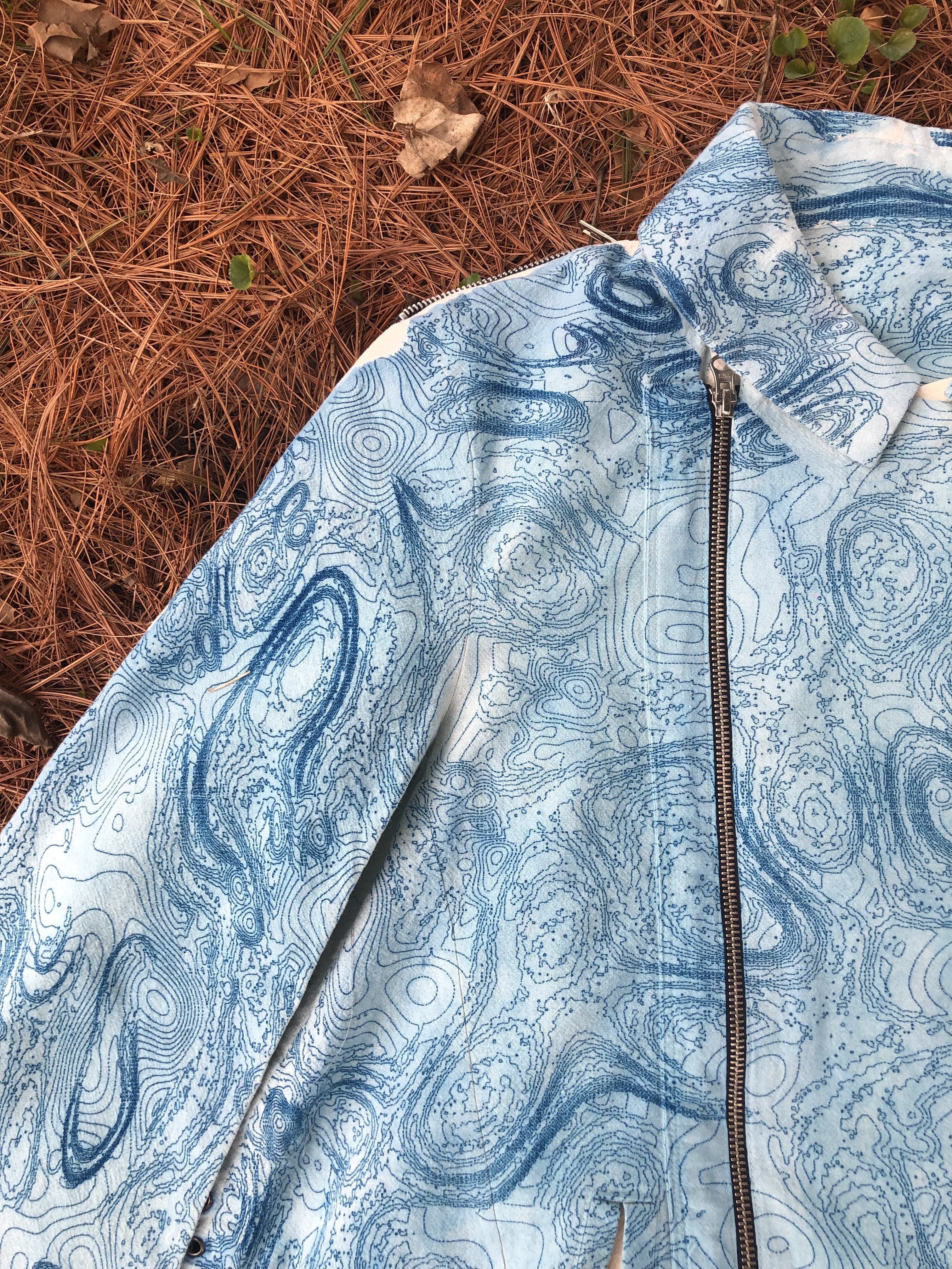

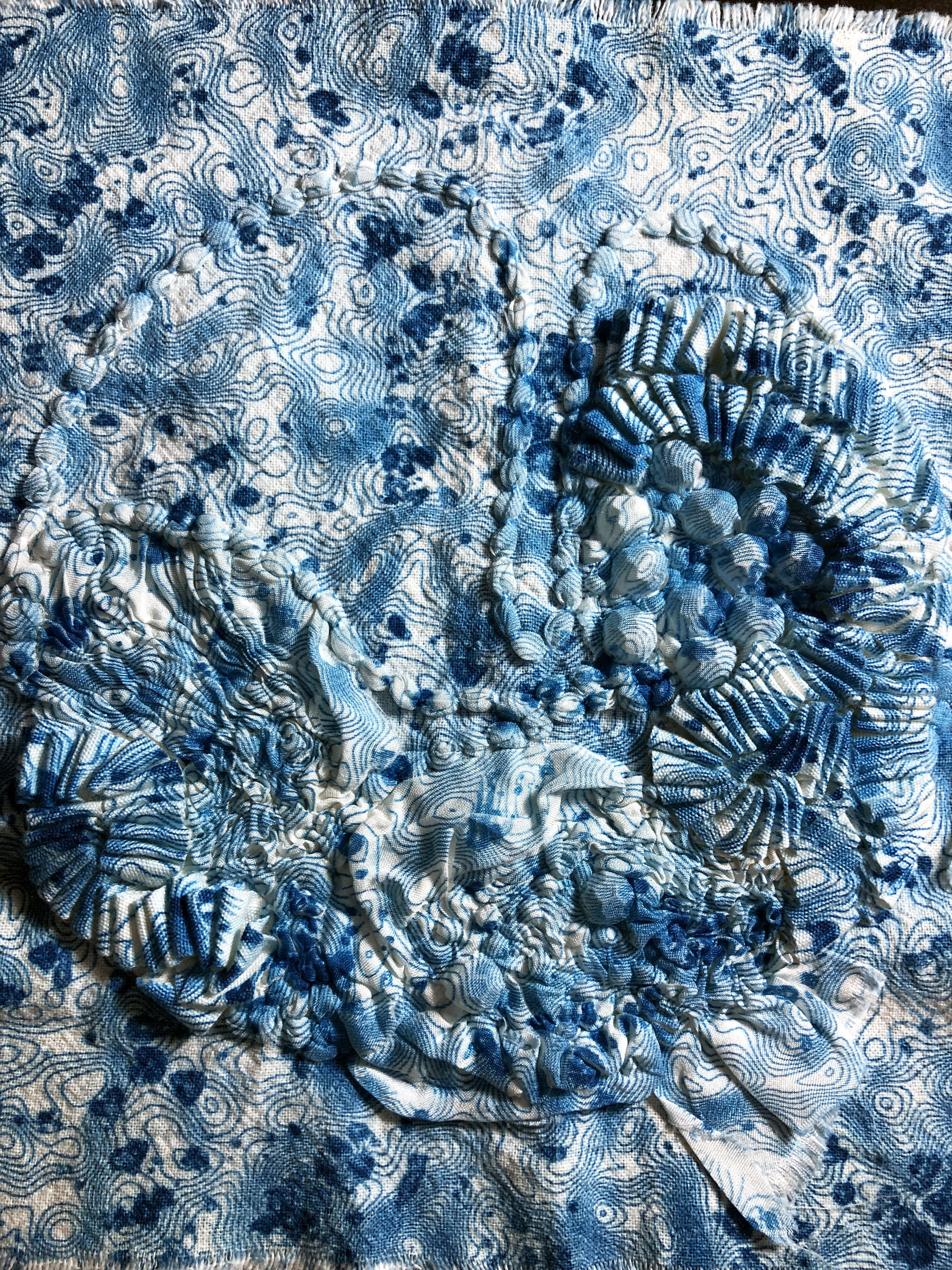

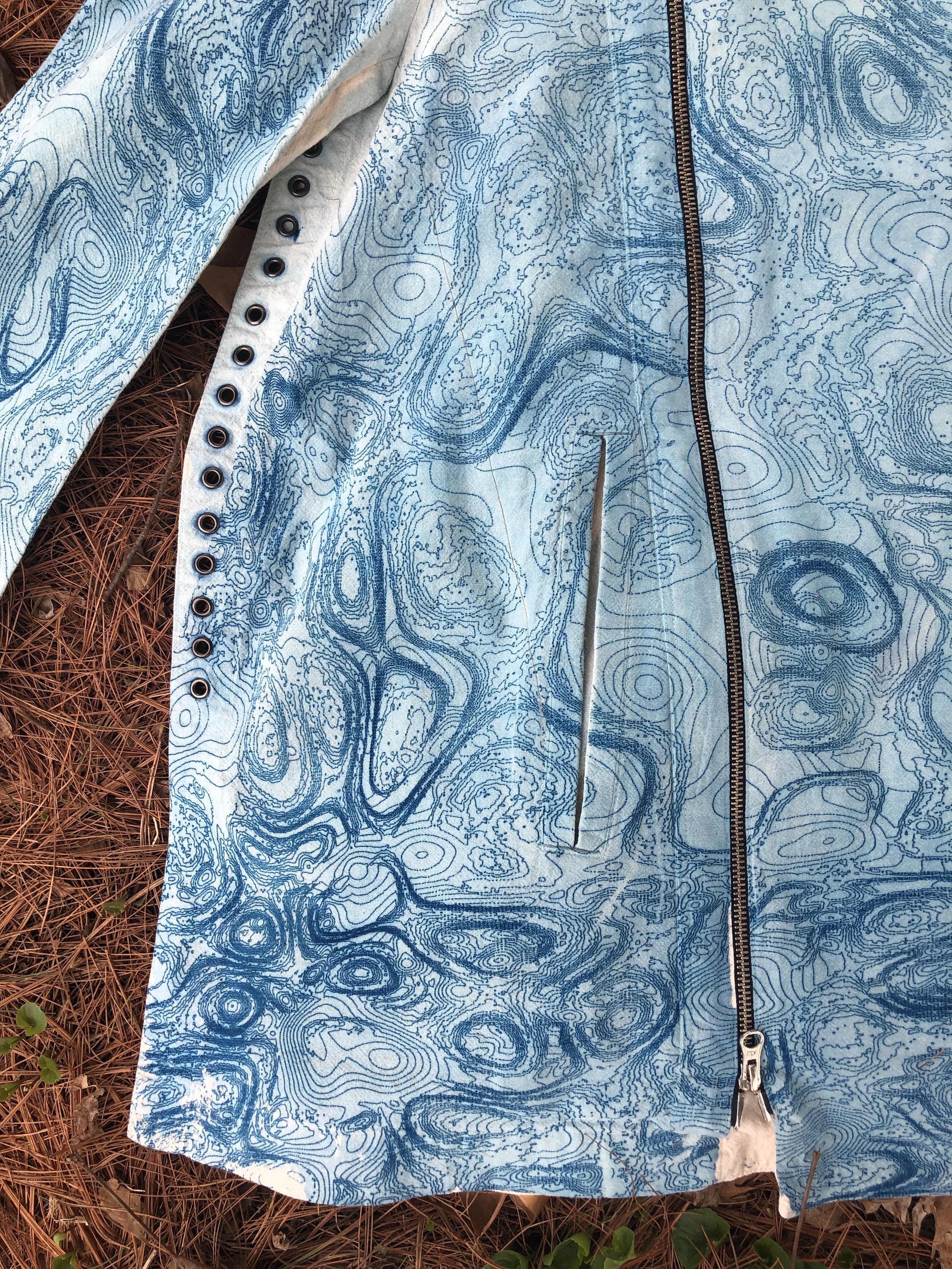

The Laser Dye Project merges alternative photography with digital fabrication by producing New Cyanotype and Vandyke Brown on sewn garments made from natural fibers or delicate, uneven organic substrates. Using maskless laser exposure with a DIY programmable laser galvanometer system, the process translates light directly onto fabric without the need for physical masks. This approach not only allows large-scale exposures but also enables multi-angle printing with several laser machines.

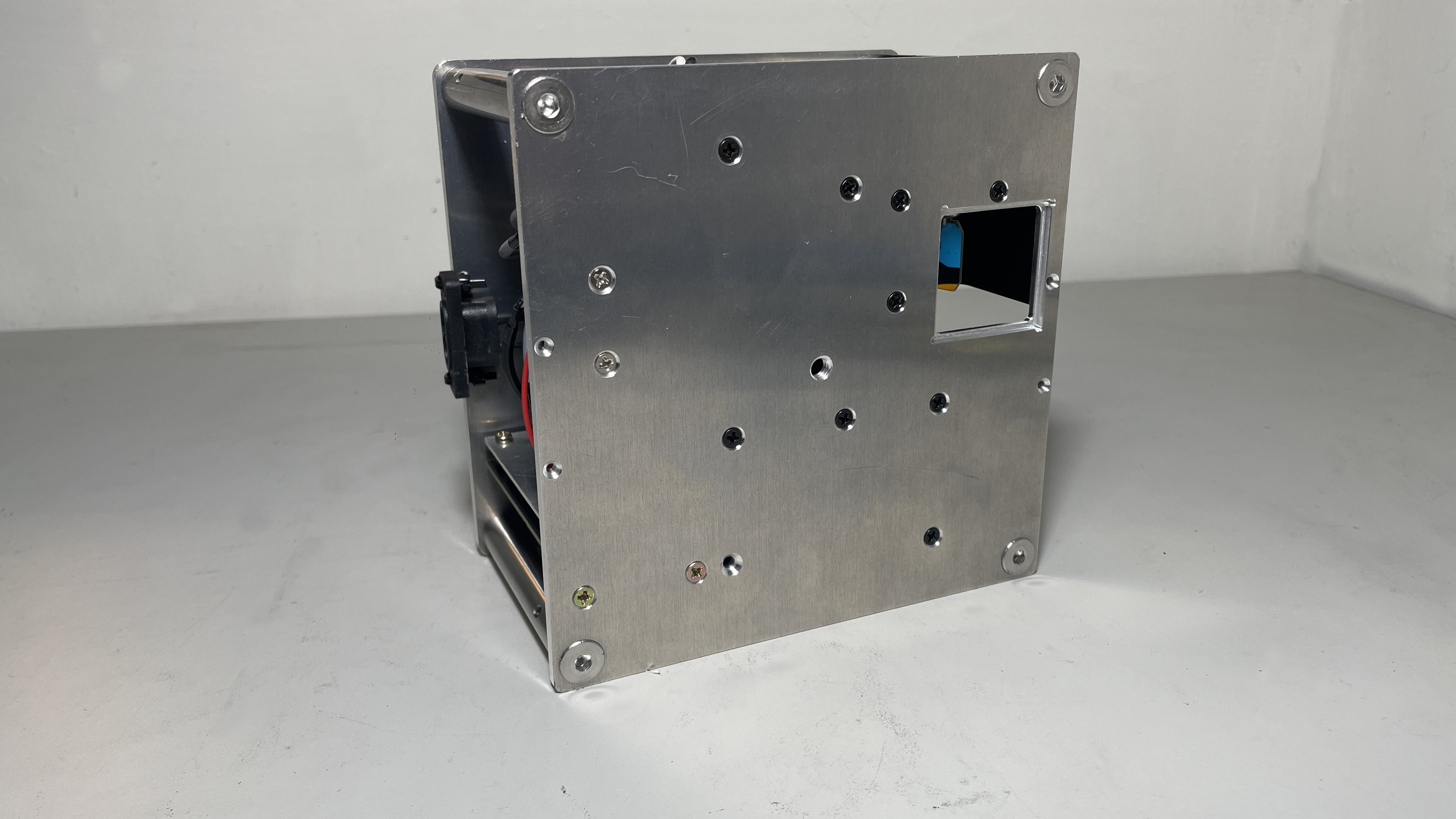

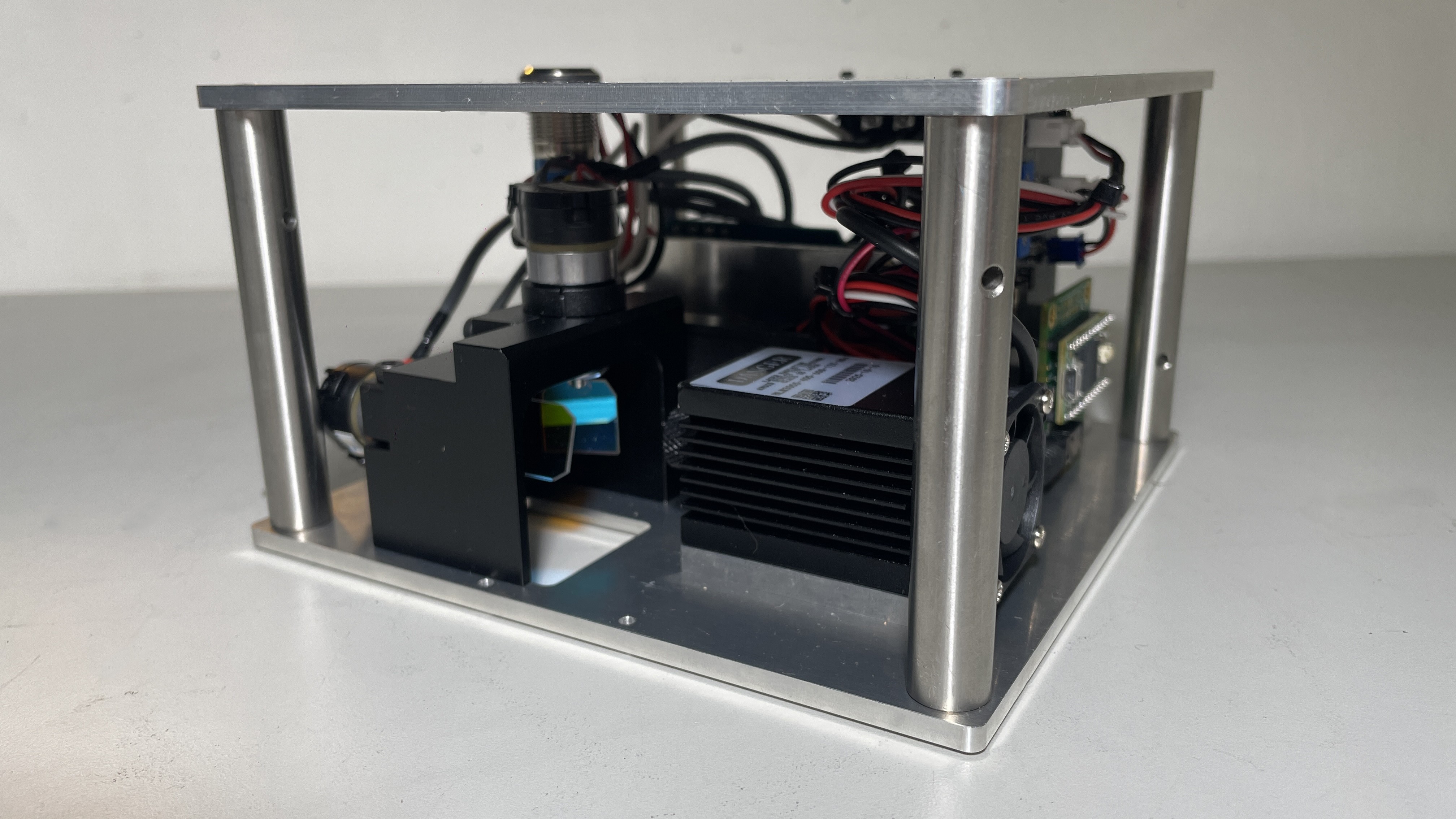

1. Programmable Galvanometer laser scanner
The galvanometers module PT-A40 using in this project can be purchased from GT-TECH. The laser source is a 405nm, 600 mW module. You can also go for RGB source with two more extra audio signal inputs.

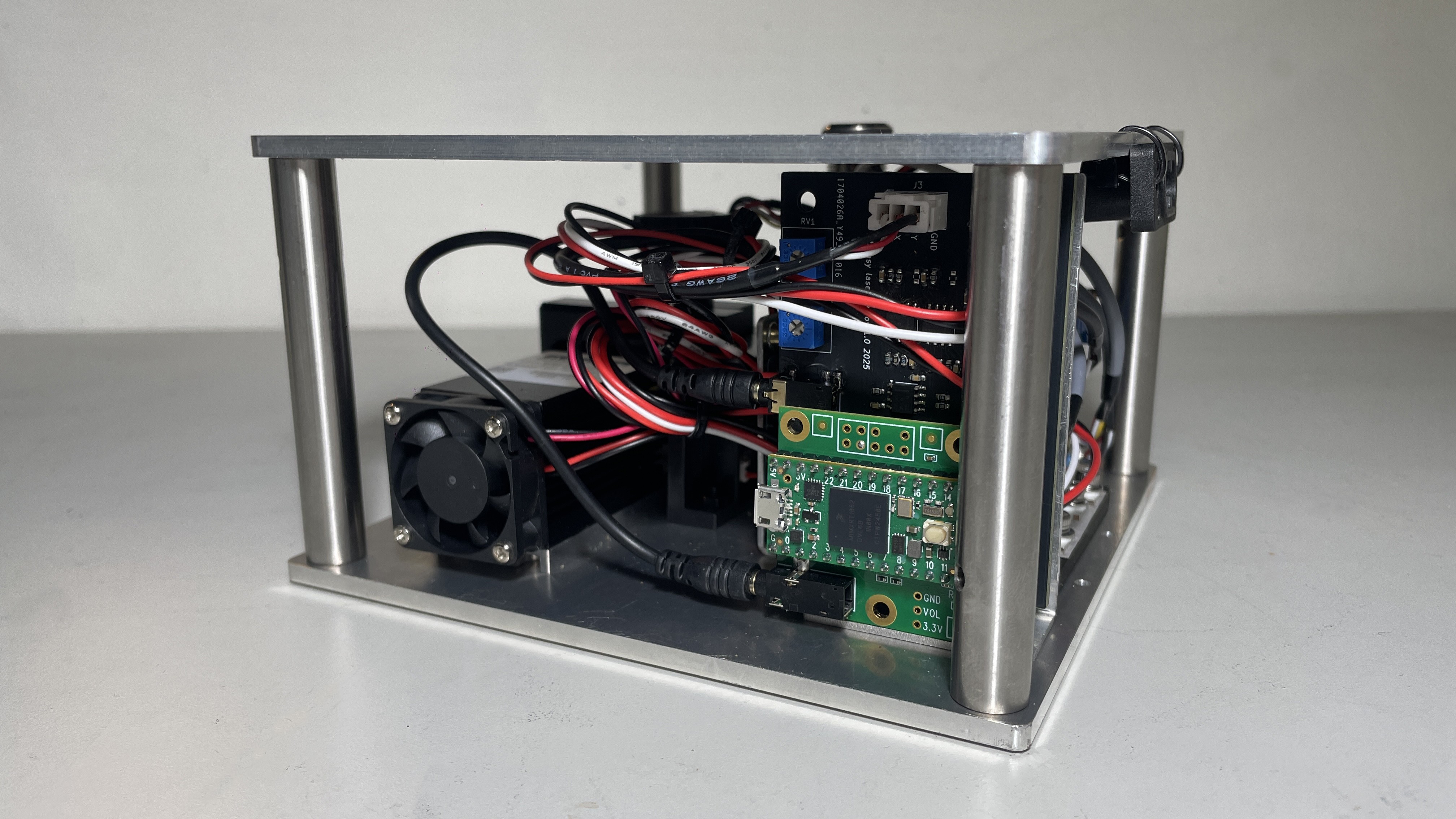

2. The Teensy and the laser signal adaptor board
However, due to the price of the MOTU device is around 800$, I have tried many options to replace MOTU, like daisy board, axolotl and Teensy, but all of these only have acess to the x and y control. Eventually I use Teensy + Teensy audio adaptor board as my final solution. The Kicad file of the adaptor board can be found in the Github.
