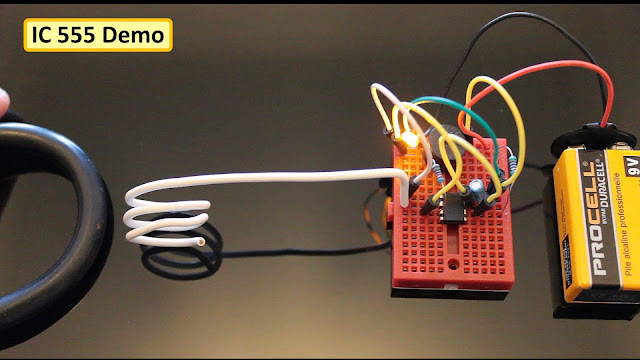

Step 3: Setup Using IC 555
In the 2nd setup I am using the 555 timer IC.
555 timer is the most common chip used in DIY electronics projects because it’s small, inexpensive, and very useful. This circuit is very simple. When the voltage on Pin-2 falls below 1⁄3 of VCC the Output on Pin-3 goes HIGH and the LED lights up. As long as this pin continues to be kept at a low voltage, the OUT pin will remain HIGH. So, when the antenna detects an alternating input the output goes HIGH and LOW and the LED flashes accordingly.
For this setup we need:
- IC 555
- 4.7 μF Capacitor
- LED
- 220Ω and 10K Resistor
- Buzzer
- and a Homemade Antenna
Connect Pin-1 to ground. Pin-2 to the antenna. Pin-3 to the LED and the buzzer. Pin-6 to the +ve leg of the capacitor and Pin-7 to one end of the 10K resistor. Then Pin-6 or the Threshold pin and Pin-7 or the Discharge pin need to be connected to each other. Pin-8 and the other end of the 10K resistor connects to the +ve rail of the circuit board, and finally connect all the -ve legs to the negative rail of the circuit board.
555 Demo
Alright, now lets do a quick test.
As we bring a live wire close to the antenna the buzzer and the LED starts buzzing and flashing; and, if I put my hand around the antenna it has no effect on the circuit. Which makes this setup more reliable as I am not getting any false reading.

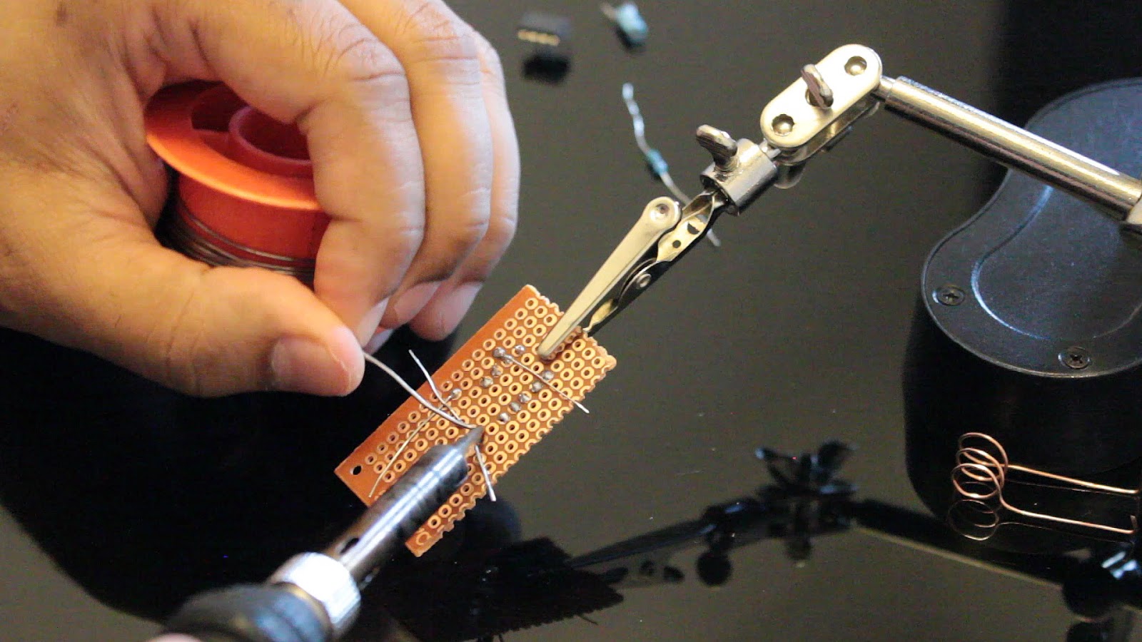

Step 5: Soldering
I don't know about you but I really like the setup using the 555 timer IC. So, without wasting time lets start soldering all the components to the circuit board.
I'll start by soldering the base or the socket of the IC. An IC socket is used as a placeholder for ICs. They are used in order to allow safe removal and insertion of ICs because IC chips may get damaged from heat while soldering. Next, I am soldering the 220Ω Resistor, LED and the Buzzer to Pin-3 of the IC. After that, I am soldering the 10K resistor and the Capacitor to the board.
When considering household electric appliances, your safety is the main goal. If you are facing high bills, flickering lights and damaged appliances at your home, go ahead and make one of these to make sure that the home circuit is in proper working condition.
Next, I am soldering the 9V Battery Snap-on Connector Clip to the plate. Once soldered, I am connecting all the +ve and -ve pins as per the circuit diagram. Once everything is in place its time for me to install the homemade antenna.
