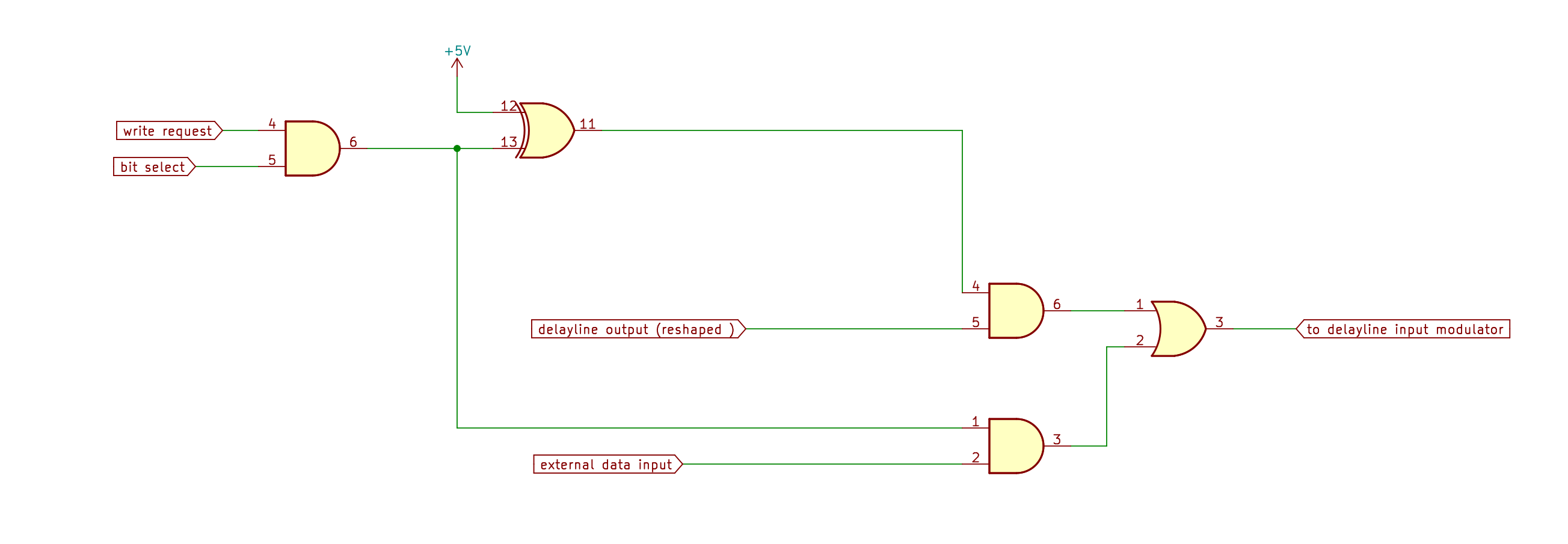

Delayline input selector
In normal operation, the data from the output of the delayline is fed back to the input of the modulation module. When a bit is to be written, the input of the modulation  module must be set to the value that is to be stored exactly the moment when the bit comes back from the delayline. If a device wants to write a bit, it must first set the bit selector to select the bits address and set the value that it wants to write, then set the writerequest line to low  for at least 256 microseconds (or it could wait for a negative edge on bit bitselect when bitselect was low when a write was requested)

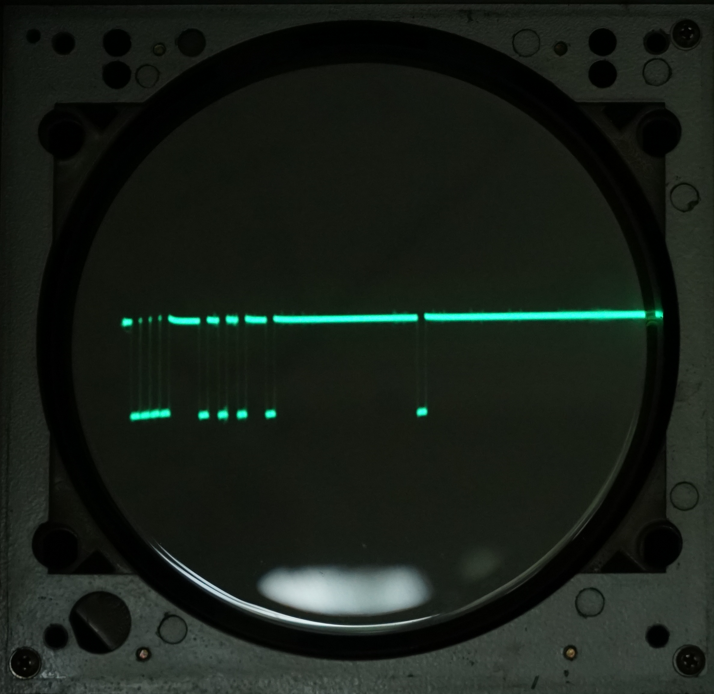

The circuit is highly dependant on the right frequency. The frequency must be chosen so that the delayed signal is exactly in phase with the signal written to the delayline. A bit is 4 pulses of the carrier signal, and there are 256 bits in the delayline. The delayline delays for ca 256.4 microseconds, and the retiming circuit rounds that up to 257. That results in  4 * 256 cycles / 257 microseconds = 3.98443579767 Mhz. I found the circuit to be working stable between 3.982 Mhz and 3.985 Mhz.
WOM
At this moment, the memory can only be written to. You can see the memory content on an oscilloscope, but from the microcontrollers viewpoint, it is a write only memory (WOM) device. To add a read function at some point in the future I could use the second flipflop in the 74hc74 chip that is used to retime the delayline modules output, but for now I am  happy just watching the stored bits on the oscilloscope screen.
Possible improvements
As mentioned in the previous section, a read function could be added relatively easy by using a single flipflop. Instead of only writing (or reading) a single bit at a time, a shift register could be used to process chunks of 8 bit at a time. The number of pulses per bit could maybe be reduced to three or two, and the frequency could be increased to maybe something around 6 Mhz. The bitselector-module could be simplified if the number of bits is restricted to a power of two.
