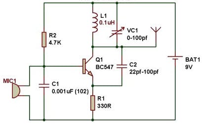

The FM transmitter is a single transistor circuit. In the telecommunication, the frequency modulation (FM) transfers the information by varying the frequency of carrier wave according to the message signal. Generally, the FM transmitter uses VHF radio frequencies of 87.5 to 108.0 MHz to transmit & receive the FM signal. This transmitter accomplishes the most excellent range with less power.
The following circuit diagram shows the FM transmitter circuit and the required electrical and electronic components for this circuit is the power supply of 9V, resistor, capacitor, trimmer capacitor, inductor, mic, transmitter, and antenna. Let us consider the microphone to understand the sound signals and inside the mic there is a presence of capacitive sensor. It produces according to the vibration to the change of air pressure and the AC signal.
In our circuit, the Audio Signal is given by a phone or iPod instead of a microphone. The Pre-Amplification is done using the LM386 Audio Amplifier IC. The 74LS138 along with 22 pf capacitor acts as a Tank circuit which produces a strong carrier frequency and modulate it with our amplified audio signal like the 0.1 uH inductor. We do not have a RF-Amplifier in our circuit, but it can be added if you need to achieve a higher range.

I think you have accidentally "combined" two ICs in your component list, the 13 and the 138. And your schematic shows the 138 but it's labelled as a 13. Also I don't see how you could generate output from the input pins of the 138. I think the design intended to use the 13 all along which is why the pinouts are wrong.
To be clear, the 13 is a dual 4 Schmitt input NAND gate, the 138 is a 3 to 8 decoder.
So change all 138 to 13 and fix the schematic which probably loaded the 138's symbol.
