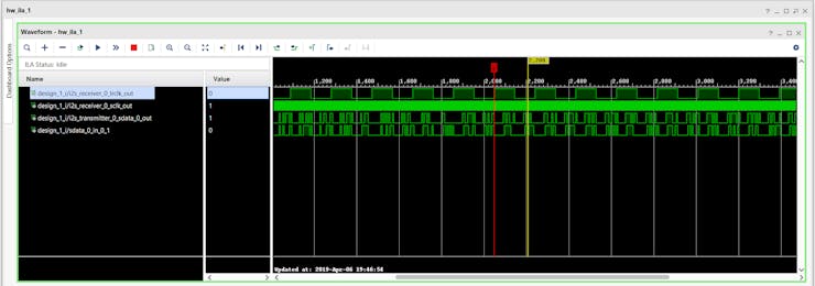

When the developed software application was run on the Snickerdoodle with an audio source connected. I could observe the I2S data being received from and transmitted to the CODEC.
Plugging in earphones I could also hear the same music track being played by the audio source. To demonstrate the audio feed was routed through the Zynq disabling the I2C receiver while debugging would stop the audio output while re enabling it would resume the audio output.
I2S Interface between the Zynq and CODEC

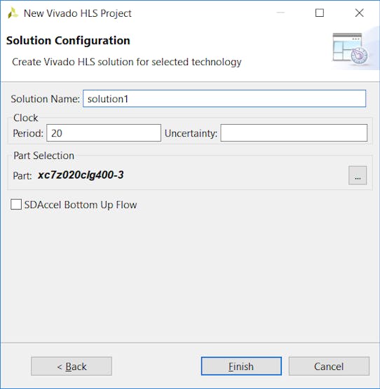

Within Vivado HLS we need to create a new project targeting the same device which is fitted to the Snickerdoodle.
For this application the clock frequency of the AXI Stream between the I2S RX and TX is 50MHz.

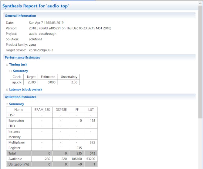

With the simple code written the next stage it to perform C Synthesis. If we had written a complex filter we may want to create a C Test bench first to demonstrate the correct behavior.
Results of C Synthesis
The final step in Vivado HLS is to package the IP core and export it for use in Vivado.

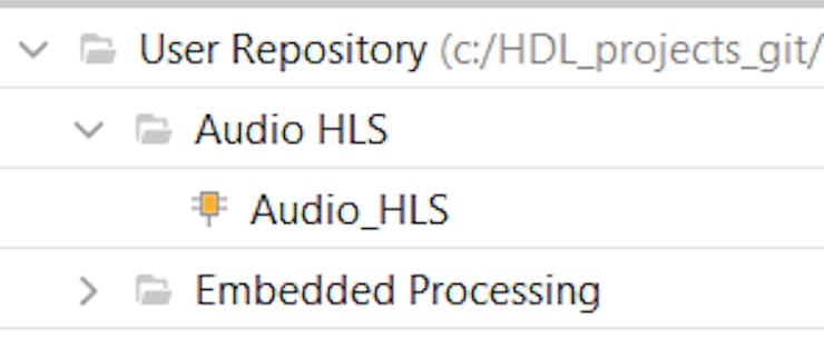

Within Vivado open the IP Catalog select the user repository and right click, to bring up a menu. From this menu select the Add IP to Repository and select the zip file which was created by Vivado HLS
This compressed file will be available under
<hls project name>\solution1\impl\ip
Adding the HLS IP to Vivado
Once this has been imported you will see the Audio_HLS block available within the user repository
Audio HLS Block available

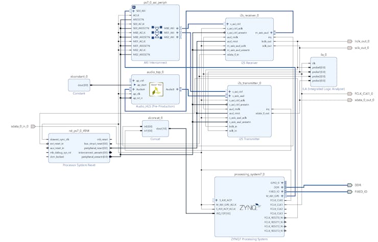

We can now add IP core in to the Vivado design between the I2S Rx and I2S Tx on the AXI Stream.
Updated Vivado Design with the HLS Block included
To ensure the HLS block runs repeatedly I connected the ap_start input on the HLS block.
When I put this all together the the video below shows the system working as it should.
