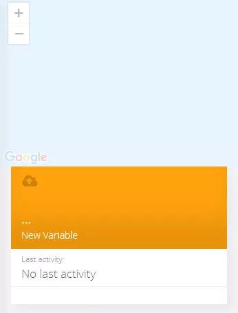

- Add a new device to your ubidot dashboard name ESP32.
Click on devices and select devices in ubidot.
Now you should see the published data in your Ubidots account, inside the device called "ESP32".
- Inside device create new variable name sensor in which your temperature reading will be shown.
Now you are able to view the Temperature and other sensors data which was previously viewed in serial monitor .This happened because the value of different sensor readings is passed as a string and store in variable and publish to variable inside device esp32.

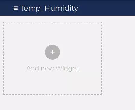

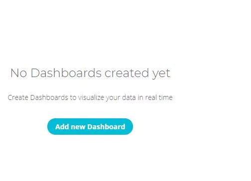

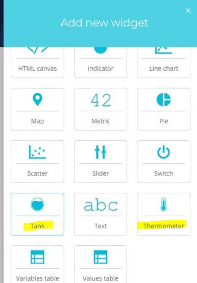

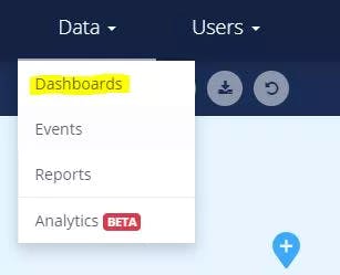

Create Dashboard in Ubidots

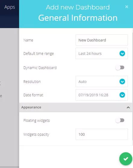

- Click on add new dashboard.
- Name your dashboard.

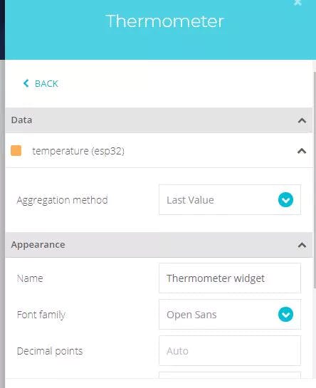

- Now select Widget.
- Now select all required option and your widget will create.On which you can view your temp and humidity data.

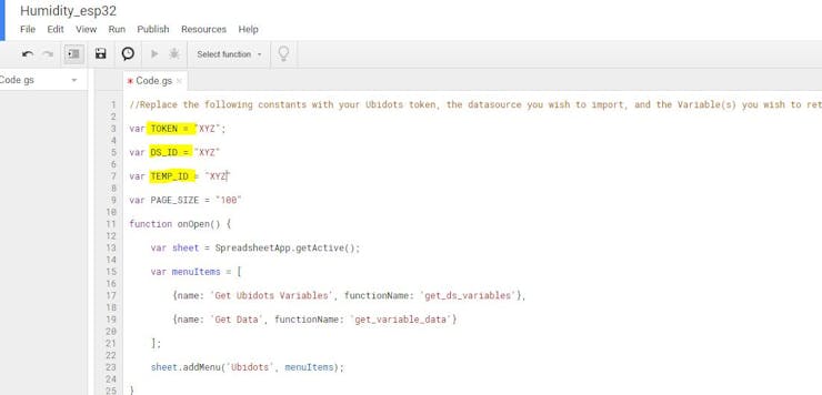

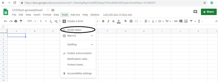

- Create a Google Sheet and add two sheets to it with these names:
- Variables
- Values
- From your Google Sheet, click on "Tools" then "Script Editor...", then "Blank Project":
- Open the Script Editor:
- Add the code below (in the code section) to the script Script.
- Also add the Token Id, device Id taken from your Ubidots account to the following code.

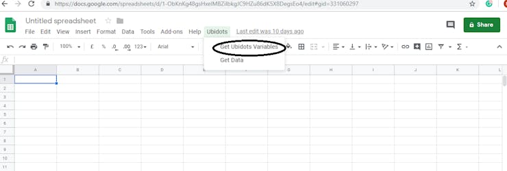

- Done! now open your Google Sheet again and you'll see a new menu to trigger the functions.
