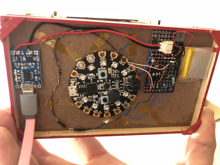

I am planning to add LEDs I bought fairy lights on a local store but I need to make the wiring shorter because I want them to be behind the banner this is sort of how it will look:
And using circuit playground express to add some music/sound effects. I have smaller boards available but this one already has a speaker and libraries are available to play wav files. And it fits perfectly on bottom.

I cut the fairy lights to make 4 LEDs fit behind de ramen banner. I will have a different circuit controlling the paper lamp.

I used a piece of stripboard to place a P-CH transistor and control the banner lights with CPX, I wanted to have an independent circuit for the lamp, so I just connected to a different pin in CPX and added a 220Ohm resistor, a rechargeable battery and the TP4056 charging module.
Testing the circuit
Not the greatest assembly, but also used screws and bolts to attach the CPX.
Added a piece of fabric to cover...
