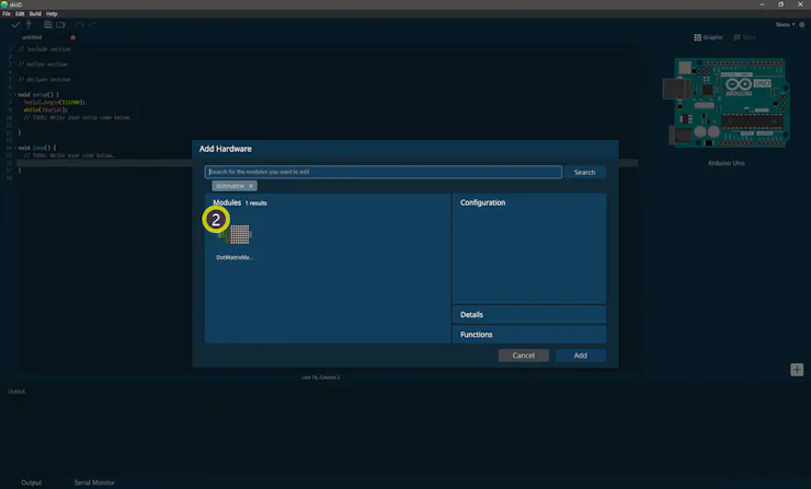

    #1 Click '+' (Add Component Button) to search and select the component.
    Search DotMatrix
    #2 ① Type'Dot matrix' on the search bar or find Dot matrix module on the list.
    Search Result
    #3 ②Select Dot matrix

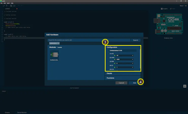

    Pin Indication and Configuration
    #4 then you can see ③ pin indication. (You can configure it.)
    *This module has 5 Pin to connect
    skiiiD Editor automatically indicate pin setting *configuration available
    [Default Pin Indication for Max7219 Dot Matrix Module] in case of Arduino UNO
    VCC: 5V
    GND: GND
    DIN: 0
    CS: 1
    CLK: 2

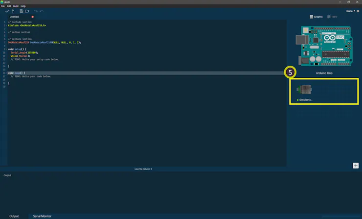

    #5 After configuring pins ④ click ADD buttonon the right below side
    skiiiD Code Editor
    #6 ⑤Added Module has appeared on right panel
