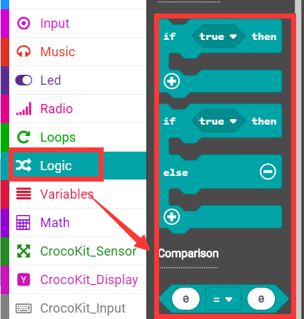

4. Search for blocks
5. Combine blocks
image.pngimage.png4. Search for blocks
5. Combine blocks
image.pngimage.pngimage.pngimage.png5. Combine blocks
image.pngThe code of the experiment:  33.Color sorter.rar
