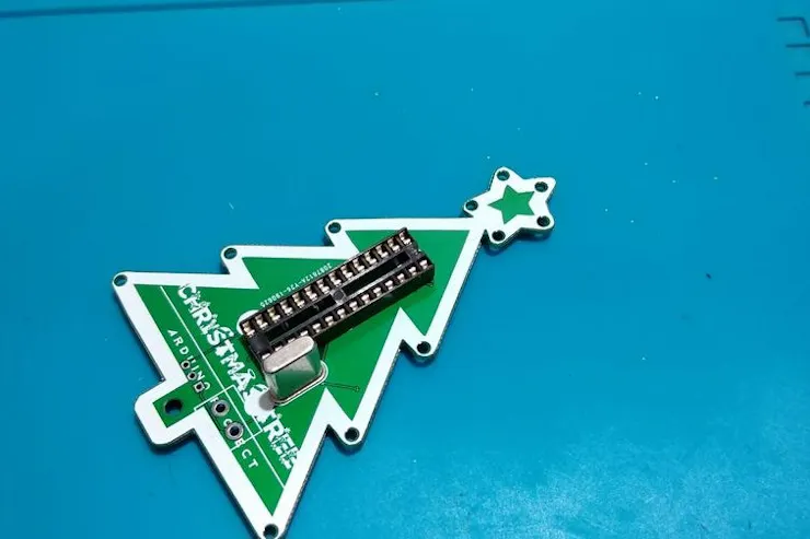

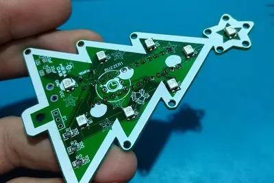

After making the circuit design I transformed the circuit into a customized PCB design with a tree shape in order to get a beautiful PCB design when we order our circuit and to do so all what I need is to move toJLCPCBthe best PCB supplier in order to get the best PCB manufacturing service, as always just some simple clicks that’s all what you need to uploaded the appropriate GERBER files of the circuit design then I moved to set some parameters and this time we will use the green color for this PCB since we are producing a tree so it should be green anyway; just four days after placing the order and my PCBs are on my desktop.
Related download files
As you can see in the pictures above the PCB is very well manufactured and I’ve got the same PCB design that we’ve made for our main board and all the labels,logos are there to guide me during the soldering steps. You can alsodownload the Gerberfile for this circuit.

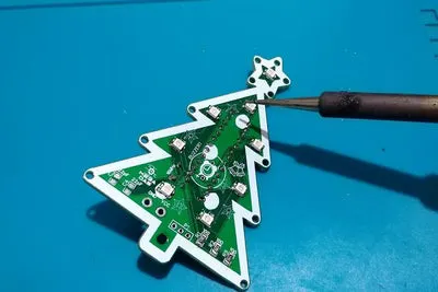

ow everything is ready so let’s start soldering our electronic components to the PCB and to do so we need a soldering iron and a solder core wire and a SMD rework station for SMD components.
Safety first
Soldering Iron Never touch the element of the soldering iron....400°C! Hold wires to be heated with tweezers or clamps. Always return the soldering iron to its stand when not in use. Never put it down on the workbench. Turn unit off and unplug when not in use. As you can see, using this PCB is so easy due to its very high quality making and without forgetting the labels that will guide you guys while soldering each component because you will find on the top silk layer a label of each component indicating its placement on the board and this way you will be 100% sure that you will not make any soldering mistakes.I’ve soldered each component to its placement and you can use both sides of the PCB to solder your electronic components.

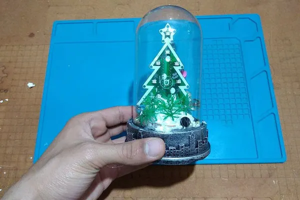

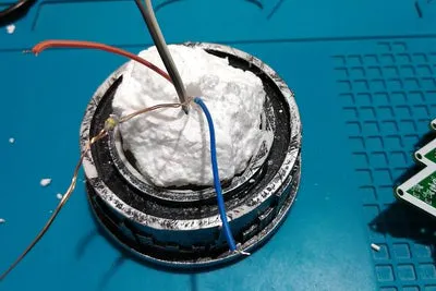

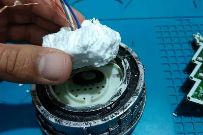

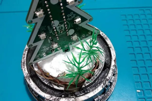

Now we have the PCB ready and all the components soldered very well so it’s time to move to the software part I have made an arduino code that you can download for free from the link below nowall what we need now is to place the MCU in an Arduino UNO board and we upload the code to the microcontroller then we take it back to its socket on our PCB after that we put the circuit board inside the glass holder and we glue it.

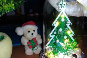

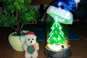

After placing the batteries we turn on the device and we enjoy the sound and the view.
This project is so easy to make and an amazing one and we recommend it for you if you want to celebrate the Christmas your own way. But still some other improvements to perform in our project in order to make it much more butter, that’s why I will be waiting for your comments to improve it,
