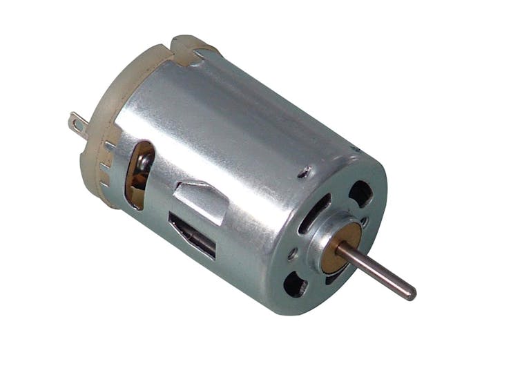

The most common type of motors you might have come across is the 3 V DC motors which are optimized to work with low voltages. These motors are hobbyists friendly and low cost.
Running them is quite simple. Just connect them with two 1.5 V AA batteries and they will fire up. This setup is good for simple works like making a fan or a miniature windmill. But when it comes to the dynamic applications of them such as robots, more precision is required - in the form of variable speed and torque.

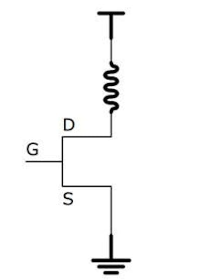

The solution to this problem is the method of PWM or pulse with modulation. Here, the motor is driven by a square wave with an adjustable duty cycle (ratio of the on-time to the period of the signal). The total power delivered is proportional to the duty cycle. In other cycles, the motor is powered for a small fraction of the time period – so over time, the average power to the motor is low. With a 0% duty cycle, the motor is off (no current flowing); with a duty cycle of 50% the motor runs at half power (half the current draw) and 100% represents full power at the maximum current draw.
This is implemented by connecting the motor high side and driving it with an N-channel MOSFET, which is driven again by a PWM signal.
This has some interesting implications – a 3 V motor can be driven using a 12V supply using a low duty cycle since the motor sees only the average voltage. With careful design, this eliminates the need for a separate motor power supply.

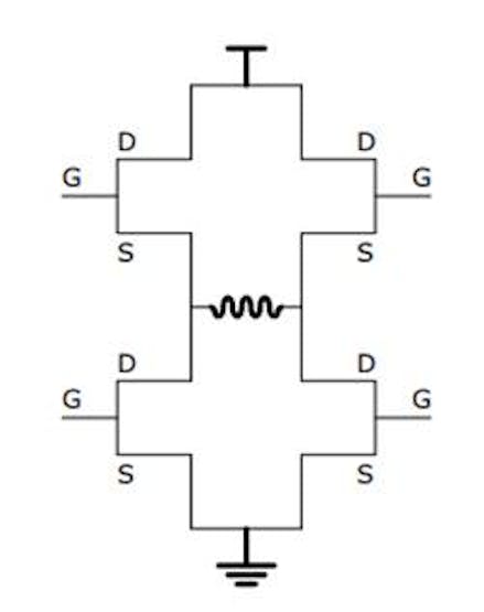

The H-Bridge Motor Driver Circuit
This circuit is called H-bridge because the MOSFETs form the two vertical strokes and the motor forms the horizontal stroke of the alphabet ‘H’. It is a simple and elegant solution to all motor driving problems. The direction can be changed easily and the speed can be controlled.

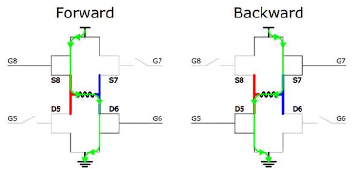

In an H-bridge configuration, only the diagonally opposite pairs of MOSFETs are activated to control the direction, as shown in the below figure:
When activating one pair of (diagonally opposite) MOSFETs, the motor sees current flow in one direction and when the other pair is activated, the current through the motor reverses direction.
The MOSFETs can be left on for full power or PWM-ed for power regulation or turned off to let the motor stop. Activating both the bottom and top MOSFETs (but never together) brakes the motor.
