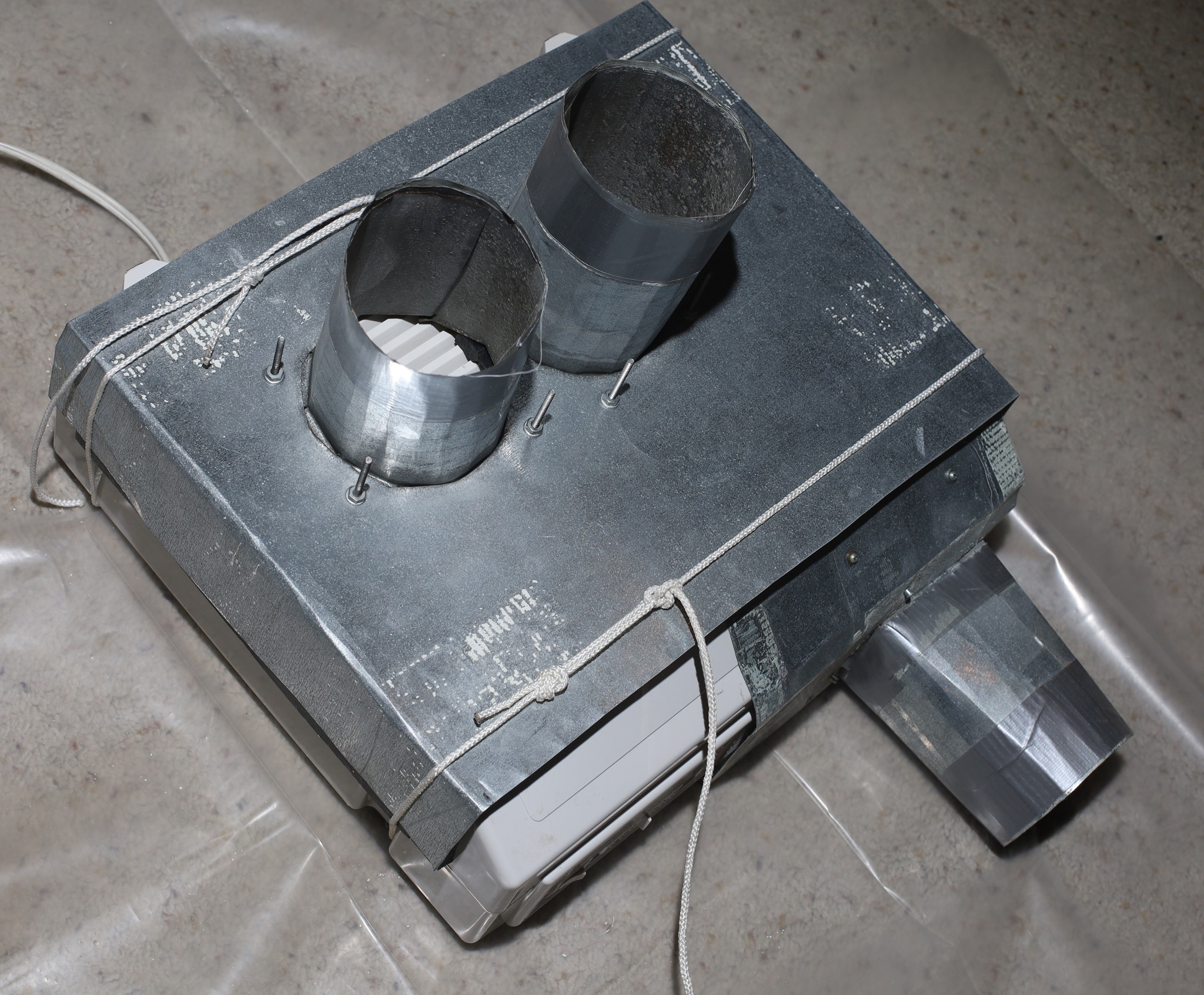

In 2003, the $35 Hunter 30055 arrived.  With an air duct made from drying machine parts hacked on, it could blow air in any direction & the filter was easy to substitute with any HVAC filter after cutting it to the right size.  It was powerful enough to quickly replace all the air in the apartment.  It's no longer made & today's Hunters no longer have a hackable filter.
It was used without the filter for many years, before realizing the filter greatly reduced the dust in the apartment & the amount of cleaning of the blower.  After resuming filter usage, the lion kingdom made sure to run it as often as possible, to keep dust out of the apartment as well as for ventilation.
The filters have no effect on cigarette odor, but turn black so they do take out ashes.

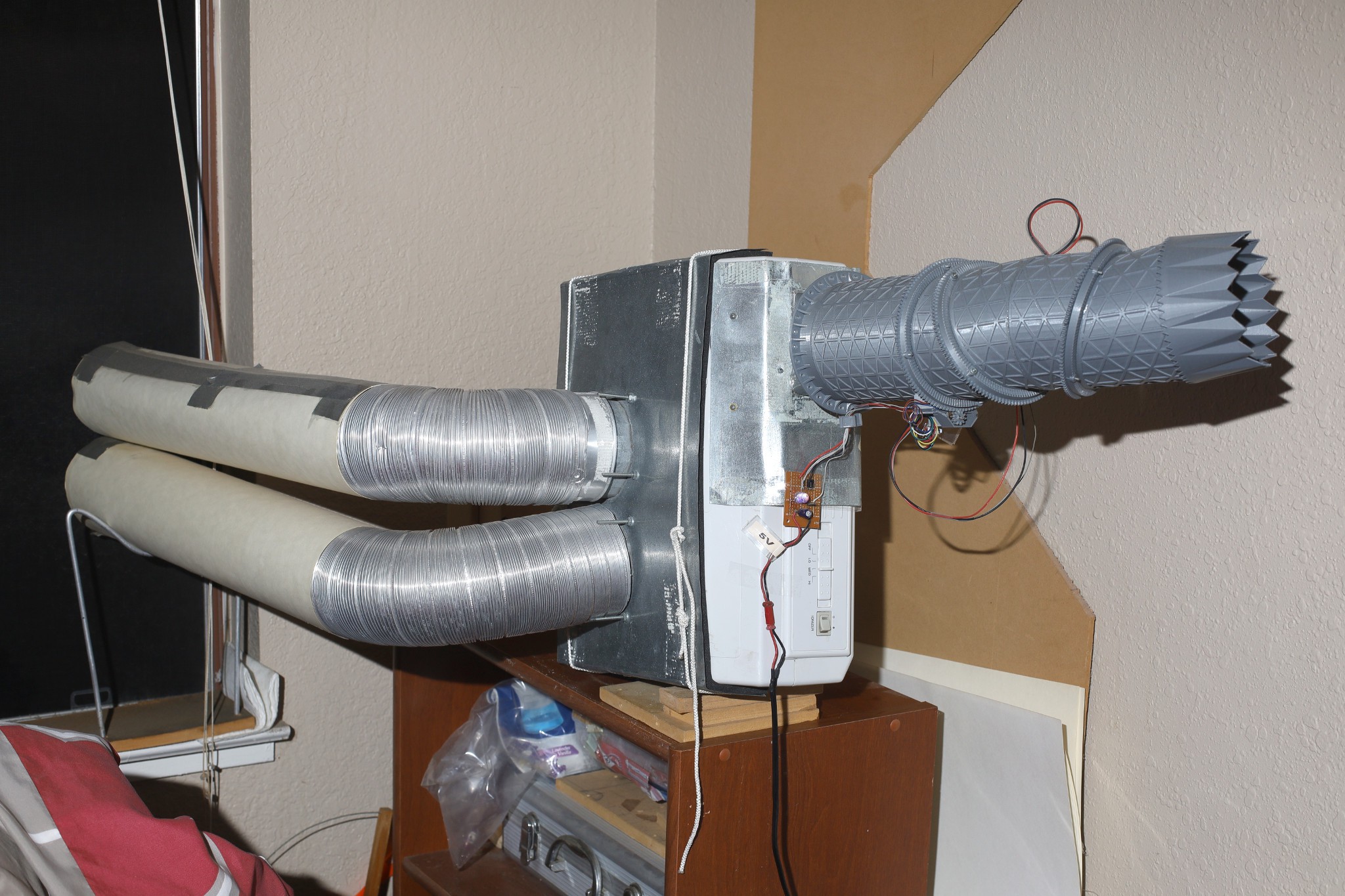

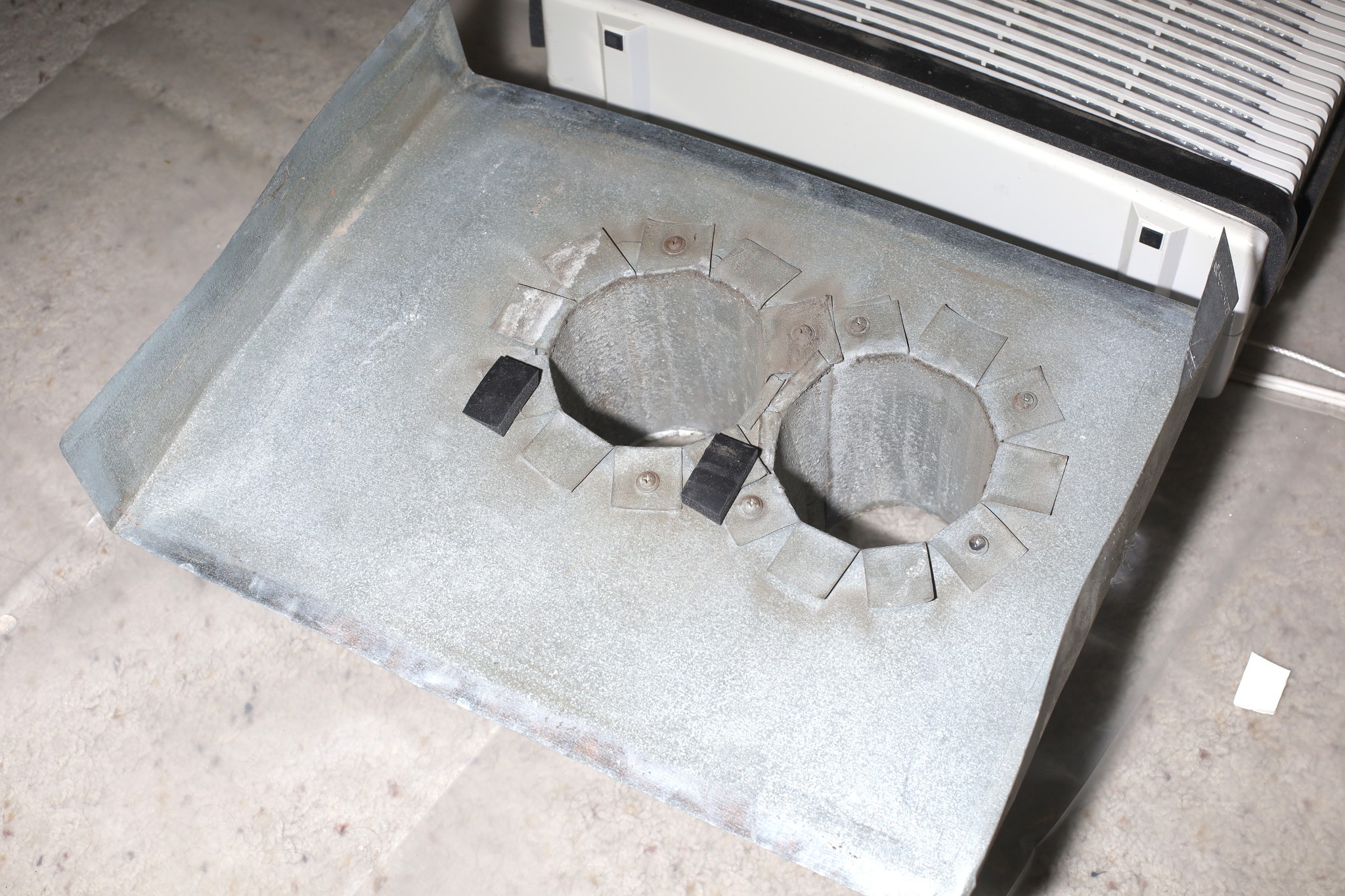

In 2006, the decision was made to try to add air ducts from the Hunter to vents in different parts of the room.  While fluid dynamics said the pressure from the blower should be at the beginning of a long tube, experience showed the friction inside the long tubes & leaks absorbed all the air movement.  The blower was placed at the end of all the ducting originally intended to direct the output & the small vent was returned.
When it was new.
4 years later.
The air ducting could store fragrance, but it manely collected spiders.
This served for 8 years & provided the ideal airflow, a directly vertical blast when sleeping & a horizontal blast into any part of the room during heatwaves.  The lion kingdom can't remember ever having trouble sleeping with that airflow.  The problem was all that ducting collected dirt, it took a lot of space, & it required drilling a lot of holes into the walls.
The last iteration is simply resting on a shelf for other things to be stored in.  The intake ducts are just posterboards rolled into tubes.  The airflow is manely horizontal when sleeping, making it less than ideal.  It still manages to replace the air in the apartment, but can't directly blow everywhere.

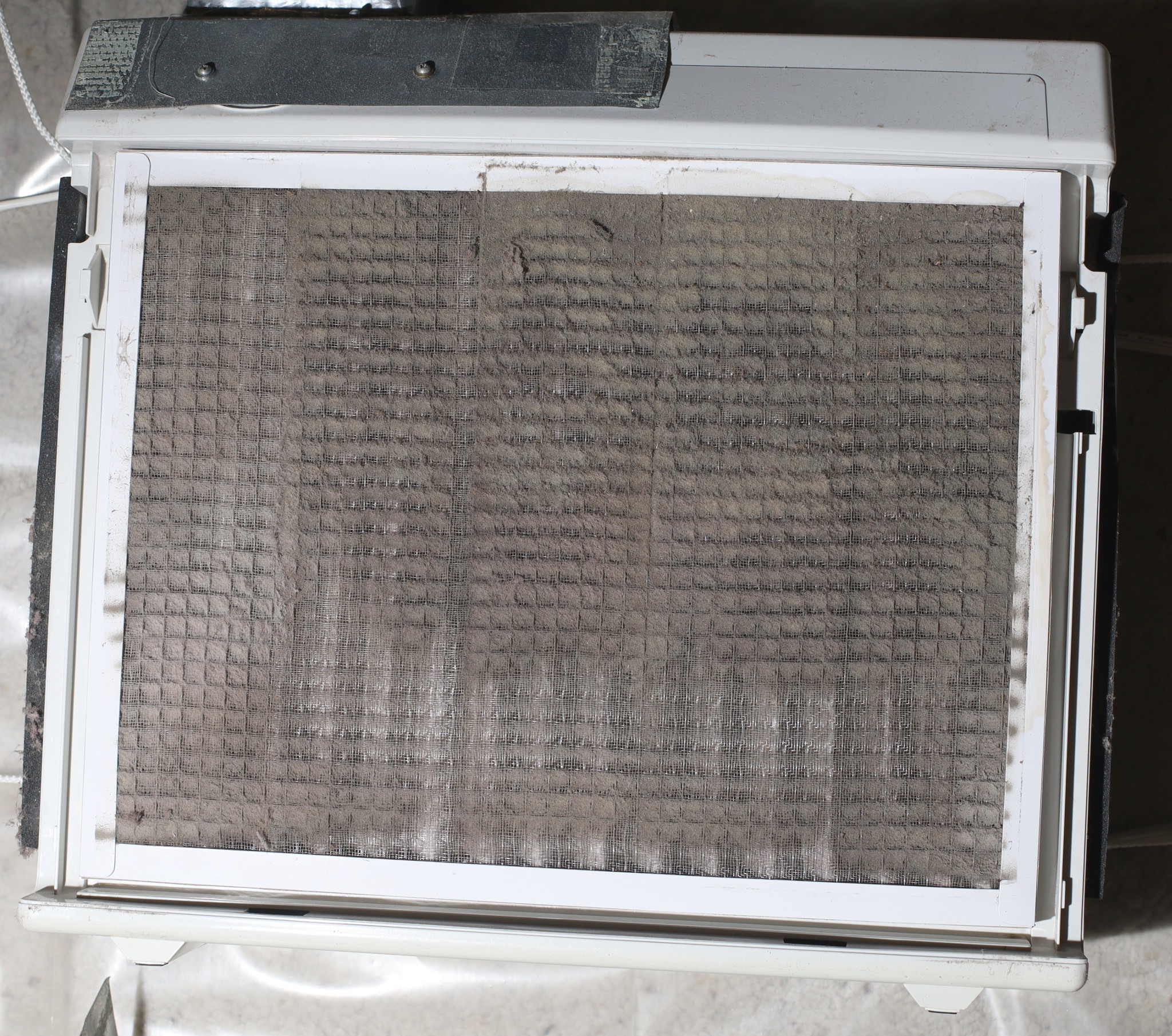

    Another 14 month gap between filter changes & once again a light vacuuming instead of a complete rebuild. The dust is definitely building up on the inlets since those require a rebuild.
    Added more foam bits to space the inlet. The light vacuuming process takes 1 hour, compared to many hours for a complete rebuild.
    The filter change made a meaningful difference in air flow, this year.
    Weather stripping installed in 2025 concentrated more of the airflow in the inlets.  Those had a lot more dust than 2025.

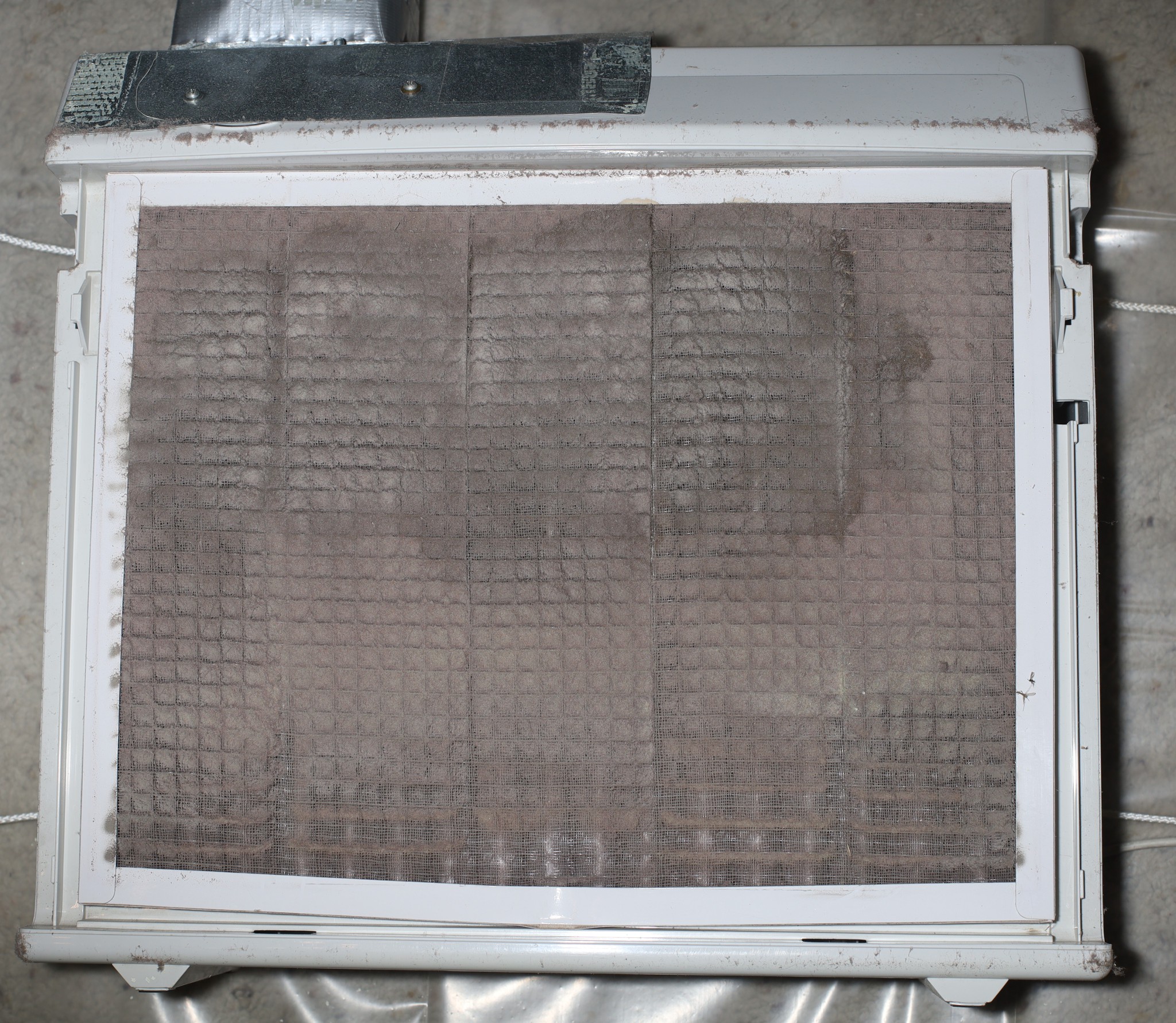

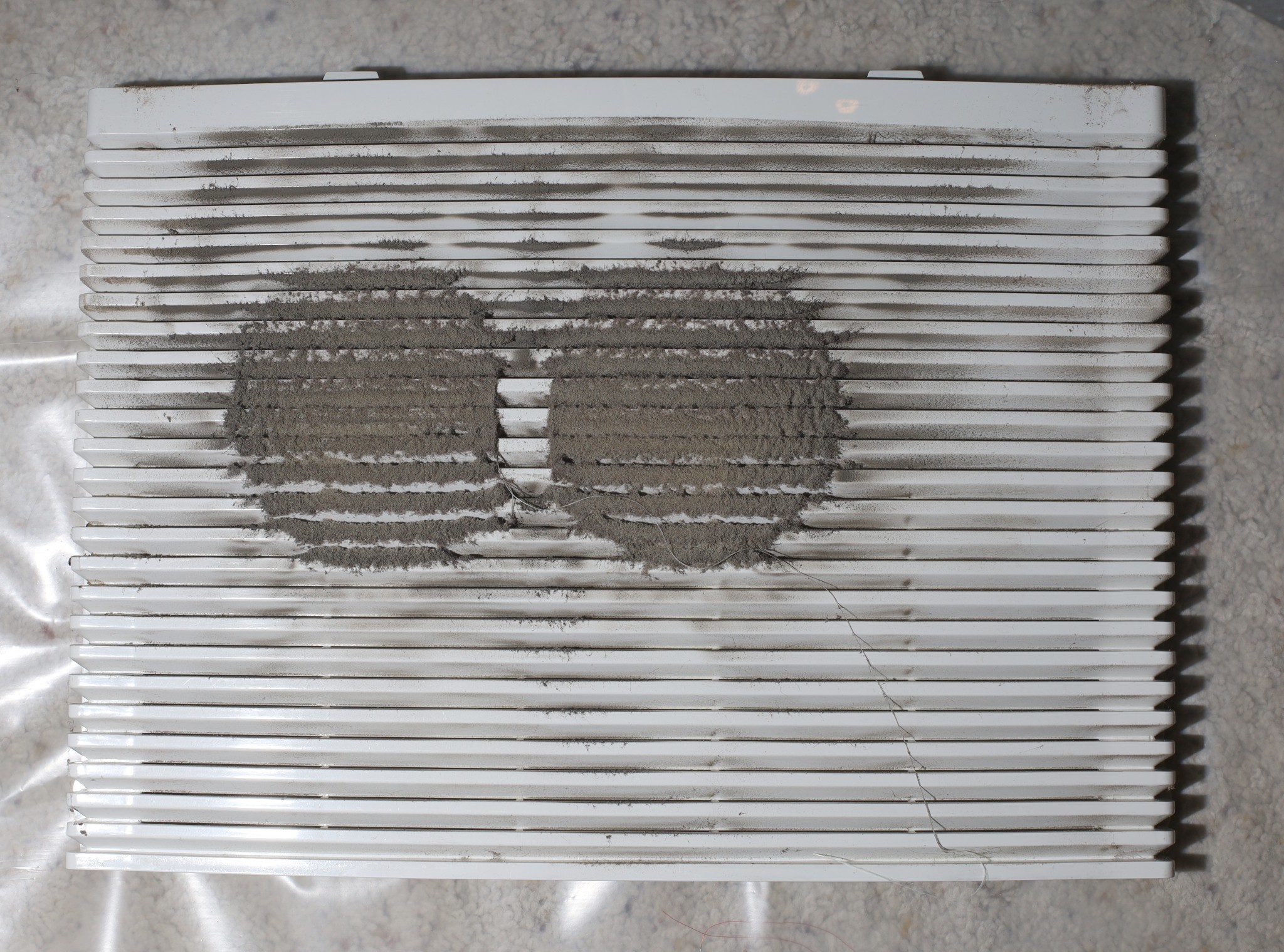

    Almost 14 months into the new blower's life, the 1st heat wave of the year brought the need to change filters & reinstall the inlets.  As expected, most of the air was going in just 2 small holes.
    Amazingly, no spiders this time, but pretty caked after 14 months.
    Vacuumed the dust but did not rebuild this one.  The manufacturer's gas seal seemed good enough.  Too bad younger lion assumed hunter blowers would always be made & threw away the manufacturer parts.
    Installed foam to try to more evenly distribute the intake.  Availability of this foam has proven very unreliable, hence many attempts to go without it.
    Installed small foam bits to try to space the intake.
    The next step is really a better stand.  It might be wise to buy another batch of filters, since supplies are becoming very unreliable & lions aren't going to be in this apartment in 10 years.

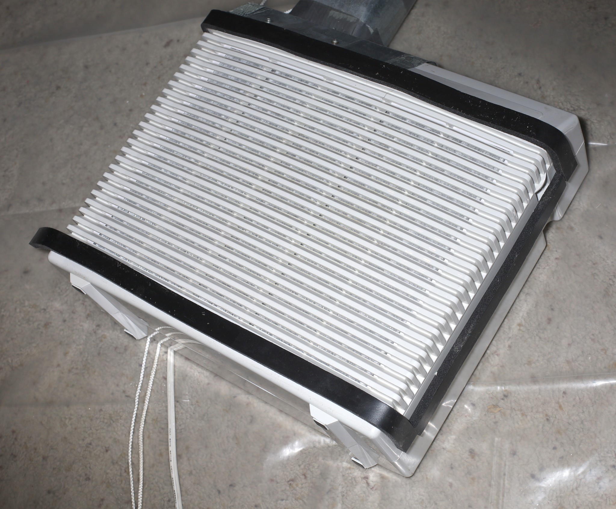

    Decided to give the stock filter assembly a try.  Young lion destroyed the previous one to stack 2 filters & make it easier to clean.  They were being made in the zillions, in those days.  It'll probably have to be ground flat & the painstaking packing tape used again.

    Filter after 3 months.
