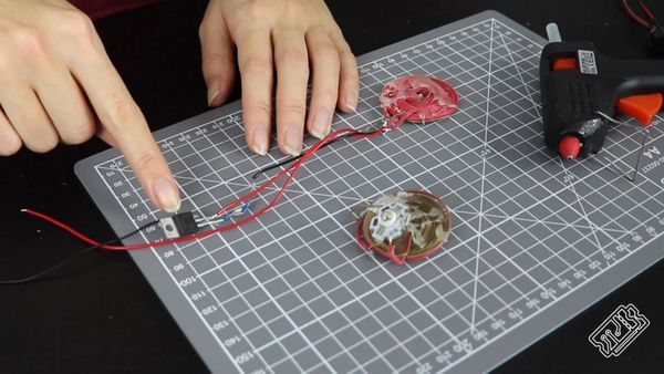

We started by tackling the wirelessly powered LED, which is something I’m pretty sure my GCSE physics teacher would love.

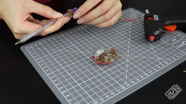

We made two wire coils, one with 18 turns and the other with 21 turns by wrapping wires around a pen and then glue gunning in place so they hold their shape.
Then, we connected the 18 turn coil to the mosfet and resistors as shown in the diagram.
Next, we connected the other coil to the LED, as shown in the other diagram.
When you put one coil near the other and turn on the power supply, the LED is powered.

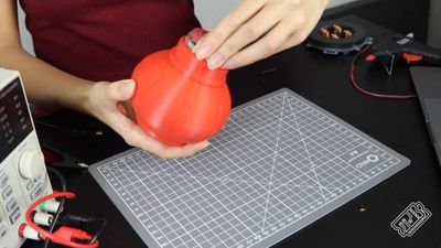

Step 2: The Lantern

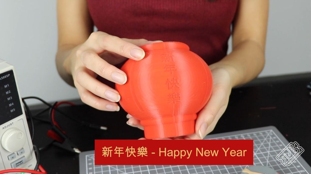

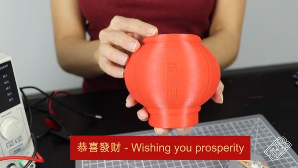

We 3D printed our own Chinese lantern with two phrases embossed into it:
- 恭喜發財 - Sun leen fai lot (happy new year)
- 恭喜發財 - Gong hai fat choi (Wish you prospertiy)
The embossed letters and lines appear brighter when the lantern has the LED inside.

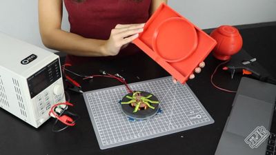

Step 3: Putting Together

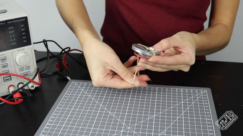

We attached the coil to the magnet using a rubber band and then put it into the bottom of the lantern.
We strongly secured the wireless power transmitter using electrical tape.
We also 3D printed a base piece to cover the magnetic levitation module and transmitter.

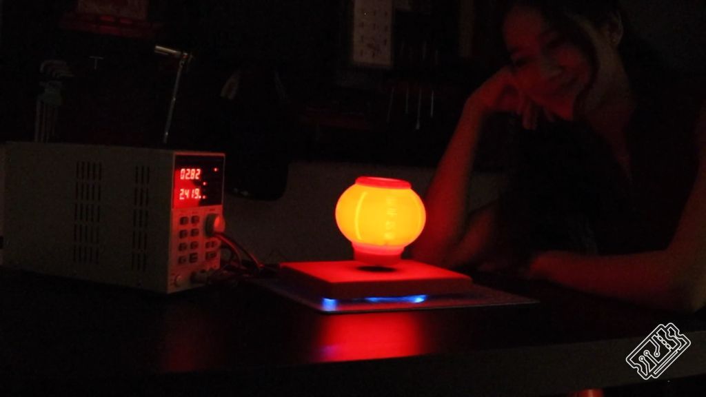

Step 4 Power and Admire:
So now, if we power everything up...you see the beautiful lantern float!
